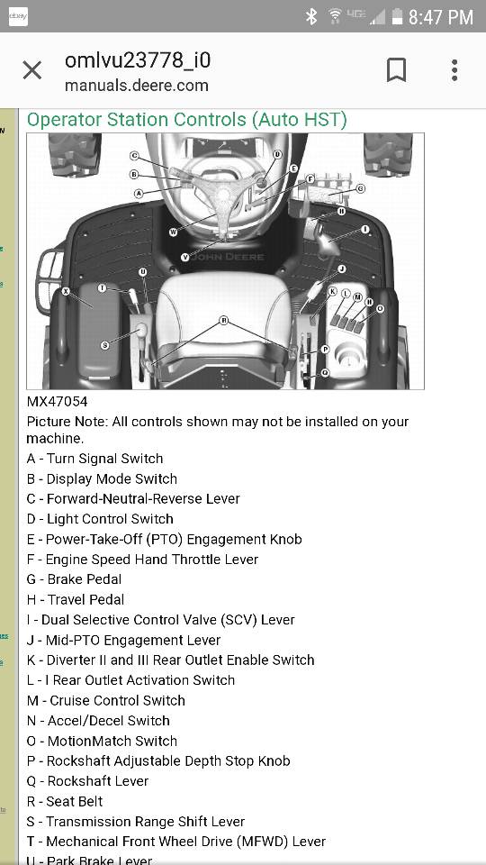

Deere offered that a few years ago on the eHydro compacts in the form of AutoHST. They must not have sold too many, because the only time I've seen it is in old brochures. It was like your kobota loader, FNR on the column and "GO" pedal on the floor. The pedal controlled engine rpm and travel speed, with a separate throttle lever to maintain high rpm and low travel speed. It could have quite likely been the perfect HST control method... but, they put the brake on the same side as the go pedal like the kobotas of the time.

Here is about the only place the AutoHST can be seen. Screenshot_20180513-204717.jpeg

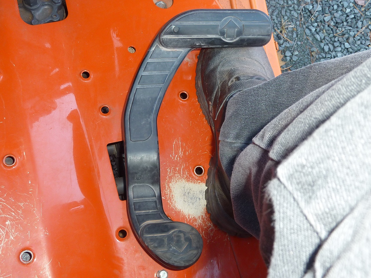

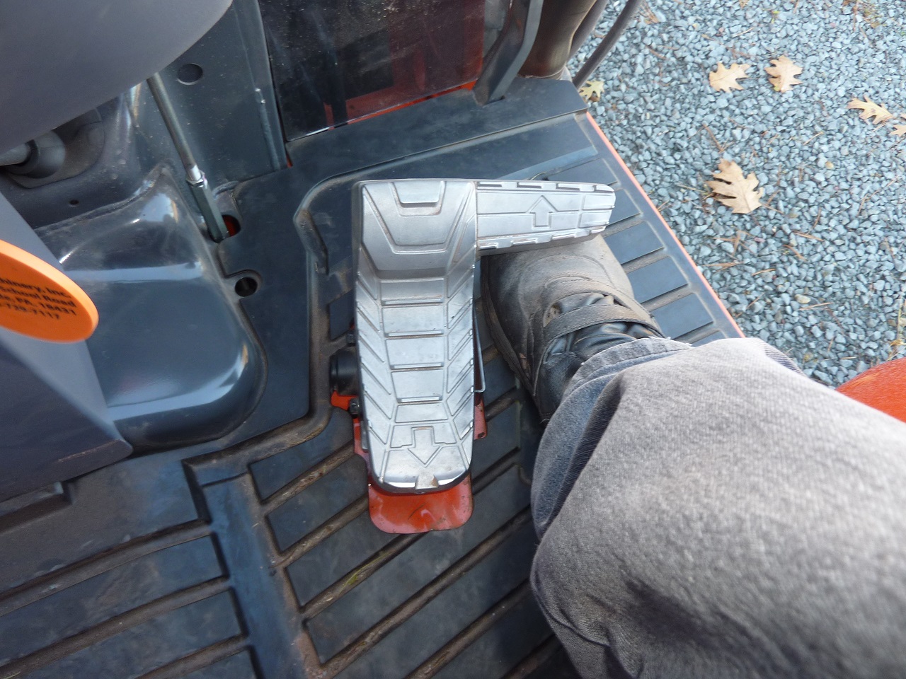

I'm the last guy to ask this question... I HATE MY HST B2320... Don't get me wrong, I love the tractor for what I bought it for, BUT I hate the hst pedal. Lifting my foot and engaging the pedal with my heel is such a foreign action, that I have to think about it constantly. My other tractors are geared, and I love them. All I can say is learn to use it, but you're never going to like it...
I'm not familiar with the HST pedal on the B2320 but on all the HST Kubota's I've owned (5) you don't have to lift your foot to change direction. Just lift the pedal with your toe:
