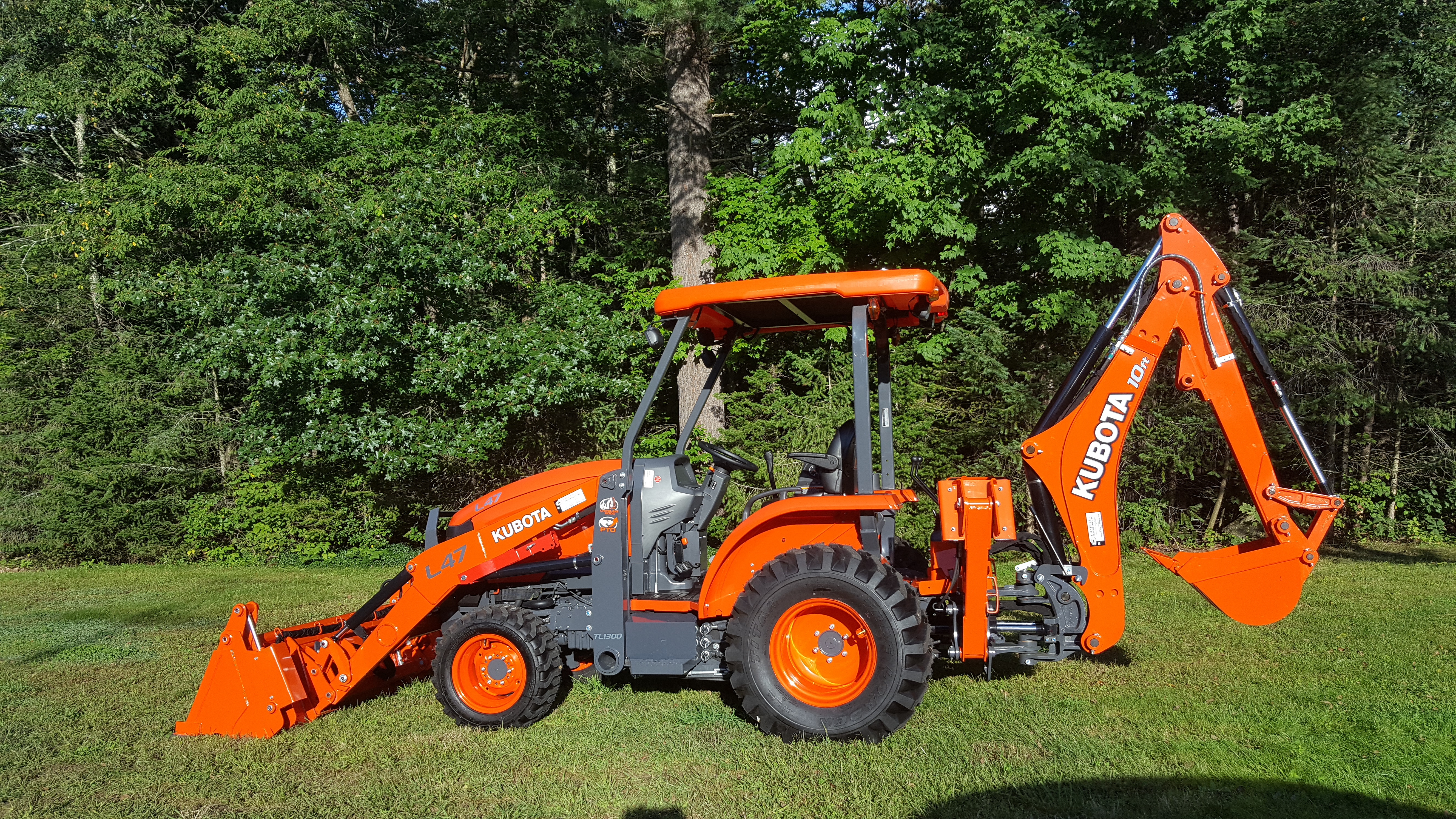

You and Mike really did some nice upgrades on your tlb's . I got the pin on 18'' bucket . I will be picking up the tractor on Saturday.

   / Kubota L47 Price Comparison #65
   / Kubota L47 Price Comparison #66
Congratulations Peter. That is a fine looking machine but as Mike says a little too shiny - now you need to send some action shots!

Waiting for hydraulic thumb back ordered till October. Busy at work no time to play. Hows your tlb running?

Hi Mike
dealer filled tires with rim guard, no chains wont see snow in barn sleeping all winter . Wife wants a snow blower :laughing::laughing:

My L45 is running just fine Peter. I just had the dealer complete the 1,400 hour service and so far I have had no issues with the tractor except for some hose wear in the hoe and under the hoe at the rear of the tractor. Fortunately the dealer caught the two under the hoe with this service and I notice the problem with the lines running up the hoe a couple of years ago and switched out all the hoses.
If your wife wants a snow blower you wouldn't go wrong putting a 78" PTO driven blower on the back of your L47. I have a 9' snow blade for the front which is great for quick cleanup but the blower is still used to pile the snow high in the one area where I place most of mine. Mike's recommendation on the chains is good too but unfortunately I do a few driveways for neighbours and have to go on asphalt so I have to put up with a bit of slipping and sliding.
I have to say that given that I live on fairly rocky ground I am really glad I spent the money for the hydraulic thumb. There are very few days of digging when I don't need it at least a couple of times.
Looking forward to seeing some action shots of your L47.
