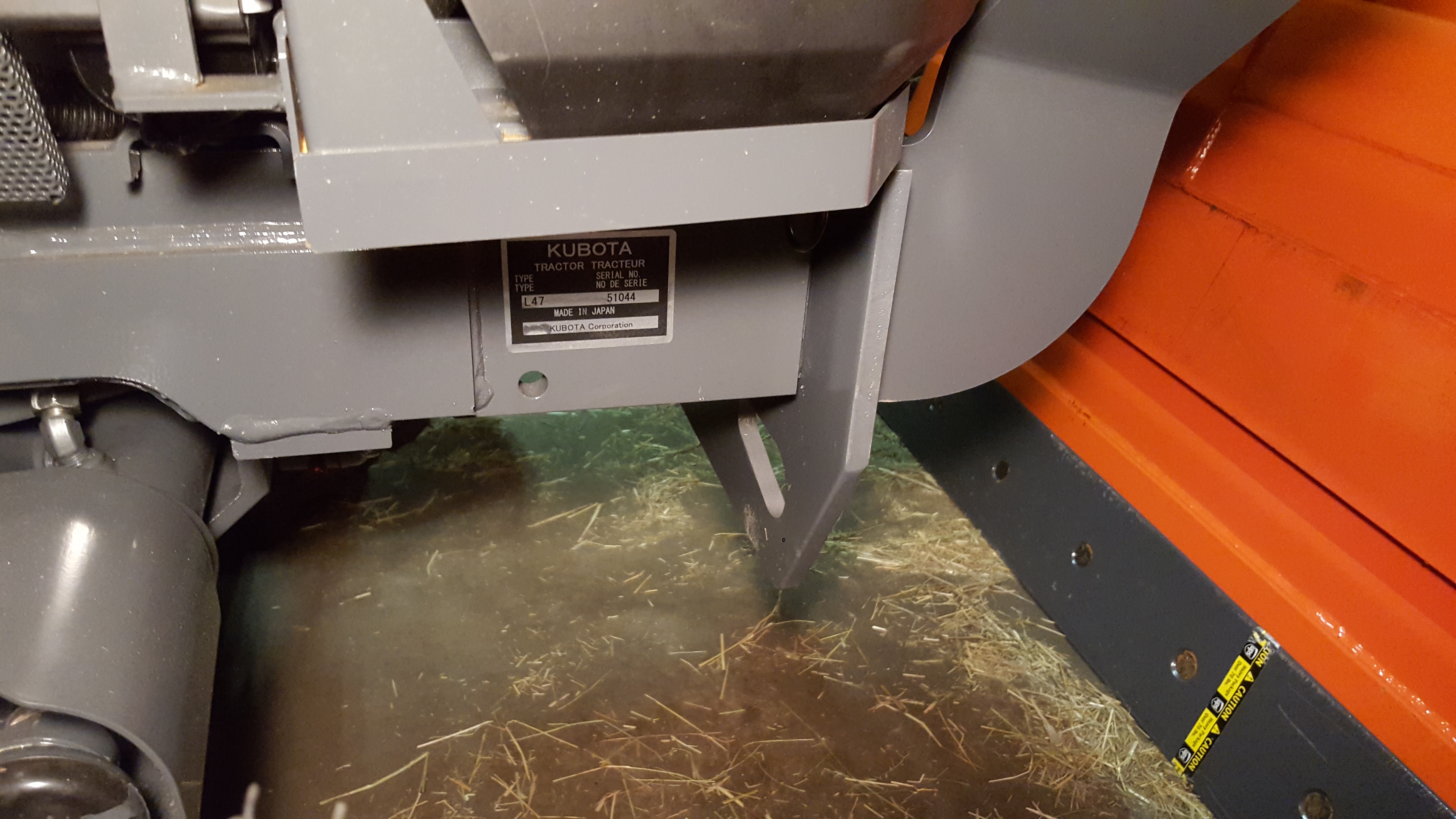

It's a 1/2 '' plate bolted between the bumper and frame
   / Kubota L47 Price Comparison
#83
Were you able to use the same bolts? I'm picking up a piece of scrap plate Monday and going to do the same. Thanks for the idea.
HI Rich, I used longer bolts and put nuts and washers on the back side.
   / Kubota L47 Price Comparison #84
Thanks Peter
On the L45 the bumper is bolted to the sides of the frame not the front as yours appears to be. As mentioned earlier I just welded hooks to the side of the bumper but I noticed a month or so ago that one of the bolts holding the bumper had sheared so I must have overtightened the load binders securing the front of the tractor on one occasion. The other possibility is that I wanted to bring my grapple with me the last time I moved the tractor and since there wasn't room in the trailer I strapped them down on the forks and perhaps a little bit of bouncing in transit broke the bolt. I am going to replace the 14mm Kubota bolts with 9/16" L9 which should are stronger and be more careful when tightening down the tractor.
Regards,
Lauren

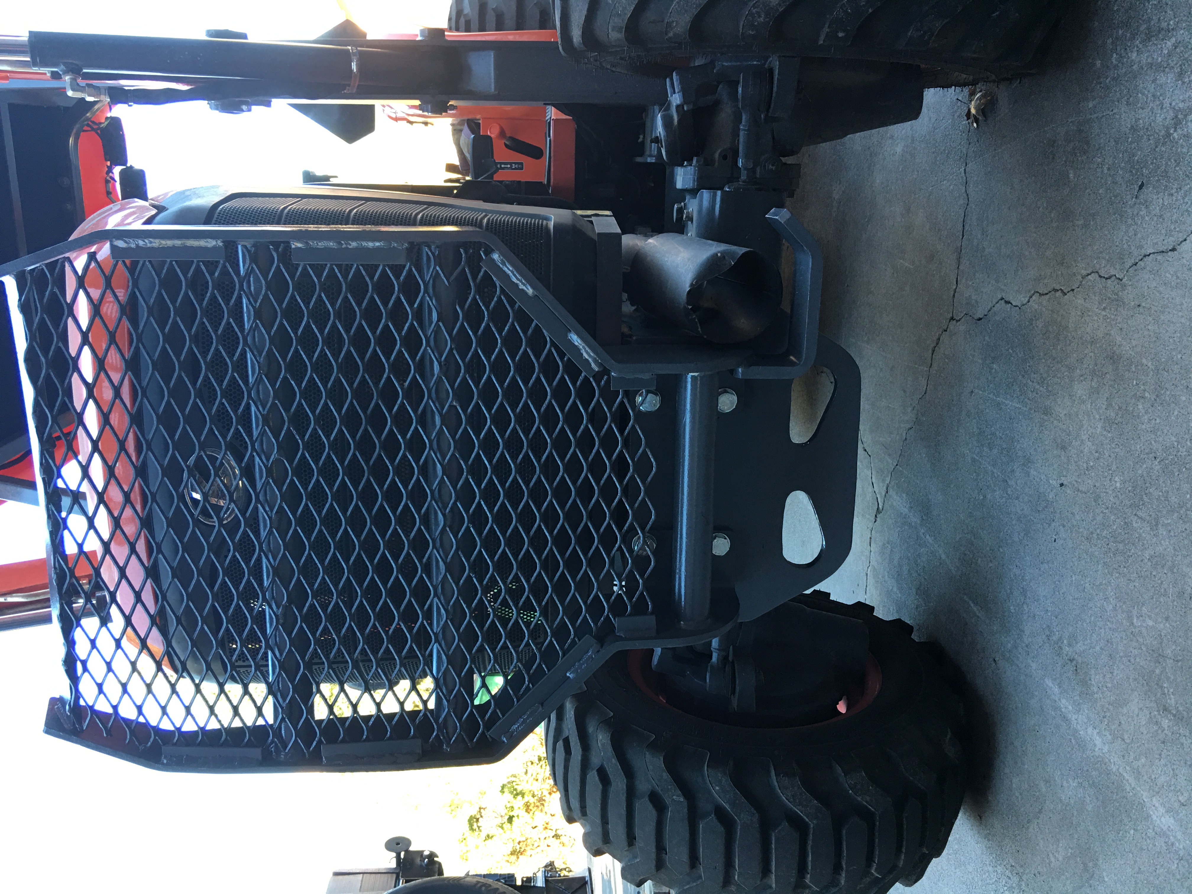

Oh look what we got here. A copy cat. Thanks Peter.
   / Kubota L47 Price Comparison #86
So nice and new, but you forgot to attach some 1-1/2 x 3 channel as wings to protect the tie rods from rocks and stumps and a 2" receiver for a hitch. Did I miss anything else?
I need to add expanded metal to my guard.
