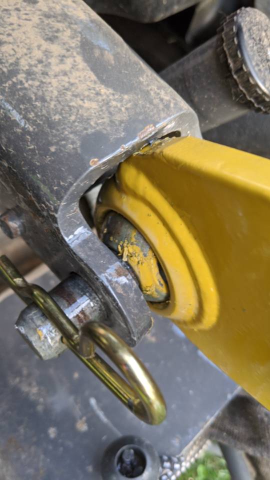

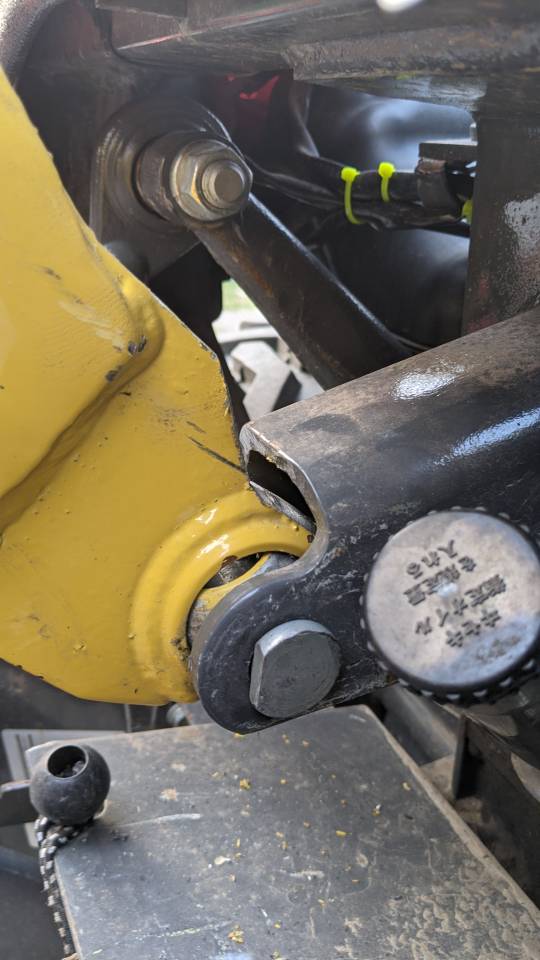

I have a GC1710 with that PHD. Different brand but same class of tractor. As you can see the PHD switches classes by way of a rotating knuckle that is sized for either a cat1 or cat2 toplink pin. Given the tight spacing and the fact this thing is built to be on a cat 2 system it was simply too heavily built for my tractor. The biggest issue for me was needing to cut out a notch from the PHD mounting plate to have enough clearance to lift the digger. I can drive the PHD with my PTO no problem but you need to be conservative with how hard you let it bite or it'll bury itself. PXL_20200915_224152444.jpgPXL_20200915_224142959.jpgIMG_20200720_200157.jpgIMG_20200720_200748.jpg
