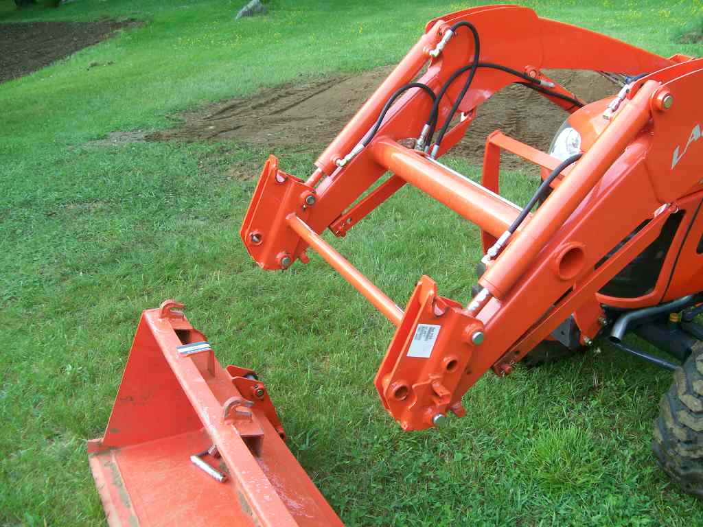

I have seen several owners show pictures of the QA Coupler on a LA364 Loader. The QA is made for the B3200 Tractor but they have it mounted to a B2620 Tractor. I have a B2920 Tractor and LA364 Loader and would like a QA coupler for a snow blade I am ordering. Kubota does not want to help on this issue. The do show three different model numbers and my dealer does not know which to order.
If anyone has a quick attach coupler mounter to a LA364 Loader I would like to know the model number of the coupler
Thanks - New Member.

I am looking for the Kubota proprietary coupler NOT the skid-steer style
I will try and load a picture.

The Kubota Quick coupler is a B-1658 that will woork on a 364 loader.

The 364 loader has the same arm spacing as the 504 loader used on the B3200. There is no problem putting Kubota's QA on the 364 loader.:thumbsup:

Just leave the top pins in the bucket. The lower pins come with the QA and you remove to come away from the bucket.

I just got a quote from the local Kubota dealer for this, this morning, this is what he put on the sheet for my 2920 quote with LA364 loader
(We went out and measured a B3200 and B2920 to double check too)
B1658 Quick Attach Coupler
B1659 Pallet Fork Frame
K9048 36" Pallet Forks

Thanks for all the info. I have received the B2920 with the Quick Attach and it works great. I did have one of the bottom pins that was tight, but once I cleaned out the paint it comes out with just my hand. I can change from the bucket to the snow blade in about 5 min. or less. It also makes for good storage. I built a real strong shelf about 3 ft off the ground that holds my snow blade, just pull the bottom pins lift up over the shelf and drive forward lower and tilt top hooks forward and it release the blade. The bucket stores under the shelf.
