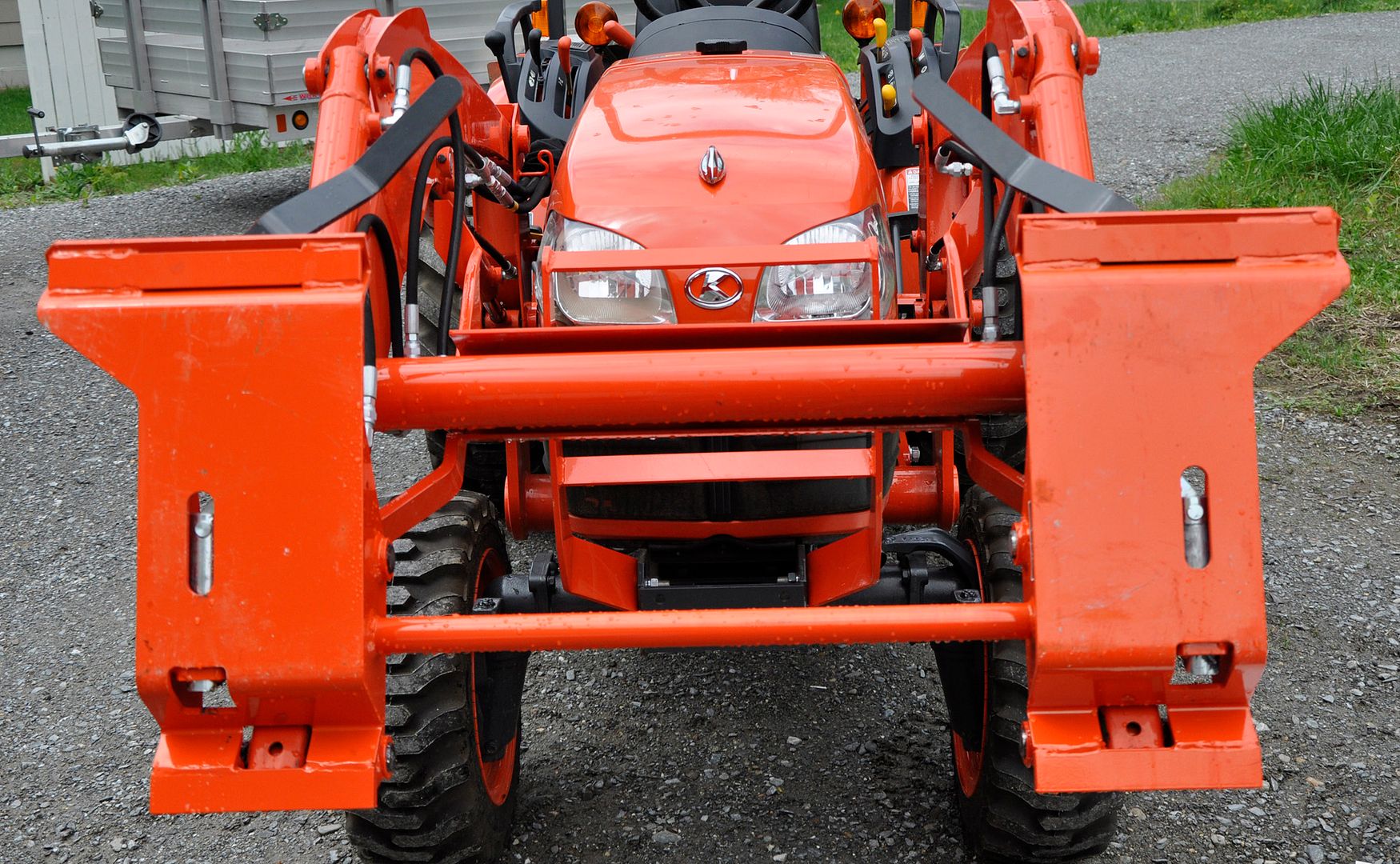

Yes - that's pretty much correct. There's been a bunch of posts here with the details - but basically if a bucket will fit on an LA504 loader - it will fit on a LA364 loader. The pin spacings and bracket width etc. - are the same. There's a new loader that is coming on the Bxx50 tractors now - the LA524. That loader takes the same buckets as the LA504/LA364. So.... any QA that would fit on the LA504 - would fit on the LA524 - or vice versa.
The LA524 is coming with an SSQA style quick attach from Kubota - I believe it's an option. I bough one last summer and put it on my LA504 - it fit on just fine - and it appears to meet the SSQA standard - as I have bought a couple of "standard" SSQA attachments and hooked them right up to it with no problems.
Go read thru some of the older posts - I posted pics of the SSQA on my LA504 with some more details.
It's been one of the best mods I've done for the tractor - I can switch attachments off the loader now VERY quickly - it's definitely better than the pin-on style QA and it makes buying attachments for the loader a LOT easier. The only downside is - it's quite a bit heavier than the Kubota pin-on style QA.

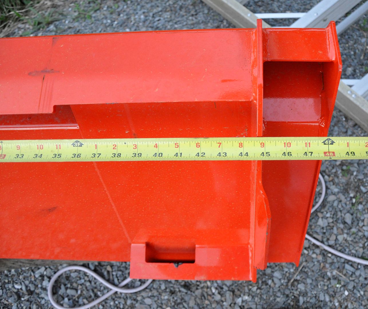

The Kubota SSQA setup weighs more than the regular pin-on type QA for sure. But they seem to have actually tried to keep the weight down. If you look at a lot of the aftermarket SSQA solutions for these size tractors - they weigh in quite a bit more. If I remember correctly the Kubota SSQA weighs in at about 75 pounds - some of the aftermarket SSQA adapters are double that.
If you're looking around at SSQA plates to weld onto implements or buckets so you can then use them on your tractor - I would be very careful of what you get - most of the SSQA plates I have seen are WAY overkill for these tractors - they use MUCH heavier gauge steel than they need to and they add a bunch of metal that probably doesn't have to be there. This just adds even more to the weight.
On my tractor (B3200) I think the advantages of the SSQA definitely outweigh the added weight and subsequent loss of lifting capability - but there have been a few times I've been trying to lift some REALLY big rocks and stumps - when it was obvious that another 100 pounds or so of lift might have helped, so I still try to be concious of just adding weight that is un-needed.

I was at a dealer in Chattanooga a couple of weeks ago and there was a Kubota rep there. He looked up the QA as a B1658 and said the dealer can order it and it was $285. Of course it doesn't come up in the Kubota parts lookup anywhere for the public. The long number (7J055-36104) comes up in the parts lookup but it's $450. ????

JRL305, I went to my dealer and requested the B1658 and it pulled right up. Price was around $268 if I remember right.

I called my dealer about 30 miles away. B1658 pulled right up. It's $285. He ordered it for me. No freight.

If you call your dealer and get a salesman, they can look it up for you. The parts dept. doesn't handle that part for some reason. I know the B1658 will fit a LA504 loader frame and that's what my B3200 and my neighbors B3300 have. The B1658 Quick Disconnect is a piece of steel on each side and a rod across between the two sides. I believe the SSQA is a huge plate.

I cut the bracket off the concrete bucket I just bought with a grinder and two wheels: a thin wheel for most of the cuts - and then a 1/4" wheel for grinding down the weld along the top which was built up more than the others because the top edge was flat - whereas the other edges were rounded (because the piece was bent.
The welds only go in so far - so I carefully cut a slot into them on an angle I thought would cut the weld without going too far into the underlying metal. Unfortunately I did cut into the underlying metal some. When the piece wouldn't just fall off - I also used a 5 pound sledge to beat on it to see if it was at least coming loose and would move.
This was on a bracket though that was only welded around the edges - if you had a bracket that was held on by welding onto holes in the middle of it (I've seen some bracketry welded on like this) - then that would be harder. On cars - they sell small round cutters to take out spot welds. The same principle would likely work for a bracket that had holes welded up in it's middle. There's a hole drilling tool called Rotabroach that could be used just like the spot weld cutters that get used on auto body repair.
