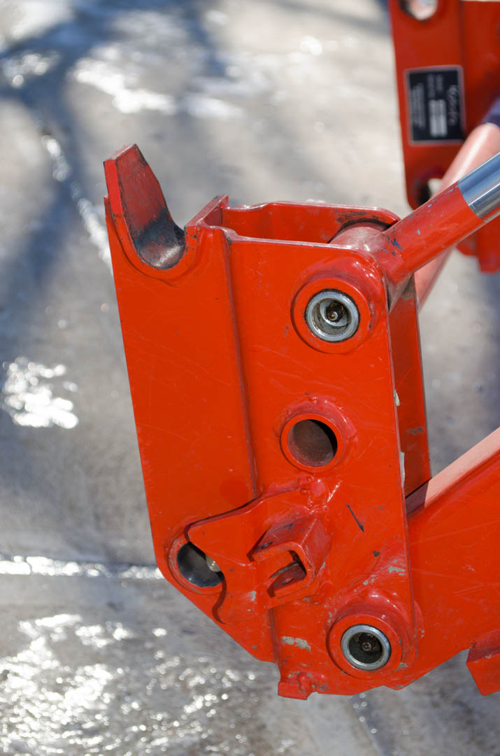

thanks. It looks like the QA sits further down on the bucket than stock does, that bottom pin is almost on the ground.
:confused3:
Not sure what you're referring to. Check out the bottom pic in post 36 - in that pic the QA is attached and locked into the bucket. The bottome pin is not on the ground.
I still have the pin-on buckets I had been using before - I could take a measurement on where the bottom pin location is on those buckets - vs. - the bottom pin location on the new SSQA buckets.

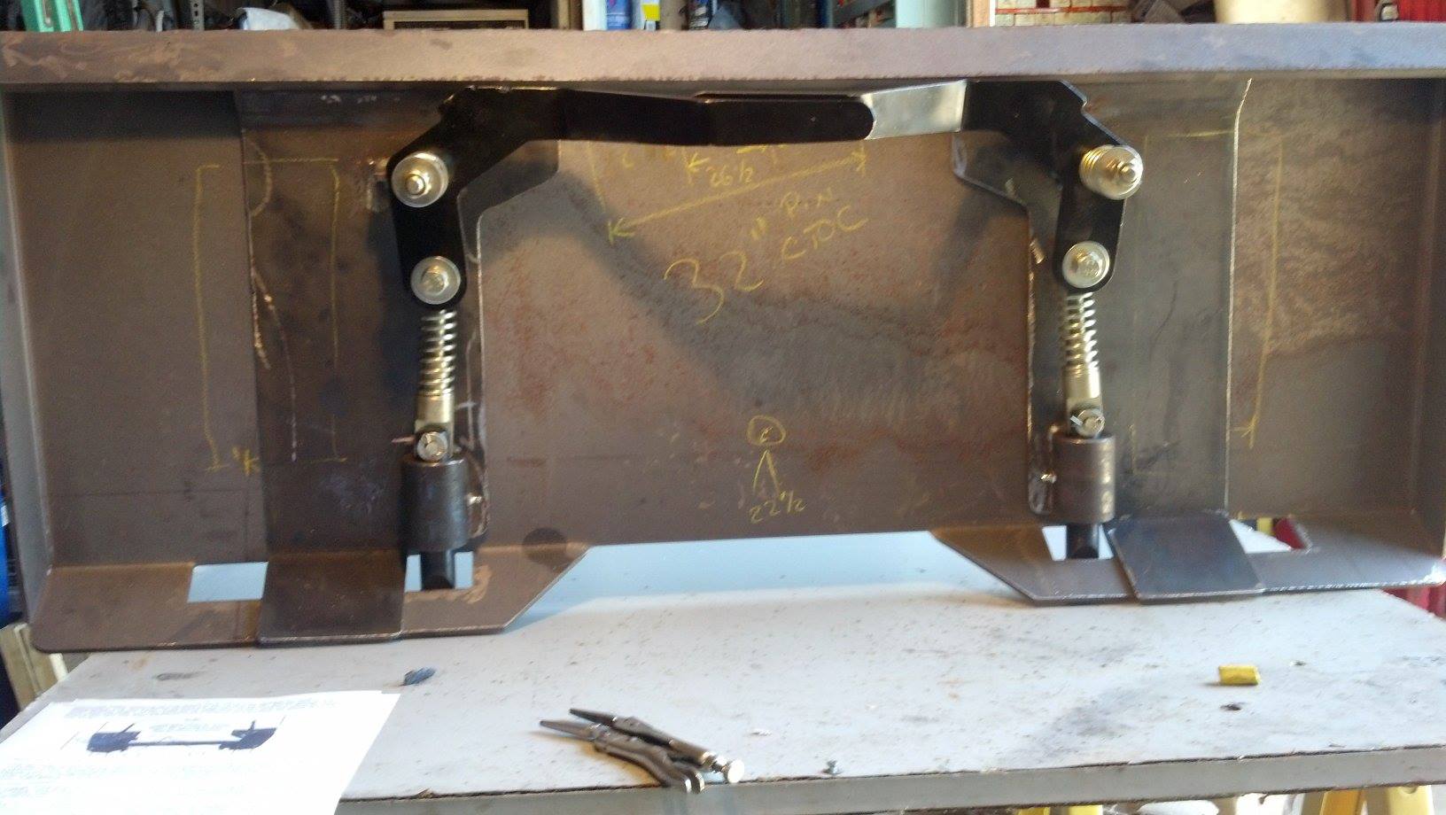

Yea I see what you mean ,with the bucket mounted and sitting level it looks the same height as mine. Looking at the unattached bracket tilted all the way back made it look as tho there's no way it would lock in that far up. I'm hoping for my version to come out quite a bit lighter than your Kubota one but mine probably wont be as indestructible as your stocker.
   / LA364 Loader Quick Coupler #43
I think with some careful design and by pulling some non-critical metal out of it - a good 15 pounds and maybe even 20 could be removed from the weight of it - without really impacting it's strength or reliability all that much.
But it would take some careful engineering. For a production piece - that would drive the cost up - probably way up. Kubota is selling these for like $450 (my dealer nailed me for more) . Compare that against what some of the other places that make SSQA adapters for these size tractors are charging - and it looks like a bargain. Part of the reason why Kubota can sell it at that price is that they've put together a design they can churn out with minimal labor.

There's a lot of extra steel in the one in that link you posted that doesn't need to be there. Those are supposed to be "universals" - and you still have to weld brackets onto it to adapt it to the loader. Which will make it weigh even more.

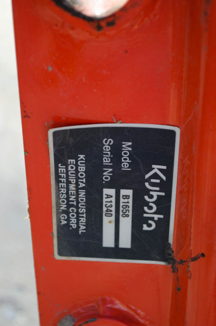

Tried calling the local Kubota dealer today to get a price on a B 1658 quick coupler and they don't even know what I'm asking about, that model # is no where in their system, has anyone else had the same problem and did you have to use a different model number or something like that. To floydc, would like to get some measurements of your quick coupler sometime to see if and how much I would have to remodel that B 1658 to fit onto my L2250 ( Loader# BF400G) Thanks, Dan
   / LA364 Loader Quick Coupler #48
I gave my dealer that exact part number and it was loaded in their system. He had to order it, but it fit like a charm.

Tell them you have a B3200 tractor and see if it comes up when they reference that "B" series tractor.
   / LA364 Loader Quick Coupler #51
Thanks, I will try that. I would also like 4 different measurements from a B1658 to see if it will work on my older Kubota, or how much remodeling it would take to make it fit and if it's even worth it too. 1, the diameter of the mounting pins, 2, the center distance from the lower pin to the upper pin, 3, the inside measurement of the coupling mount where the loader arm or tilt arm slide into, 4, the outside distance from one mounting bracket to the other mounting bracket. Mine are 1inch, 10inch, 3 inch and 44 inch. I have 1985 L2250DT that I inherited from my dad last year that's in great shape, has only around a 1000hrs on it. If worst comes to worst, there is a fabrication shop in the next town and he said he can make me whatever I need. Thanks, Dan

I pulled up a parts diagram for a B3200 and it listed the B1658 coupler under options and 7J055-36104 as the part number.

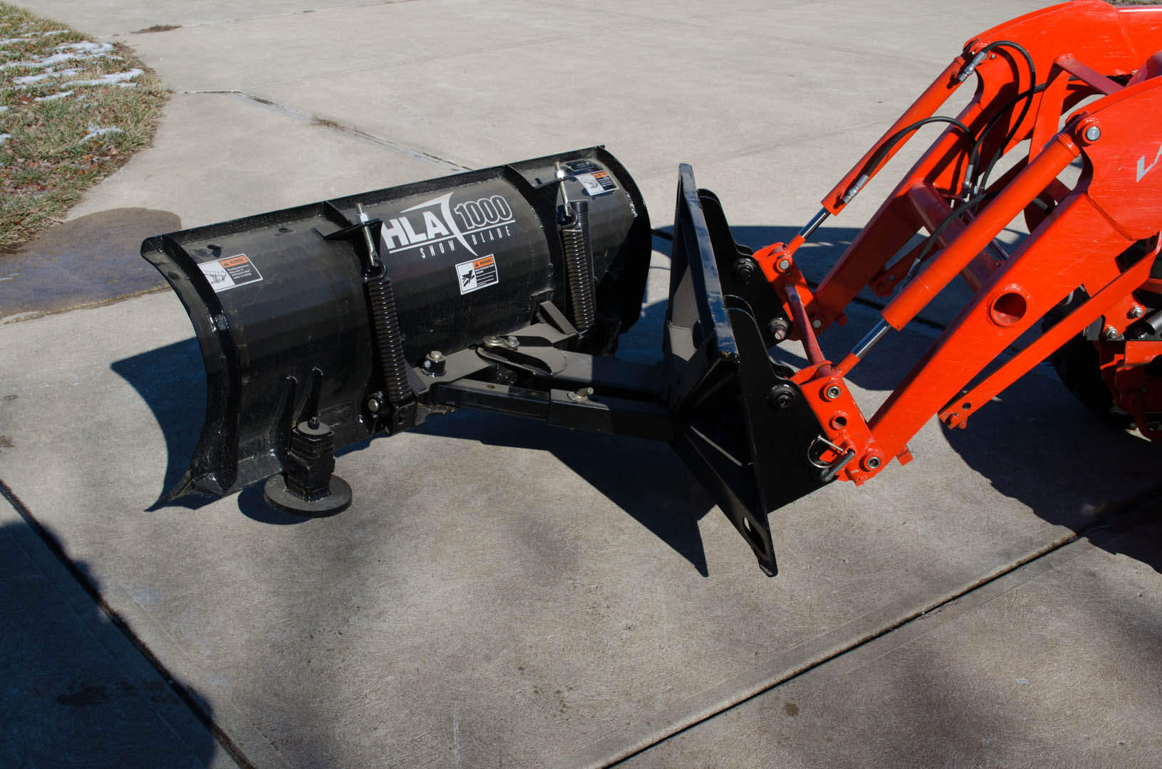

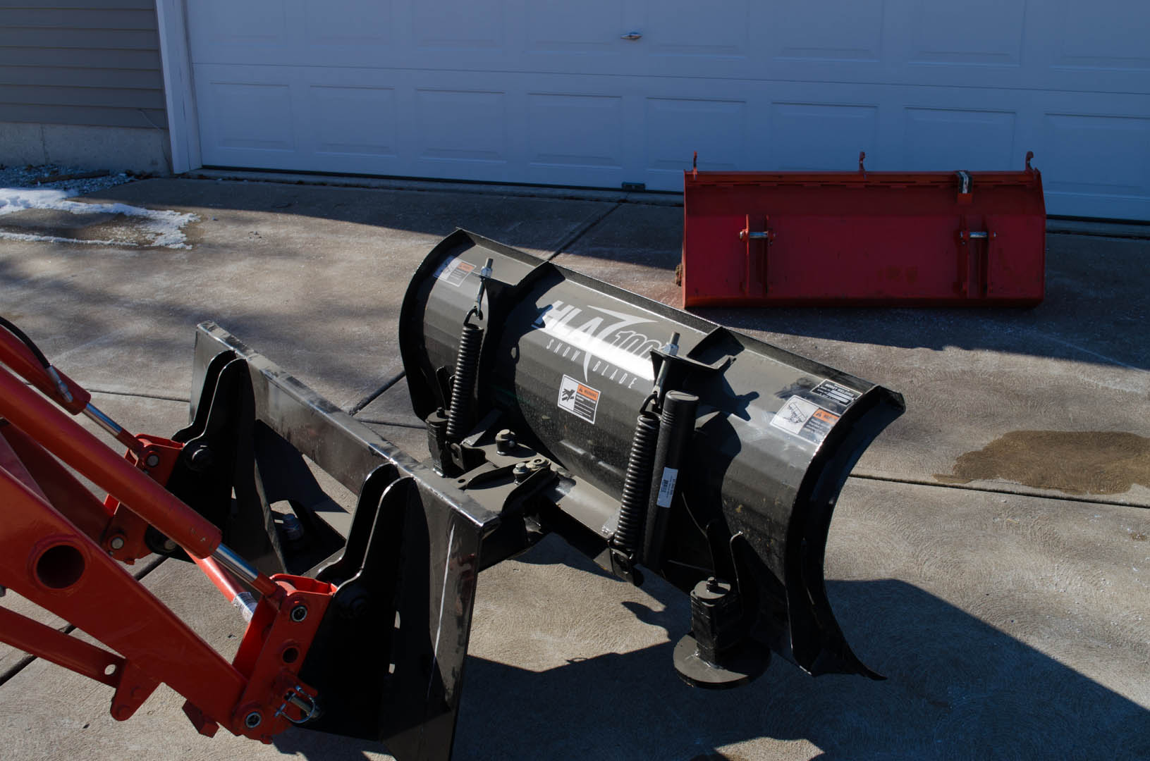

I'm going the SSQA route. I have a lot of bobcat attachments. Often the bobcat is on a jobsite and the tractor is home. It will be convenient now that the tractor will be able to load bobcat implements onto the truck/trailer in lieu of trailering the bobcat to/from a jobsite.
   / LA364 Loader Quick Coupler #60
Oh this is the kubota pin on qa, I thought it was the kubota ssqa.
I have the ssqa on my 2620 . It was a very worthwhile addition.
