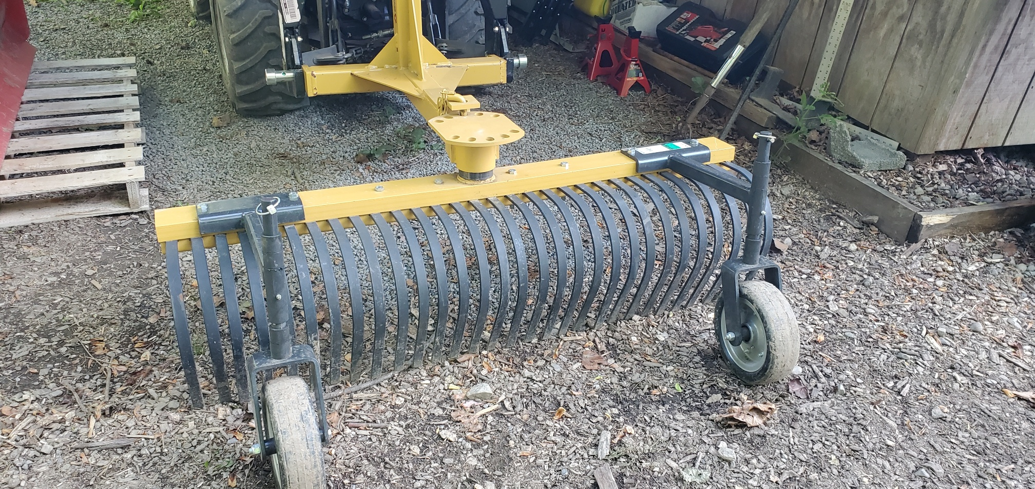

The most important feature (other than the gauge wheels) is the width. I recommend an 8' rake because when it's set to 45 degrees, it covers your rear wheels. Don't use a top link, use a chain so that the teeth stay at a set position while the tractor roller coasters up and down. You can still raise it up for transport. My ARPS rake used teeth commonly found at many sources. You will probably bend 1 or more and it takes some heat to return them to correct position. Otherwise will need to be replaced.

I have a 7' EA rake with the older style gauge wheels and have used it a lot with no damage. Get it large enough to have a 45 angle cover the tires unless you need one smaller for working in the trees. It feels like the older York Rakes pretty much nailed most of what you need in a rake if you can fine one used.
Gauge Wheels
- Useful for finer control in grading or skimming a surface such as trying to remove branches from a finish mowed lawn.
- Can't spin the rake around to push vs. pull with wheels on (old style) so you have to make a choice and wrench these heavy wheels on and off per job.
- If you get wheels, make sure they are as easy on/off as you can afford if you plan on using them much.

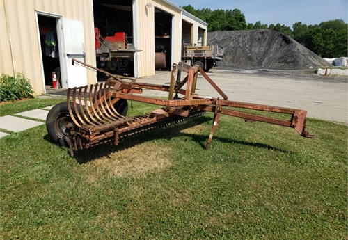

Growing up I lived 7 miles from the York Modern Manfacturing plant in NYS. The attached is the first rake I ever saw. The township owned it and pulled behind a pickup.

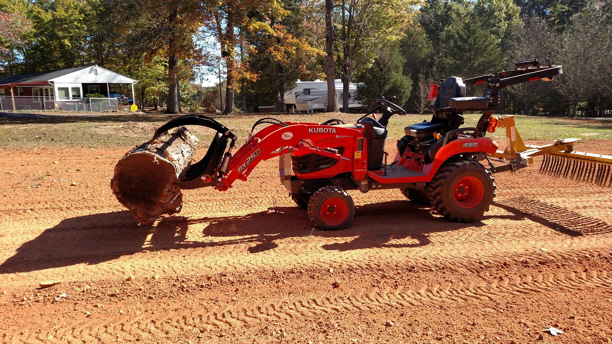

I have a Tractor Supply 6' rake American make since 2014 & most of the time except mowing I leave it on. It's a bit of learning curve how to use but like the other guy said if you put a set of trolley wheels on it it works a whole lot easier. I also had a 4' rear tiller from TSC that weighed in almost 600 lbs it was a beast and very well made. I would not hesitate to buy an implement there for homeowner use.

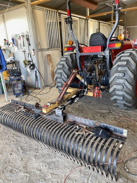

I bought a 84" brush hog rake lightly used from a neighbor 15+ yrs ago. It has seen intermittent work on 3 tractors. This yr I started using it to windrow and remove surface rocks from a couple of acres we generally scrape bare for weed control and fire break. Recently fitted it with a hydraulic cylinder for more efficient back and forth raking
