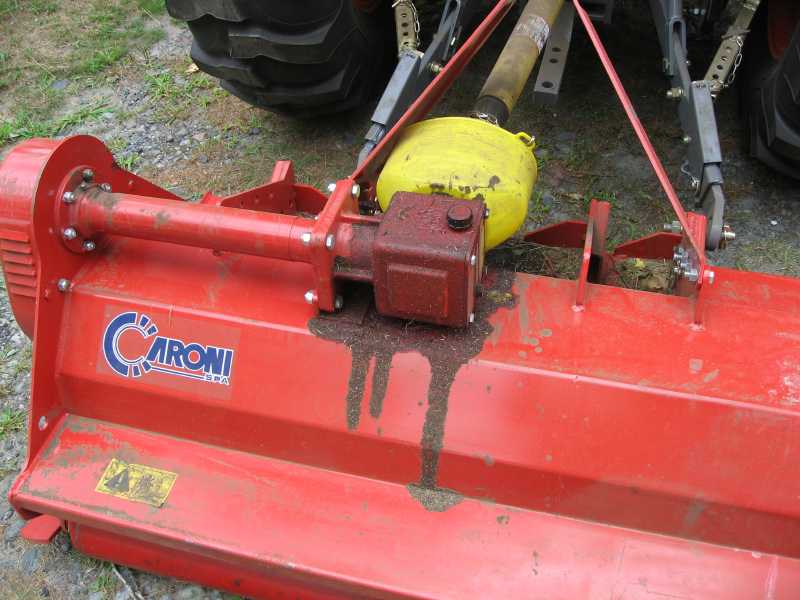

Allen, Rears and Vrisimo seem to be the very best. The only downside is costs. I think a typical 12' orchard models is nearly $10k. A 6' will run over $4k. Of course they will last for thousands of hours, so if a guy is mowing daily, they aren't expensive. I sell Vrisimo (manufactured in California and expensive), I used to sell Caroni, and I have a used 12' Rears that I use in my Orchard. Dandle is also a top notch brand.
We sold perhaps 30 of the 1900 size Caroni's and we found that they had noisy gearboxes, although the gearboxes didn't fail. The rotor bearings are a pain to change and expensive on the Caronis, so keep things greased. The Caroni is probably the best value out there in a light duty flail.
