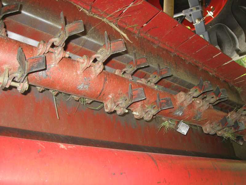

Found this for sale. Anyone recognize it? The guy selling it had no idea what brand it is, nor how old it was......... only that it was a five footer.

Looks a lot like an old Mott (now Alamo) design, or a brand that copied a lot from Mott. Hard to tell from the thumbnails, but it looks like a fine cut cuttershaft with a light duty rear roller. The drive pulleys are on the opposite side from my Mott super heavy duty versions. The a-frame design, body of the mower, and the pipe reinforcement on the leading edge and the back of the mower scream Mott though.
