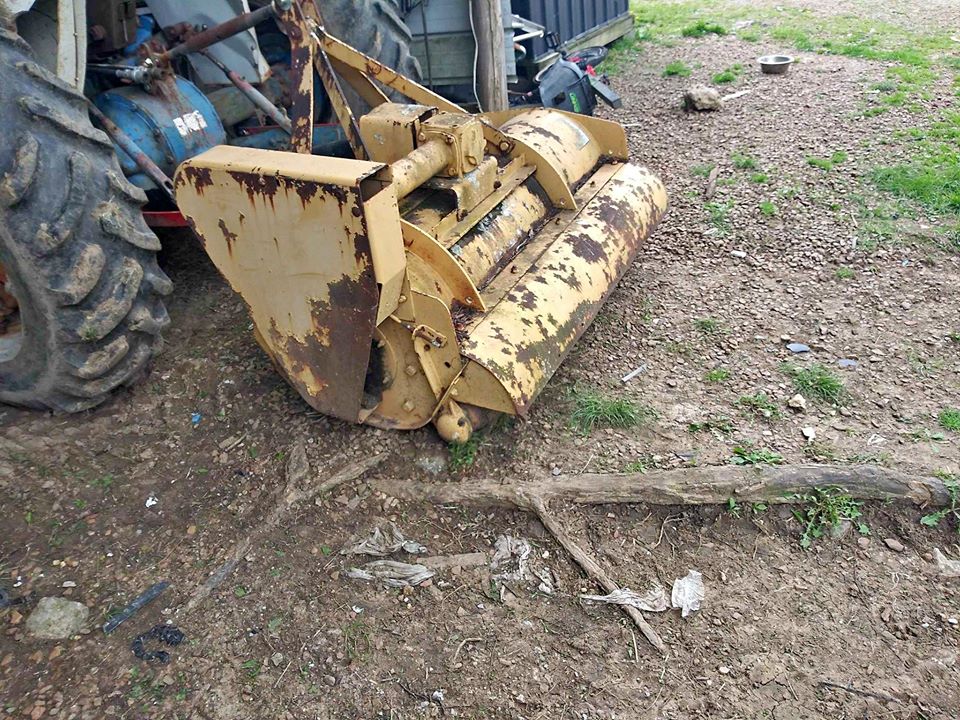

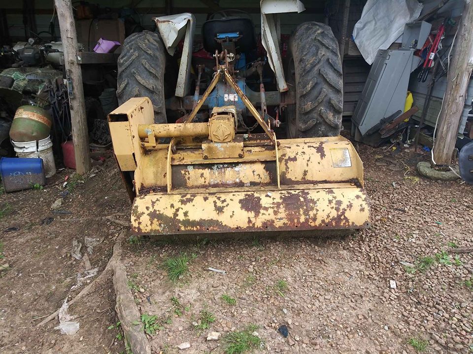

Can you take pictures from the other end? I think that can be swapped to 3 point. I may be wrong, but why not look at it.. Looks like the mount can be flipped, the round tubes front and back both have ears in what looks like the same location. If the gearbox can be flipped also.
Just looking at if it is possible.
   / Let's talk flail mowers #6,622
I can only post one picture at a time, not sure why. Thanks for the suggestion. I had the same idea. I tried taking the hitch arms off and flipping and rotating the gear box. I couldn't make it line up without a bunch of cutting and welding, something I'm not able to do.

Measure the spacing between the ears on both front and rear tubes. If they are the same, then measure from front and rear tubes, to the drive tube coming out of the gearbox side. If they are the same, then I bet it can be reversed. The gearbox mounts to the upright where the toplink connects. And I bet the bolt pattern is symmetrical. Yes you will be wrenching, but you won't be cutting and welding. Where are you located? I could help if you're close.

I took the hitch arms off, unbolted the gearbox and flipped its direction on the driveshaft. The gearbox drive shaft isn't centered front to back. I was unable to get the hitch arms under or over the drive shaft. After speaking with alamo, their tech guy said that it would spin in the wrong direction anyway, due to the pulley and belt setup.
I'm kind of afraid to make all the parts purchases and it still have it not work correctly.

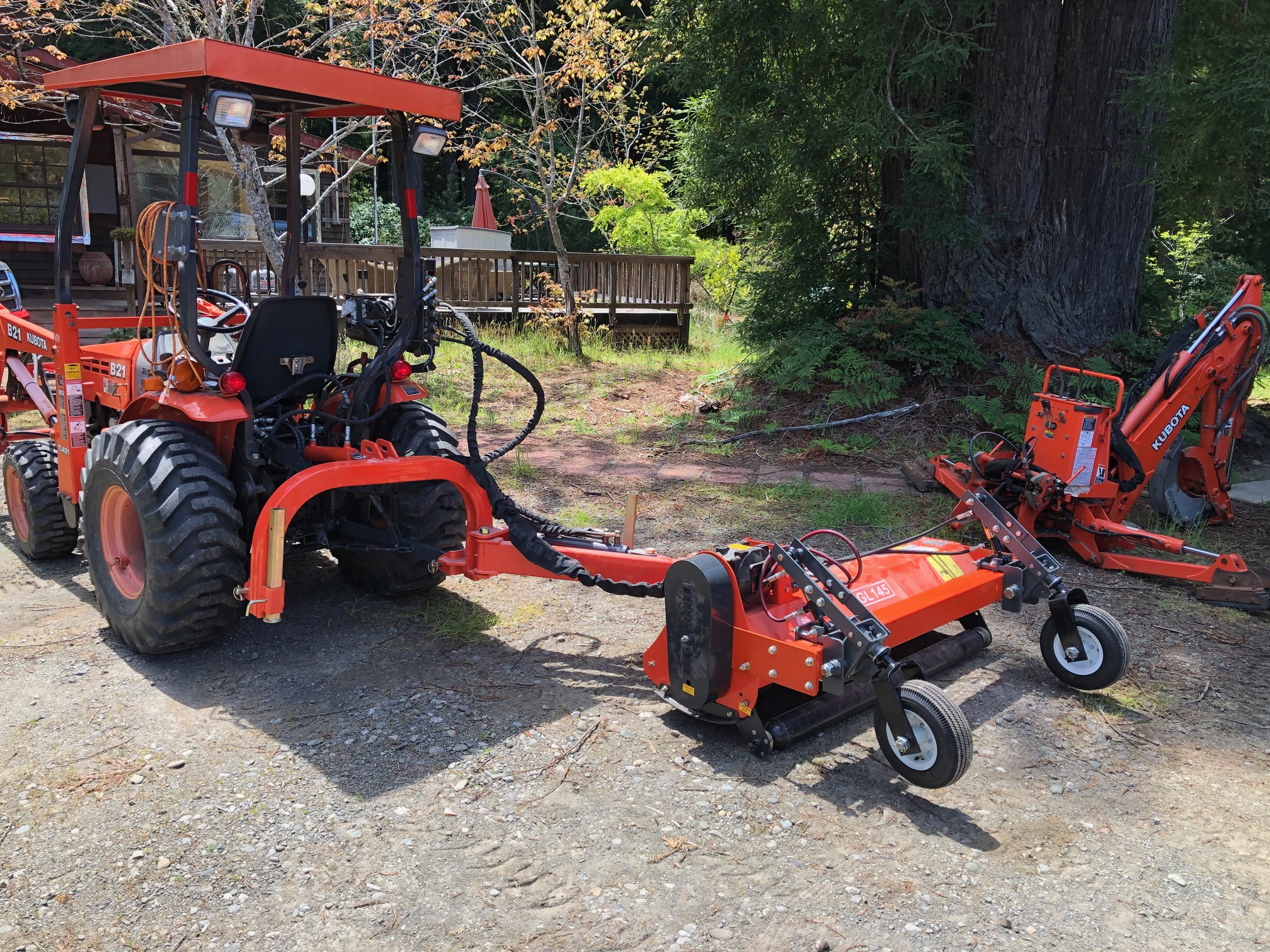

I'm gonna guess that you could pull it off ok if the roller on the mower stayed supported by the ground. But if it came off the ground it might get pretty hairy quickly.View attachment 598521
Quick update to this conversation. Everything Fallon mentions is pertinent. I decided to add wheels to the mower to make it safe to operate with the narrow B21 and also put much less stress on the three point assembly.

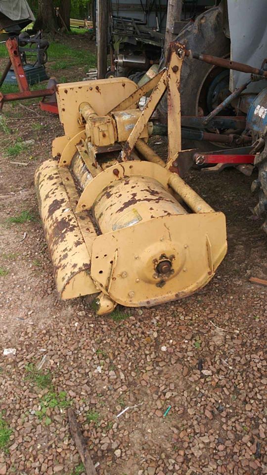

Anyone for a rousing game of "name that flail?

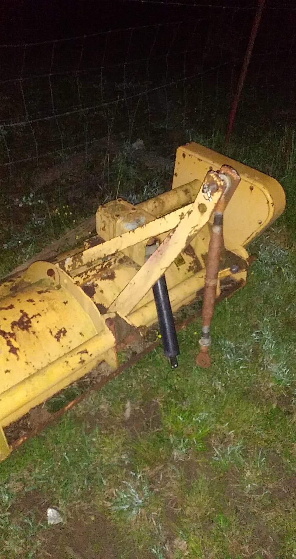

This one has come up for sale near me for what I consider a decent price. 48" in width, so a nice size for the little yanmar.
I think its a Ford 917 of some flavor but some parts look significantly different than what I remember from the one I had previously. The lift pin attachment also seems to be missing the float arms I remember? Could that be factor or is that a hack job somebody did?
Downsizing -- is it your intent to lower those extra wheels taking weight off the roller , both for transport and to keep control and prevent sideways tipping when the cutter is swung out I suppose ? Nice installation/mod. How is that mower working out reaching out over bank edges, ditches, etc. ?

The belt guard certainly looks like a Ford.
   / Let's talk flail mowers #6,632
I have a 60" mower that looks like that. It's painted Ford blue and says "Ford 917 Special" on the belt shield.
I'm going to say that it is a Ford 917 that someone hacked off the original float arms and welded on solid plates. I had a 5' 917 and it was a good mower - had to sell it when I got a bigger tractor. You can put Alamo/Mott blades on them, but that's the only part that is interchangeable. Messicks should have most of the parts you'd need for the mower otherwise, including the original (course cut) airplane wing blades.
The wheels are for moving the mower from place to place and positioning for mowing. Once in position, the wheels are lifted so the mower rests on the roller. They operate very smoothly when the mower is pushed out to the side and back again, also driving around the yard. So far I only operated it in the yard to make sure everything works as planned and to fit the PTO driveshaft. I have a few steep banks to mow, but what I mostly have is a lot of uneven ground and difficult to reach areas under the redwood trees. I wanted the tilt cylinder (used in float) so the mower can tip from side to side and better track the ground. I wanted the side extension so I could get under and around the trees.
Yeah I had a 917L at one point when I was first clearing my property. Would chew up and spit out anything. I could put float arms back on it but really don't need them. Plan to use it for what little heavy stuff I have around the fence rows.
That was kind of my guess. Was going to match the float arms to mine as other bits look pretty close to my 917.

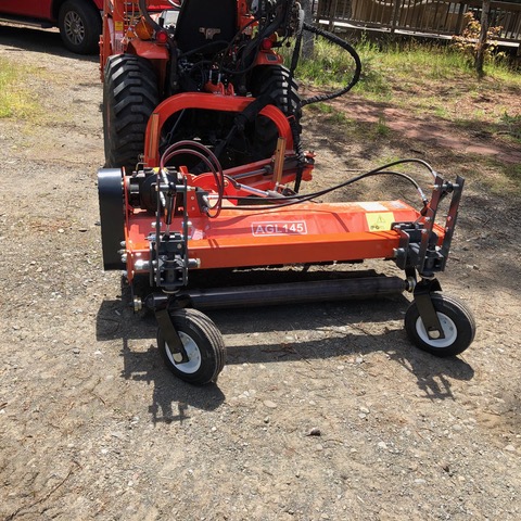

Not sure if already discussed here, offset flail on a subcompact:

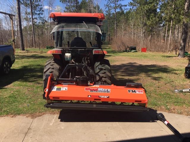

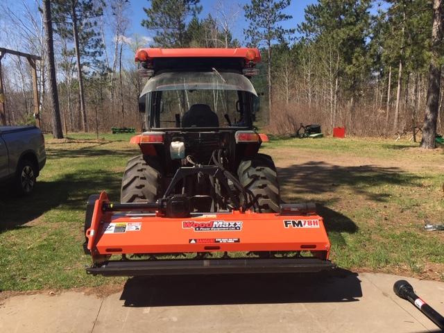

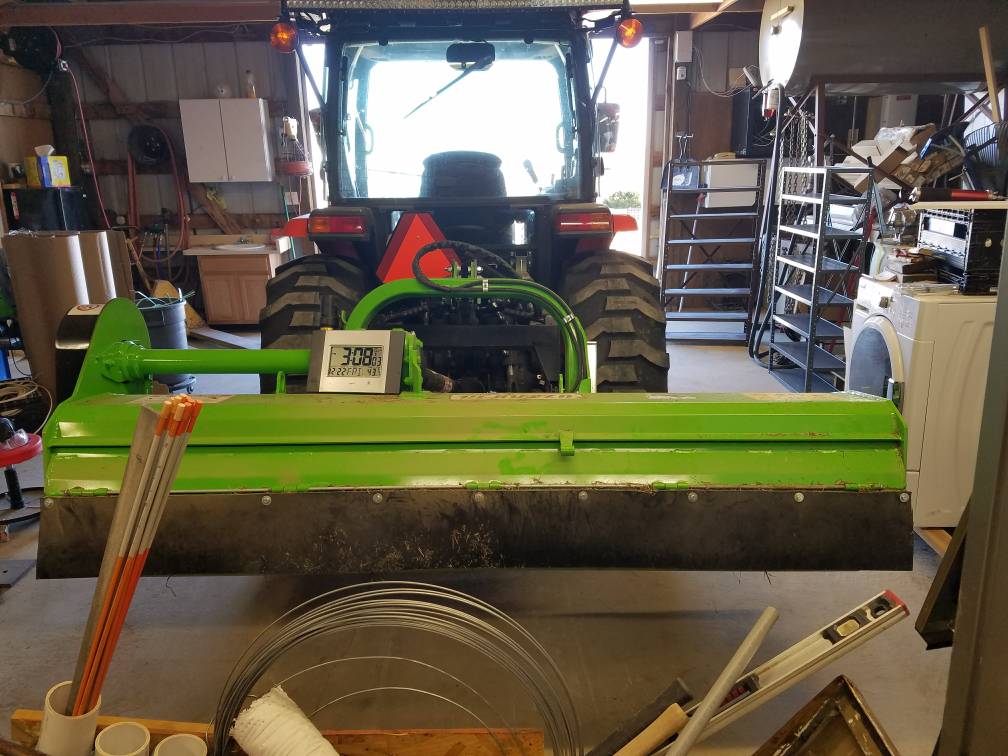

Just received and set up my Woodmaxx FM78H mower this week. Went pretty smooth.....with it taking me about 3 hours to get things set-up properly (yeah....I'm a bit slow). The pics below show the offset.....which, at the time of the pics, I had not adjusted for level. With a little fine tuning.......I took it for a spin. Seems like I have plenty of power for this unit....tho there is not much heavy stuff to cut yet. Really allot of bang for the buck with this unit. Seems ****-bent-for stout and property engineered. I bought the flail blades (all they had) and an extra set as well as spare belts. For my needs I think the knives will do a nicer job. I was quite impressed with the build quality and materials received. The assembly manual has some variations from current production....but nothing that cannot be figured out. Looking forward to mowing season. Gonna love that hydraulic shift right. OH....and the paint makes a good match for my Bota. flail centered.jpgFlail shift right.jpg
