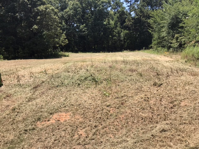

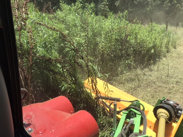

Ran my first flail mower today and I must admit it ain't half bad. :thumbsup:

Regular grass knives. No speedometer but ~3mph? A couple of small parts of the video almost look like I sped it up bit I didn't, might also be affected by the wide angle lens being used. At that height of grass I can move along pretty well, but you can see even in the 6 ft tall stuff at the end it goes through quite well. The only time I've really had trouble is one area where the owner has wanted me to leave it until later in the year as they mow trails through for the kids, but by the time I've mowed that late summer the past two years I think the winds have twisted the grasses together. I've had to go down to ~1/2 width passes and still constantly bogging the tractor down to a near stall, so this year I said no way it's getting flattened early on... :thumbsup:
   / Let's talk flail mowers #6,720
Hllo and good afternoon K5Iwq,
I want to welcome you as the newest resident member of the "Flail Mower Nations" from the Great State of Texas, Mineola branch.
If you decide to recut it in a few days ypu will find that the clippings will mulch that much faster for you. I always suggest to the members that they can mow in a spiral pattern to avoid having to stop back up turn around and then return on the next pass as it saves fuel time and labor when mowing.
Happy Mowing
