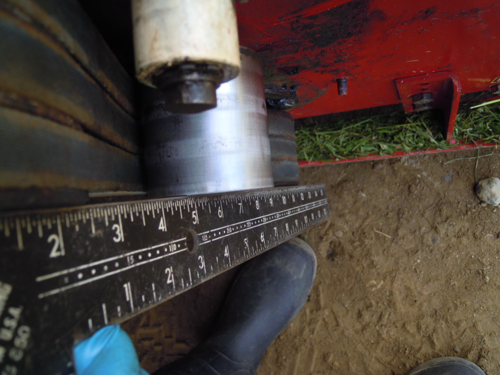

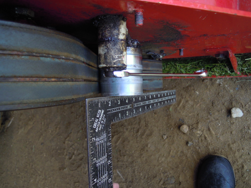

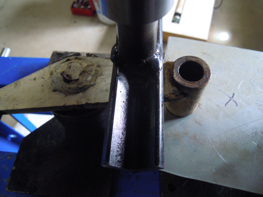

I pulled the belt cover and checked the idler. Looked out of alignment to me (first pic). So I took it into the shop and used the press to bend the support plate slightly (second pic). Back and forth a few times until I got the alignment looking good (third pic). Back together and then a trial run. After 45 minutes of cutting some light grass, the temps on the idler and belts were up to 240*. Seems too hot to me but it was a little cooler than before. There was also what appears to be some liquid grease in the bottom of the idler (fourth pic). Probably not a good sign.

I was going to suggest checking the alignment of the idle pulley too.

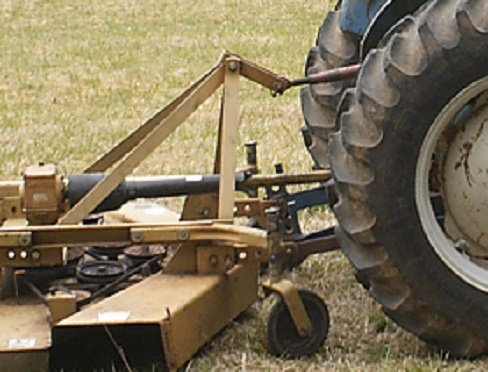

K5lwq, is there enough slop in the fit so you can put it in the lower set of holes up front and the upper in the back? That would move the roller lower.
That would actually exaggerate the issue. The rear hole becomes a pivot point. With the rear bolt in the top hole and front in the bottom the roller will be lower causing an even higher cut than with both in the top holes (roller in low position/long cut). And the reverse would be a lower cut than in the bottom holes (roller in high position/short cut). The problem is: roller low = too long cut, roller high = too short cut. Something in between is the desired result.
Why not just replace the bearings at this point. Should be cheap.
This exactly correct. I should have a longer top link somewhere. I will find it and give that a try this weekend. If that does not get us where we want, I will add new holes in frame and bracket. I can't imagine a longer top link not solving this issue.
Thanks to all of y'all for your help!
There is no signs of the bearings being bad but I might as well replace them since nothing else is working. The only other thing I can think of is that the belts are tensioned wrong. These bearings will likely be a PITA to replace. I'm pretty sure they are pressed on.
You got a press. You are one up on me. Could have used one the other day too.
Edit: parts diagram shows that assembly is circliped together so disassembly should be easy.

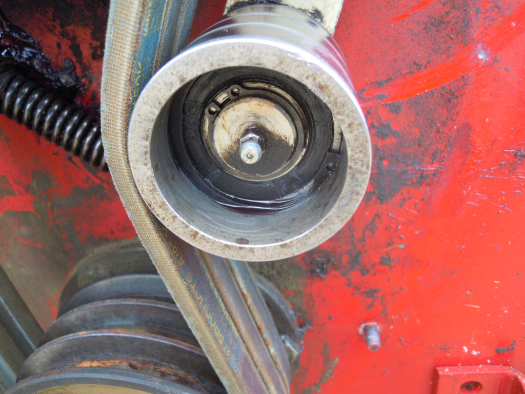

View attachment 660000View attachment 660001View attachment 660002View attachment 660003

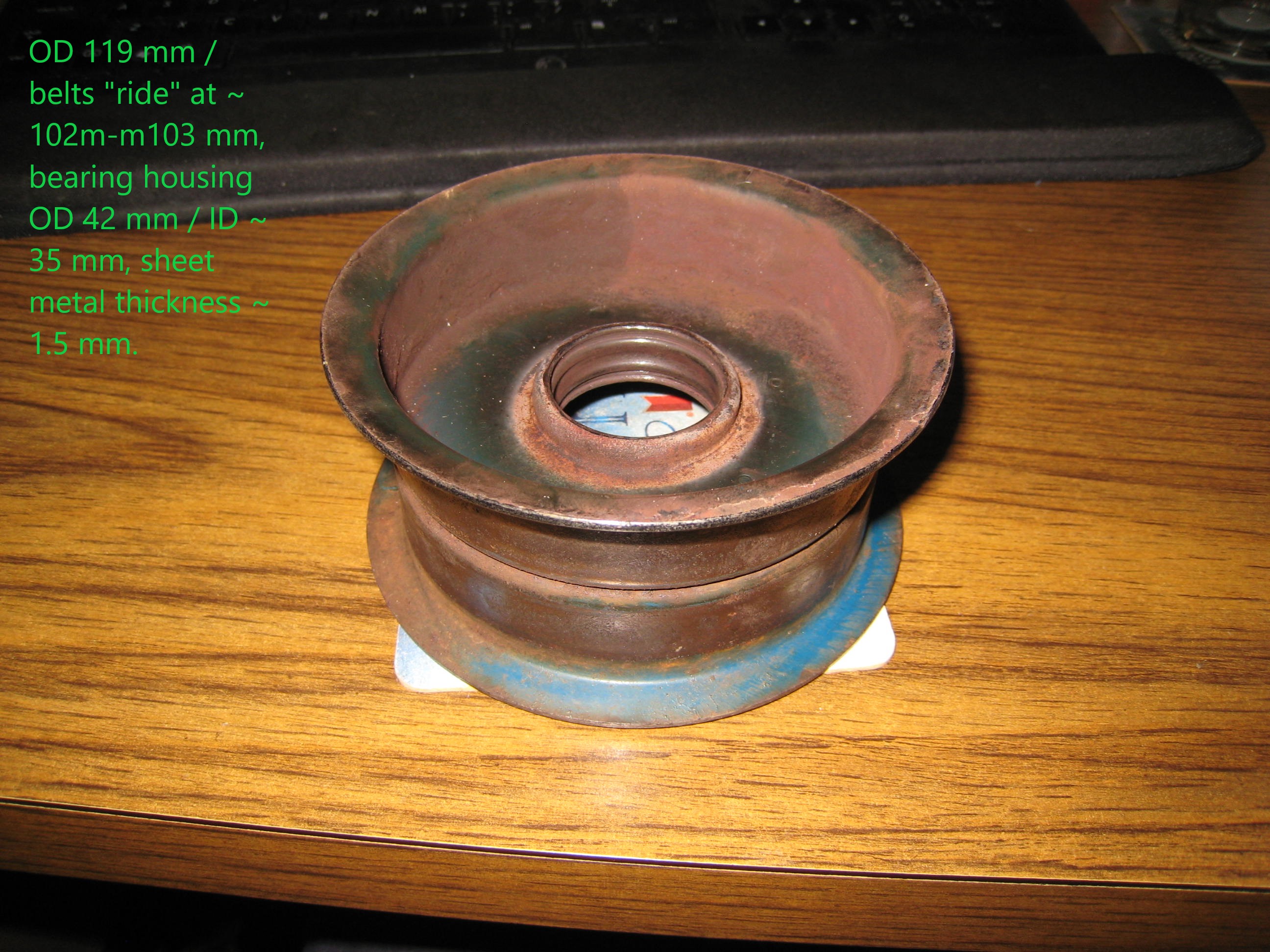

I agree that sounds like a pretty high idler pulley temperature.
Just an observation:
I am just in process of repairing idler pulley on my (new to me) Ford 917L and it is noticeable how the idler looks like it's pretty small diameter in the Caroni.
The 917L idler had failed due to worn out single row sealed ball bearing which was designed to be non-replaceable.
The OD in 917L idler is 4 1/4 inches which I thought was pretty small until I had a look at your photos!
Probably the smaller the diameter the more bending of the belt IE. more heat.
917L idler:

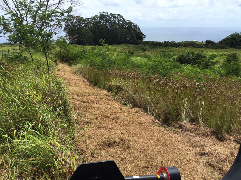

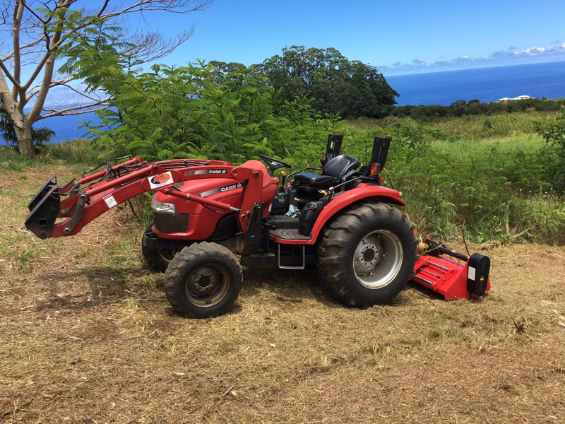

Thanks everyone for your help setting up my new flail! Longer top link did the trick. Happy with the cut now and just need more seat time to become more efficient with it. :thumbsup:

Try running it without the cover, are your belts rubbing on the cover? Heat is caused by slipping, if it were bearings, the wheel with the bad bearings would be way hotter than everything else.

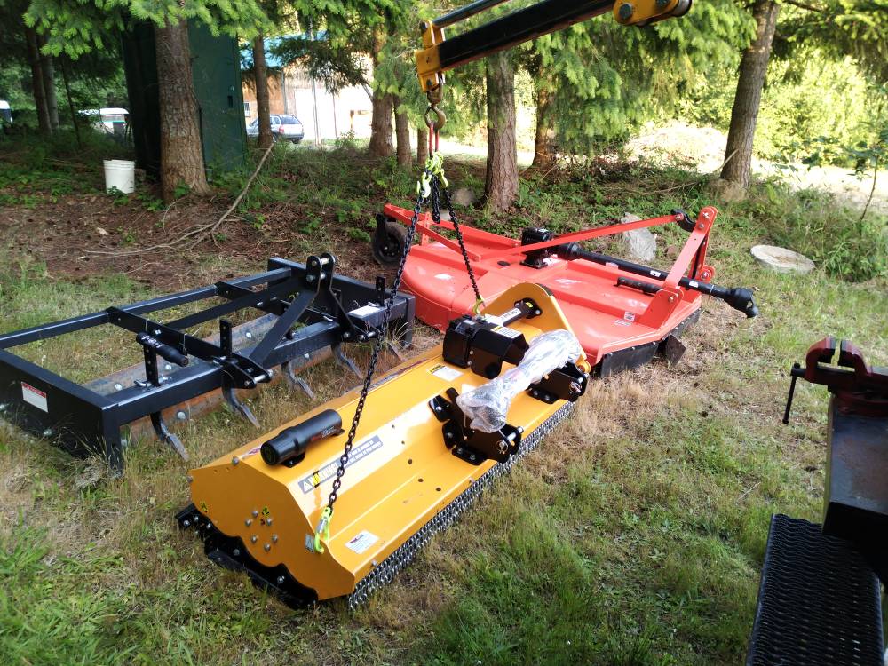

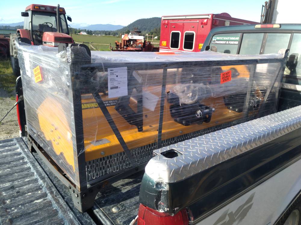

New member, just bought 30 acres of forestland, the property is mostly hillside with several overgrown logging roads crossing it.
I've been borrowing a New Holland 918H, after a lot of time reading this thread I ordered a Woodmaxx FM-78. It was delivered last week, the upper part of the 3 point hitch had been knocked around in the shipping crate and scratched up the paint on the mower in a few places. No real damage that some touch-up paint won't fix though.
Build quality and fit/finish seem better than most imported implements. I ordered it with hammers but will probably switch over to knives in a year or two after clearing some of the brush and downed limbs. IMG_20200617_184106.jpegIMG_20200617_184119.jpegIMG_20200617_202022.jpeg
Build quality and fit/finish seem better than most imported implements. I ordered it with hammers but will probably switch over to knives in a year or two after clearing some of the brush and downed limbs. View attachment 660631View attachment 660632View attachment 660633
Congratulations and welcome to TBN! Keep us updated on how you like your new mower!
917L idler:

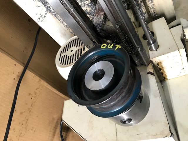

I have made some progress repairing the idler pulley but it's been delayed due to other priorities.
(I decided to make a new hub wide enough for two bearings and reuse the rest of the idler)
Here are couple of photos of work in progress:
