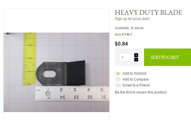

Hi all - I have a Caroni TM-1900BSC mower that I bought early last year. I bought a batch of replacement blades from Flailmaster.com at the recommendation of this forum (thank you!). But my supply is running low and Flailmaster is apparently gone. The blades I bought were M-108381 Forged Heavy-Duty @$1.98 ea: .196" thick, 1-3/4" wide, 3" tall, 1"x1/2" mounting slot. The 3" tall is a bit hard to measure, that's what the catalog says, but the actual blade is taller, depending on how you measure it.
Anyway, has anyone found another source for replacement blades? The factory blades from Agrisupply are $5 ea! I did find these from mowpart.com @$2.15 (Lawn Mower and Small Engine Parts Genuine OEM | Rhino 2986332 Course Cut Knife Non-Returnable MowPart), but they are not thick enough - maybe they have an alternative.
And I found these from hardhitter.com @$3.83 which may be right, but a bit pricey (GE105319M-HD - $3.83 : Hard Hitter, Wear Parts With Muscle).
Any other suggestions - I go through a lot of blades, so price makes a difference.

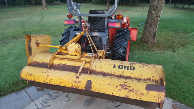

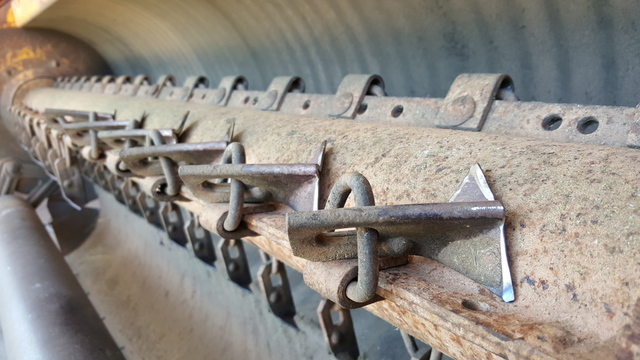

I have searched for blades for a Ford 917. Only thing not 3/4 prices was on eBay Always bought from Flailmaster. I ain稚 paying 12$ a blade for 27 or 33 blades. I have both.

The forged blades are just thicker version of the standard blades. The blades range from .106" to the .196" that you have. Depending on what you're cutting you'd likely be okay with the standard blade. I have the FM-7 blades from Flailmaster (.130") on my SHD88 and they do great for grass and light brush. Anything over 1/2" thick I need to take my time mowing, but most of my mowing is grass.

TheFarmerInAdell - thanks for the tip!! I ordered a batch of blades from Flailmaster. They still have their supplier for these. I now have a supply for the rest of this year.
BTW, I replace just the blades that have been trashed (usually by rocks, lots of rocks in VT). So I want the replacements to match the rest to keep things balanced.
