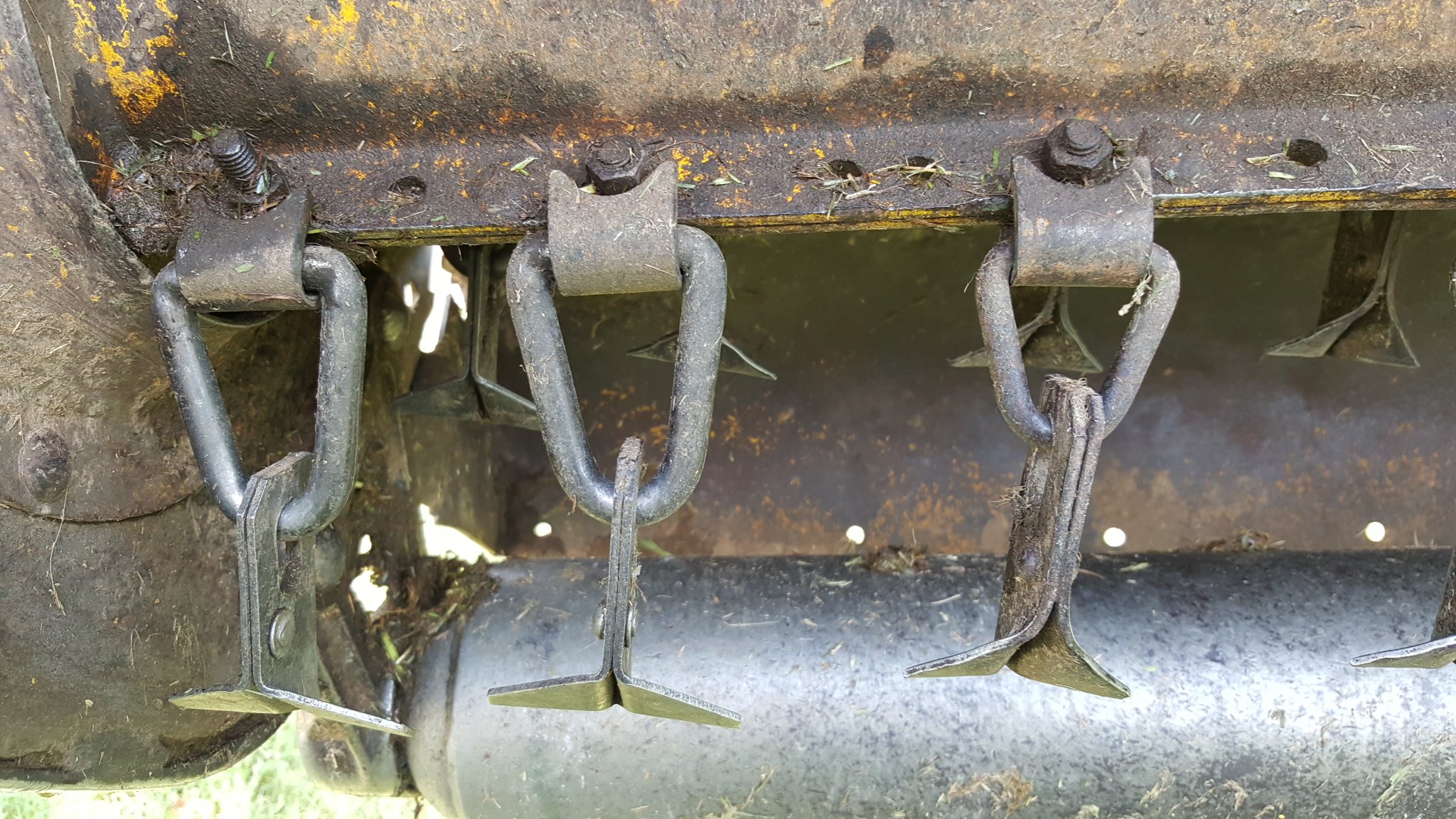

So, I was cutting my meadow with my Chicomm flail mower. The meadow hasn't been cut in a while. Some 5-6 foot grass and weeds with small shrubs intertwined. While in tall grass where I couldn't see the ground, I was avoiding what I knew was a piece of concrete lurking below. I avoided the concrete but tangled with a large piece of sheet metal...looks like part of the hood of an automobile. Well, before I could take action, the sheet metal was wound up in the rotor and the 3 cylinder Perkins began to struggle and die. A quick stab on the clutch took power off the PTO. I drove back to the garage where i put he mower up in the air to have a good look. Its pretty well wrapped around the rotor, tangled in the hammer flails and will require some surgery to back out the sheet metal. I'll likely try barring over the flail rotor backwards. If that doesn't work, I'll try my angle grinder and cut up the sheet into bits. Either way, its going to take some effort and time. I'll disconnect the 3 point lift arms, leave the top link attached and pull the mower over on its back to get at the rotor. I'll likely spill some GL-5 gear oil.
So, is my approach OK? Anybody have other ideas, suggestions? Once I have the mower over on its back, I'll post some photos that will show details of the undigested sheet metal and what I'm up against. I do have some new-found respect for the Chicomm flail mower. It has suffered and survived some severe service.... rocks, Buick hubcaps and now what appears to be an automobile hood....maybe part of the Buick the hubcaps belong to.
While I have the mower inverted, maybe I'll put a grinder on the flails and touch them up a bit.
Comments solicited.
Thanks.

Def38, my suggestion is take your time, wear some really good gloves and be careful!

Experience says bolt cutters or angle grinder. Probably angle grinder in your case. Maybe a sawzall.
If 40hp or whatever + lots of momentum wedged it in there you aren't pulling it out. Maybe if you unhitch it, flip it over & are lucky enough to get a grip on it with something &use hydraulics or a huge lever.
Flipping it over may be a good idea anyway. Working over your head sucks. And make sure you block up your impliment before working on it. They leak down slowly even if there isn't a catastrophic failure that results in in you being instantly crushed.

A 4" angle grinder with a cutoff wheel will dissect an automotive hood easily and quickly.
Maybe slow down a bit while mowing. If you can't spot a car hood, you must be going too fast.
