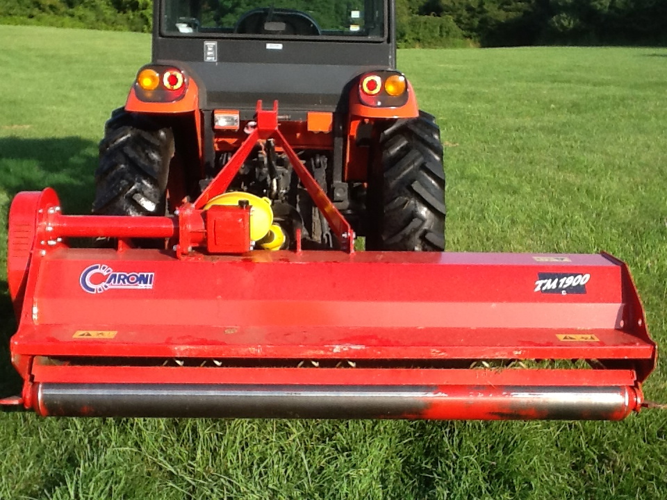

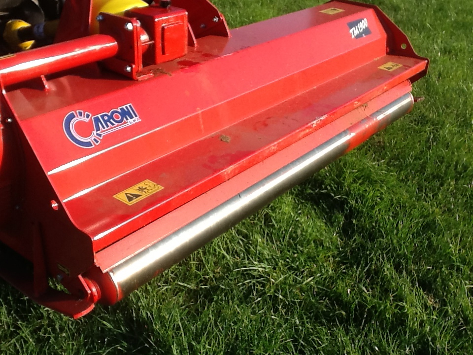

View attachment 332386View attachment 332388I could use a bit of advice from you Caroni owners out there. Took delivery of my TM1900 last week...have mowed about 12 hours with it (just grass, hay field regrowth, no brush) and find that the roller is not always turning due to scrapper bar. In fact, there is one strip about 5/8" wide, running the full length of the roller that looks like chrome from dragging so much.
Anyone else run into this problem?
Have you Caroni owners modified your scrapper bar so it doesn't ride directly on the roller? If so, what did you do.
Oh, before someone asks, I greased bearings before use, and again after 5 hours. If scrapper is lifted up, roller spins like a top.
I just removed my scraper bar because my roller gets pretty beat up banging over rocks etc. and the mower works fine without it! But keep it on if you're mowing wet grass. The other thing about the scraper bar is if you look at each end you'll notice it rides on the end cap weld seams, you can wait till it wears in or, like I did, notch the bar ends to clear the welds and it will ride flat on the roller.
/ Let's talk flail mowers #1,402
Dirthauler,
Since my original post, I've secured the scraper bar in a full raised position with two tie down straps. Have mowed an additional 30 hours in this manner with great results. Don't get those occasional clumps of grass that build up, on and around the scraper, then fall off...much cleaner looking job when finished. When this season is over, like you, I will be removing it completely...Bob

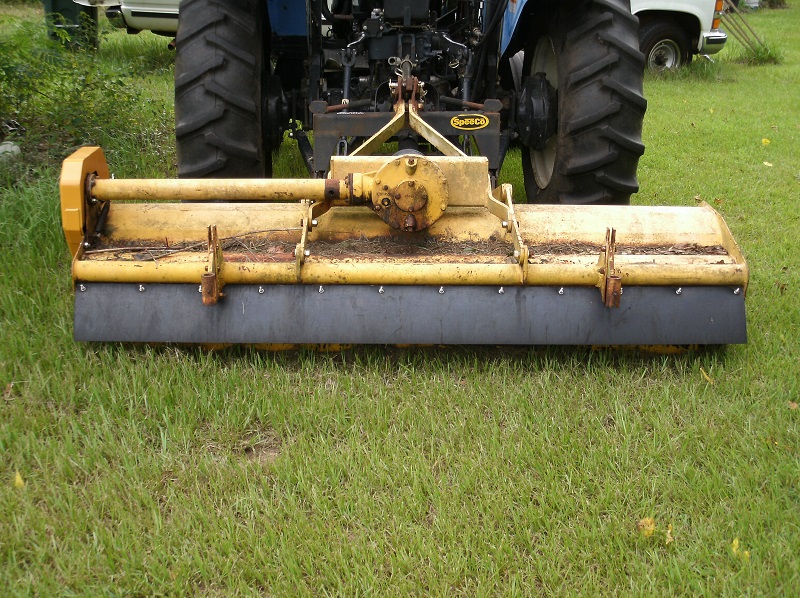

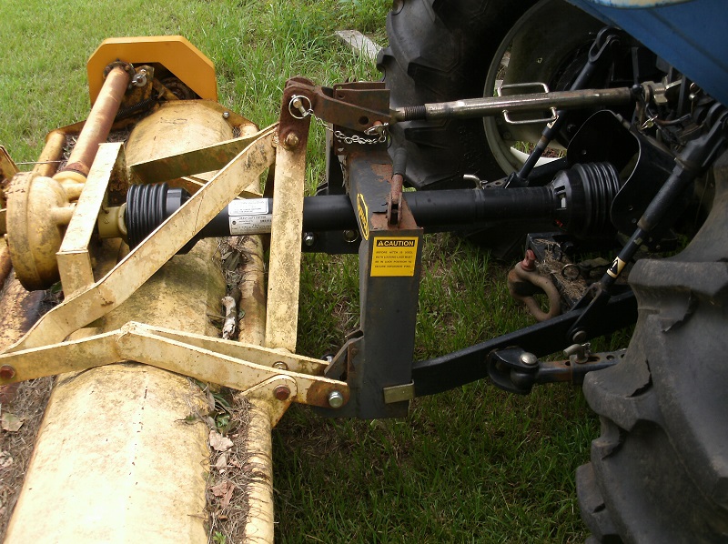

Hello Flail Nation. Im trying to join your ranks. Ive found a ford flail that i can afford but cant find much info on it. Anyone know where i should look? Also, what should i check for when i inspect it? The owner says he replace the belt and its a 5' mower. Thanks all!

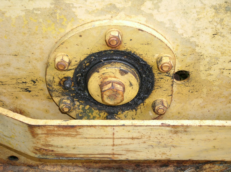

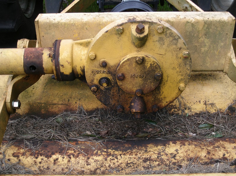

Does anyone know how to tell which bearings I have on the cutter shaft without taking the bearings out? Due to a back injury Saturday is the only day I will have help to take it apart and put it back together again. I was told by FlailMaster to take the bearings out before I ordered replacements, to see if I had the old style or the new style bearings.
Here are a few pics if it helps, I do have the old style gearbox...
The bearing plate is the same for both sides...
/ Let's talk flail mowers #1,405
As a sweeping generalization...
Where it matters manufacturers often change things like this with a step in serial (or model) numbers, or at least record the number above which the new part was used.
I would get back to them with the question; "Can you tell by serial number being above/below a particular number ?" and quote them my serial & model numbers.
Where it doesn't matter, e.g. just a product improvement or cost reduction, might as well use the newer part anyway.
BTW, have they told you that new part won't fit or won't work in place of old part ?
/ Let's talk flail mowers #1,406
How about ordering both old and new replacement bearings and just return the ones you don't need?

Problem resolved itself, found a crack in the outside flange so I ordered new flanges with the bearings. Wish I had seen that earlier... :D
