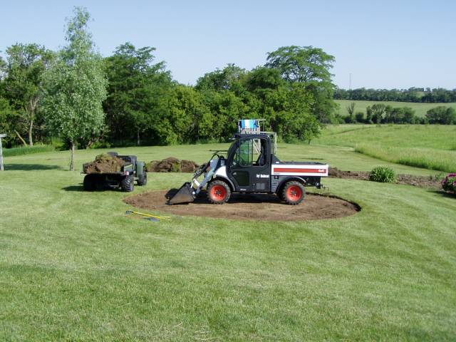

dsb5610 said:
I recommend hiring/renting a skid steer. I was surprised how much I had to haul away. Mine was 20' diameter and around 18" deep on the high side.
dsb
Wow! I am AMAZED at the quality of that excavation work in your picture. That is near art quality. :)
How in the world did you ever get the sod out so incredibly cleanly?
/ Leveling an area for an AG pool. #31
5030tinkerer,
From that picture it looks like I drove the Toolcat in the yard and cut a level circle. Wish it was that easy.
I started by driving a stake in the ground, tied a 10' piece of construction line to it, walked in a circle spraying paint. Once I had the boundry marked
I shaved off the sod I could get with the Toolcat working from the lowest side and then used an edging tool (half-moon spade) to cut the edges of the circle. You can see some of the sod piled in a long row at the edge of the garden area behind the Toolcat. Then I did rough grading with the Toolcat.
Once the rough grade was cut I tilled the high areas, used the Toolcat to shave it off, till some more, shave and so on.
dsb
