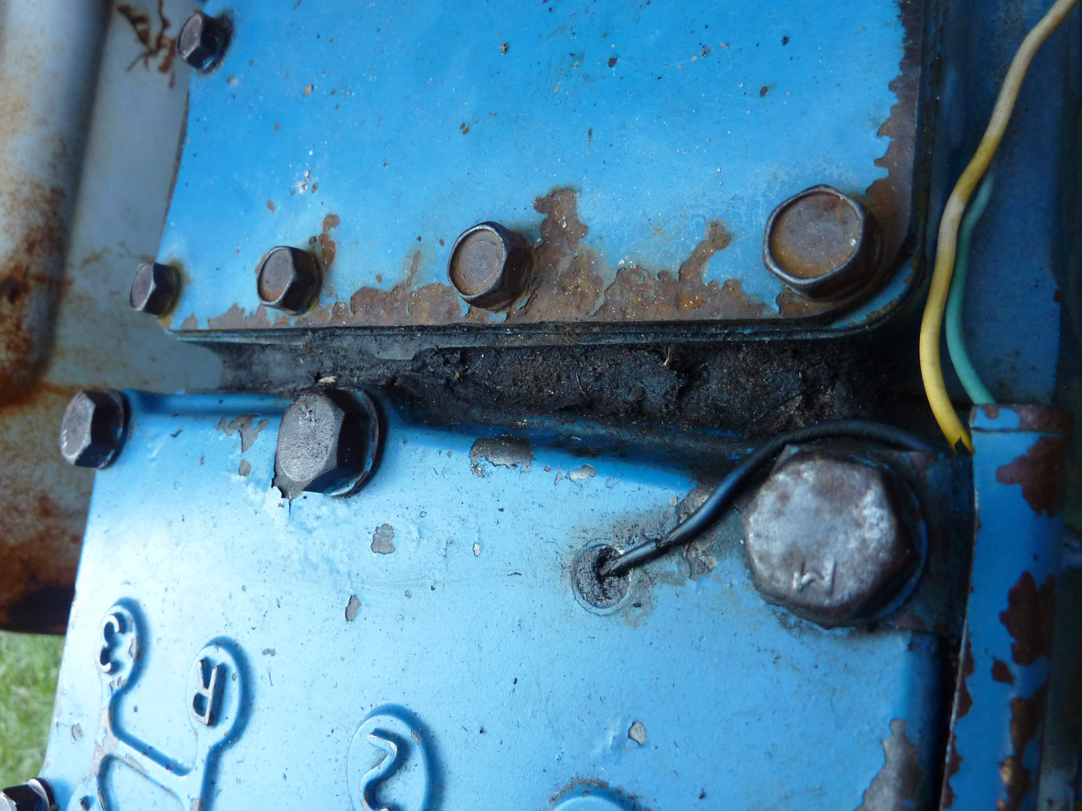

i did find somthin in the seam on top were the cast splits in half. it's a tar like substance. perhaps more of a non hardening black permatex. its not to were water can git in i dont think. Not 3 gals of water anyways.

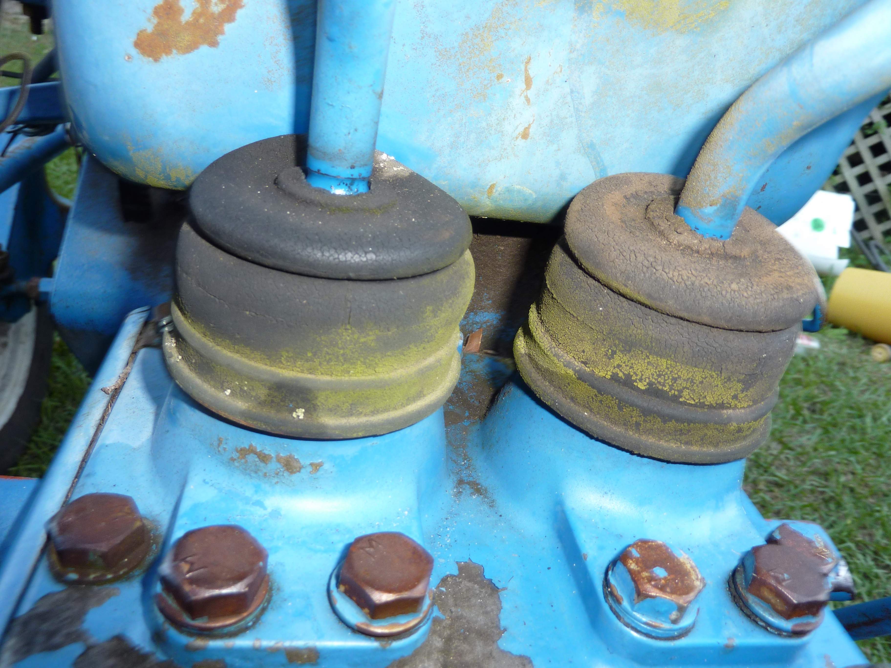

Water may leak in around that wire, can also enter thru broken insulation in wire, I would clean and seal both with black silicon. How is the shifter boot and any other seals?

i checked them out as well. both boots are tight. there is nothing anywere that i can find that would permit 3 xtra gals of fluid get in there. and certainly not in a 6 month period of time. not even sittin out in constant rain.
