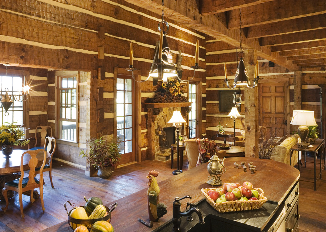

I'm in the early stage of converting my shop into a Great Room. It's 24x30 with 12 foot walls. The way things get done around here, it's probably a 2 year project, so I'm not in a rush for this, but I want to finish the interior walls with flat, live edge pine logs from my land and chink between them so you can still see some of the edge of the log.
I plan on hiring a sawmill to come out to my place and cut them here. Then I will store them in my haybarn, which I'm going to build when I'm done with my equipment shed. The slabs will be 16 feet long and 2 inches thick.
How long do you think that they will need to dry before they can be installed? What would happen if they where installed before they where dry? What issues or concerns should I have about doing something like this? Is 2 inches a realistic thickness?
I really like the look in this picture from the Permachink website and want my home to look like this.

I think that will look great. I think 2" is overkill as it's strictly cosmetic. 1" or 1.5" would suffice and you'd get more planks from the trees.

You won't get that hand hewn look in the picture from a sawmill cut, but it certainly will still look beautiful.
Would be best if you can get it cut with a circular blade, rather than a band saw mill.

Live edge or rough hewn?
The picture (which looks beautiful) appears to be rough hewn, not live edge. I may be mistaken, but I think that's the terminology. Live edge hasn't been touched by tooling, while rough hewn has. Anyhow...

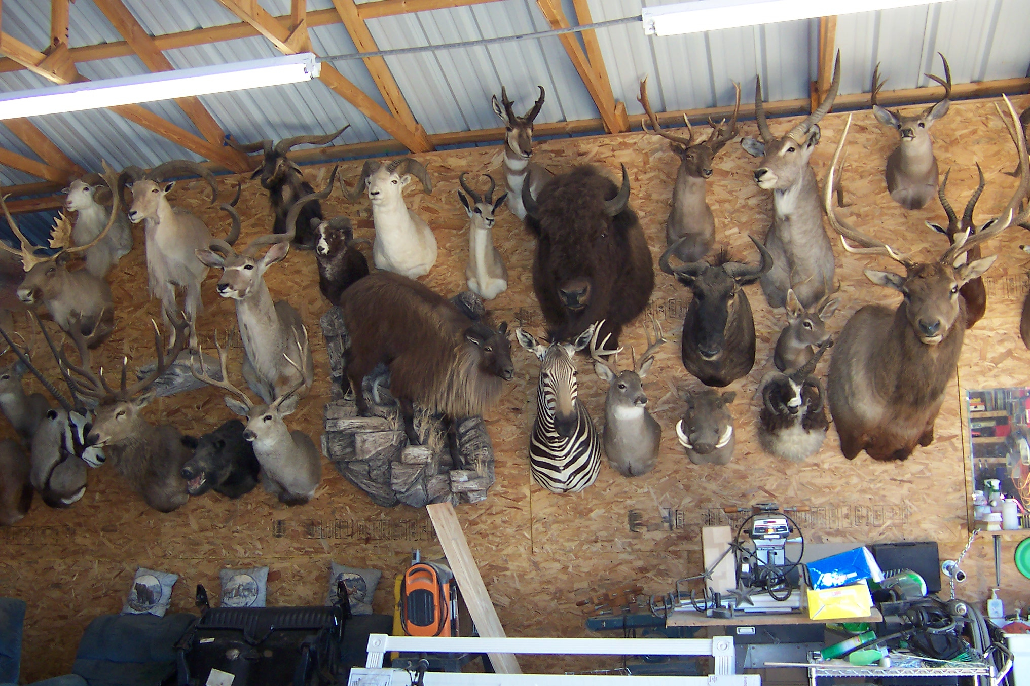

Thank you. My ultimate goal is to be able to have my taxidermy mounts on the wall. I want the slabs to be thick enough to be able to hold the weight of my heaviest mounts. Another concern is being able to adjust them on the wall if I ever get any more. My big dream is to one day have an Alaskan Moose on the wall, which would mean that whatever is up there would have to be moved to accommodate the size of a moose. This is why I was thinking 2 inches. I could probably get away with an inch and a half, but I don't think anything less would work.
I have a lot of pine trees that I want to remove. If I get four slabs out of each length of tree, that would be ideal. I'm thinking that I'll cut each tree into 16 foot lengths and then get four slabs from the center part of the log. I want to see part of the edge of the long when it's on the wall, but fill in the gaps with chinking of some kind. Maybe an inch of the live edge exposed and the chinking would be an inch thick?
I'm torn on what I want the finished slab to look like. Chainsaw marks might add a lot of character to it. A smooth, cabinet finish might look nice too. But in my mind, I'm thinking that a combination of both some distressed, cutting marks and some smooth finished areas would look the nicest.
I still have plenty of time and lots of pictures to look at. There is a point where it needs to get done and if I over complicate it too much, it will never get done.
This is part of my collection. I forget how many I have, I'm guessing it's somewhere close to 40 mounts. This is inside my shop, which is the room that I will be converting into my new living room. The walls are 12 feet tall, and what I want to cover in the live edge slabs to look like an Old Kentucky Log Home, or something you might find in the Rocky Mountains.

Since you know what you want the walls for, have you thought about reinforcing a section of the actual wall for your eventual prize moose? It might simplify things when the time comes. (2x6, or 4x4 running along at the height(s) you want your trophies mounted at?)
