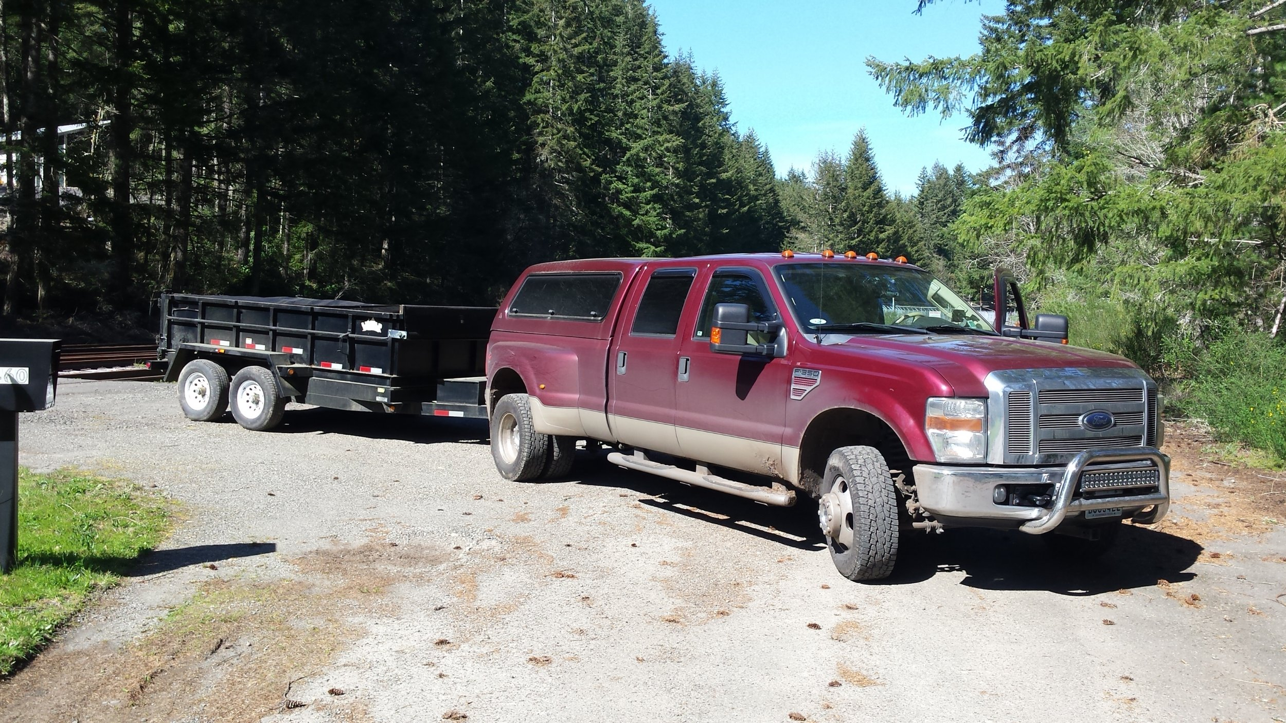

IMHO Your struggle with this is just you proving to yourself you don't have enough truck under that trailer. I have a 6X10 10k deckover on a F350 and I don't like anything past 4.5k lb in it. 3 tons is a lot of load for a car with a 4x8 shopping basket behind the seat! If you put load cells under every tire truck and trailer and load it with a coffee cup, planning where every pound is placed your still going to feel like jelly on the road with 7 to 8k in tow. That may be fine if the rig stays off the interstate at or under 30 mph but at 60 and a need for even mild corrective action, the trailer will be in control! Good luck stay safe and go get an old 1 ton. You will suddenly be very happy to feel the "forward bias" That the guy in the wheel loader knows you need!

IMHO Your struggle with this is just you proving to yourself you don't have enough truck under that trailer. I have a 6X10 10k deckover on a F350 and I don't like anything past 4.5k lb in it. 3 yards of what? some soils can get close to 2.5k lb, gravel 3.5k per "true yard" LOL. Thats a lot of load for a car with a 4x8 shopping basket behind the seat! If you put load cells under every tire truck and trailer and load it with a coffee cup, planning where every pound is placed your still going to feel like jelly on the road with 7 to 8k in tow. That may be fine if the rig stays off the interstate at or under 30 mph but at 60 and a need for even mild corrective action The trailer will be in control! Good luck stay safe and go get an old 1 ton. You will suddenly be very happy to feel the "forward bias" That the guy in the wheel loader knows you need!
