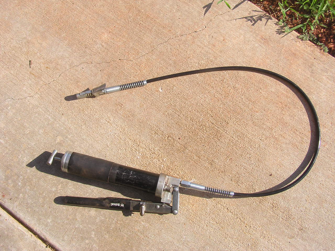

This is my post from early in the thread:

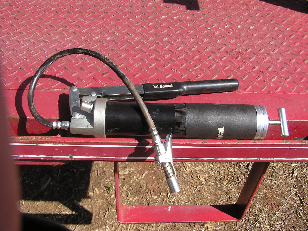

I am real happy with my LockNLube Grease Coupler.
I put it on the lever action, removed the steel tube and used a hose.
View attachment 371813 View attachment 371814
You normally don't have a hose on a lever style, because it would require 3 hands to use it. This way I have more flexibility and only need two hands.
And now it has a 4 foot long hose on it:
The coupler is still working good after 6 years :thumbsup:
