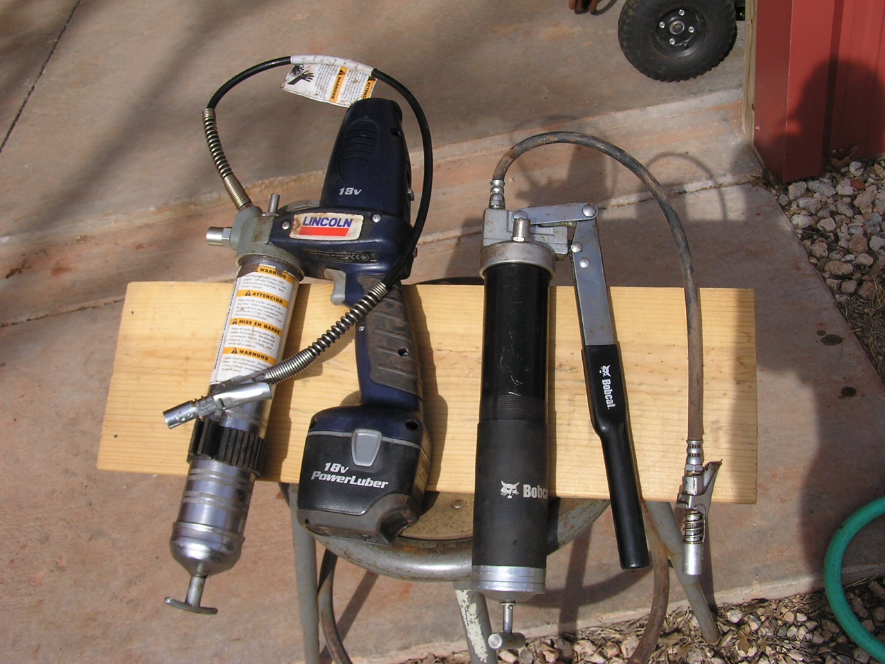

I was so impressed with the way the LockNLube coupler worked and made greasing easier and faster, 5 years ago I paid another $30 for another one to put on the Lincoln:
