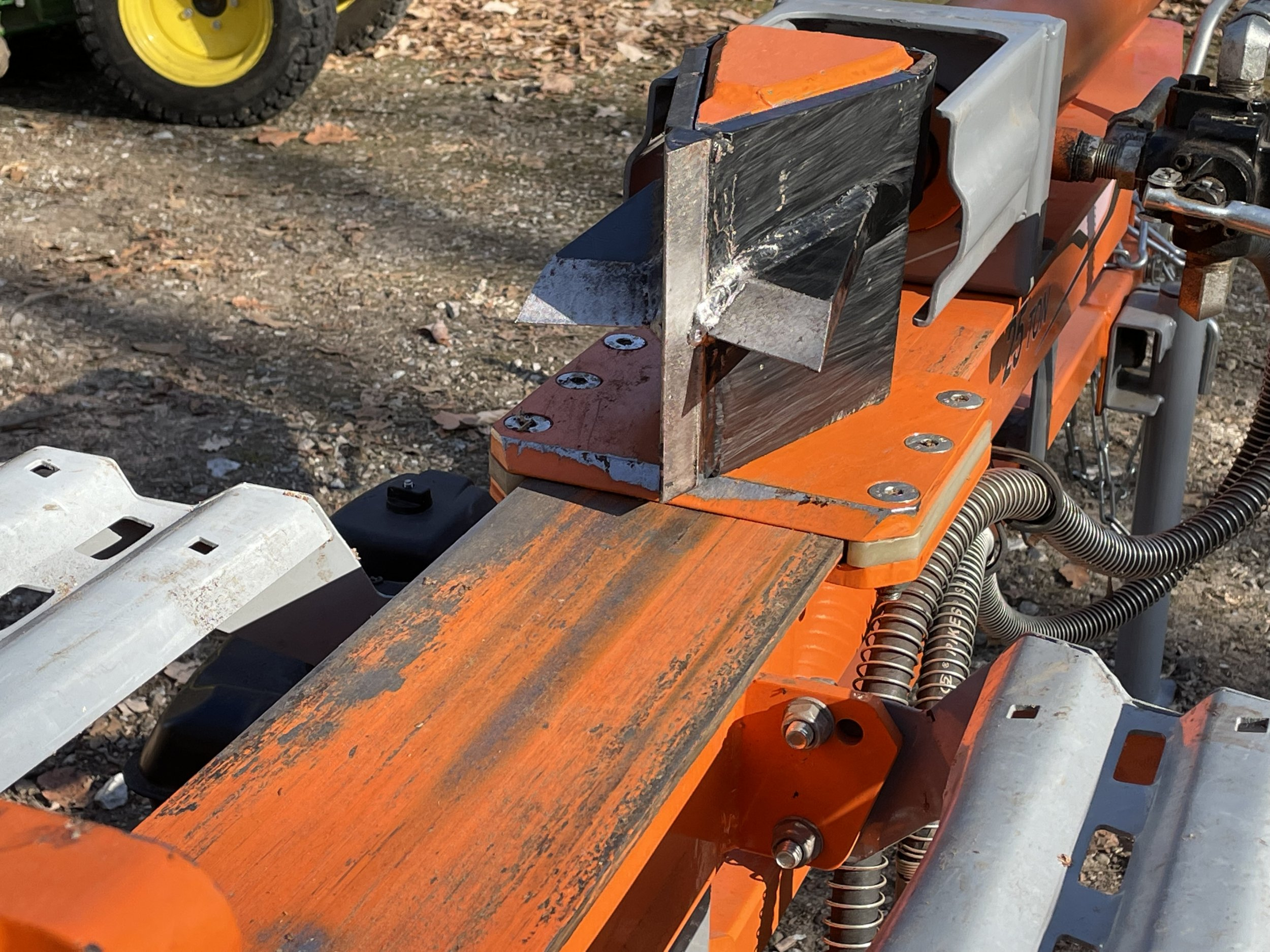

Looks alot like mine. No handle, I just grab the wings for my handle
   / Log splitter 4 point wedge #52
I posted a pic of mine in post #7. I made it so the wings are set for the "ideal" size firewood.
That is my wings are 5" high. So a perfect 4 even splits would with a 10" round.
Not all pieces have to be perfect.....8"-12" rounds work out really well with my 4-way.
But what about a 7" round? Something that "without" a 4-way I'd only split in half. But with a 4-way on that would result in the two lower pieces being about perfect.....but the top two being little 2" splints.
Or what about a 13" piece.
Bottom two would be idea but the two coming off the top would really need busted again. So the odd-shaped piece going through the 4-way again....odds are one or two of the pieces would be a little splint.
Im happy a fixed 4-way works for some. For me I like to minimize waste. Im not burning. Im selling. And customers like a nice stack of firewood that handles well, and stacks well. Not a bunch of stuff that ranges from pieces too big to grasp by end with one hand down to tiny splints.
Then when you get down to some nasty crotch pieces, or stuff that had some limbs coming off at odd angles....no way would I want to be stuck with a fixed wedge. I simply found a better way to make mine simply drop on and off.
I just cant believe that anyone with a fixed wedge and has split dozens of cords of wood has never ran across circumstances where they though it would be nice if the wings werent on for this piece.
Obviously an adjustable wedge would be even better. But we all gotta draw the line somewhere right? Because if we didnt, we'd all own $50k processors.
When you talk about a "fixed 4-way wedge" are you talking about one that is bolted or welded on to the splitter, or are you talking about one that is easily removable with no tools required, but is not adjustable in height?
There is no way I'd want one that is bolted or welded in place, but I would not want to be without my removable 4 way wedge. I drop it on when the situation calls for it, and pull it off when it doesn't. I do try to stage my rounds in such a way that I'm not having to switch back and forth every couple of splits.

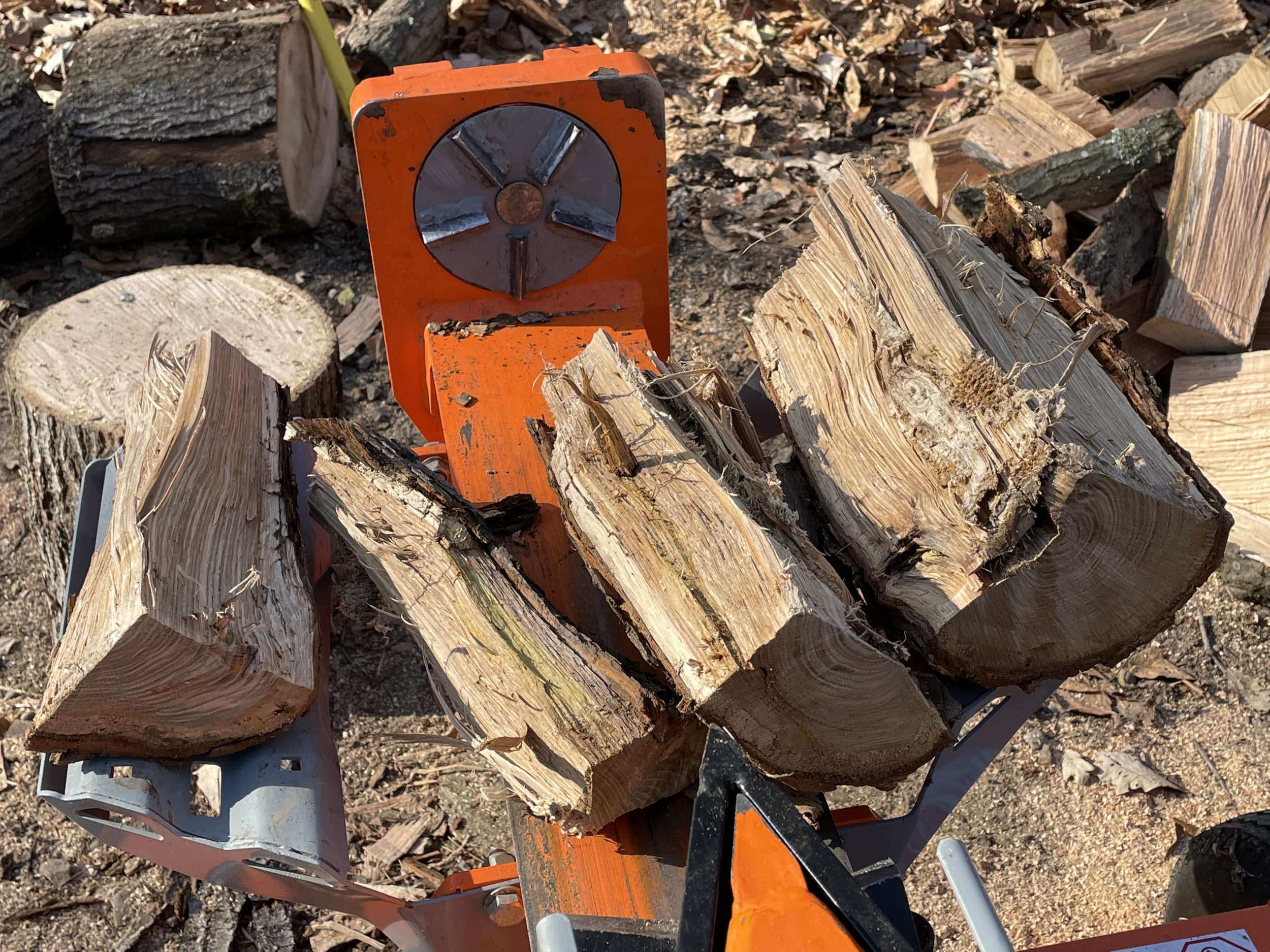

I attached a picture of mine and one showing the splits. The round was roughly 9” and two of the pieces are perfect for me, one is to small, and one to big. Not a big deal, close enough, but if the round is bigger or smaller, not so good. Once again not a big deal as the 4 way just drops on mine and comes off with no tools.

   / Log splitter 4 point wedge #55
You mentioned in another post that you thought your horizontal wedge sat too low, making th bottom splits too small. That one looks pretty good to me. My original 4-way wedge split a bit larger than that: about half way up a 10" high vertical wedge. I had the factory make me another that was about an inch lower. I get a bunch that are about 3.5"-4" through the bottom, and the top varies depending on my log size.
I do tend to split smaller than some people. Smaller chunks burn more efficiently (though I do realize that maximizing efficiency is not everyone's sole goal: There is a balance with efficiency of burn and making efficient use of your splitting labor. Size also affects how frequently you have to load. Also, the bigger chunks are more likely to last through the night.)

   / Log splitter 4 point wedge #58
Your correct, it sits a little higher than I remember. It’s definitely quicker having the 4 way if the round is the right size. I may experiment with it a little more.
