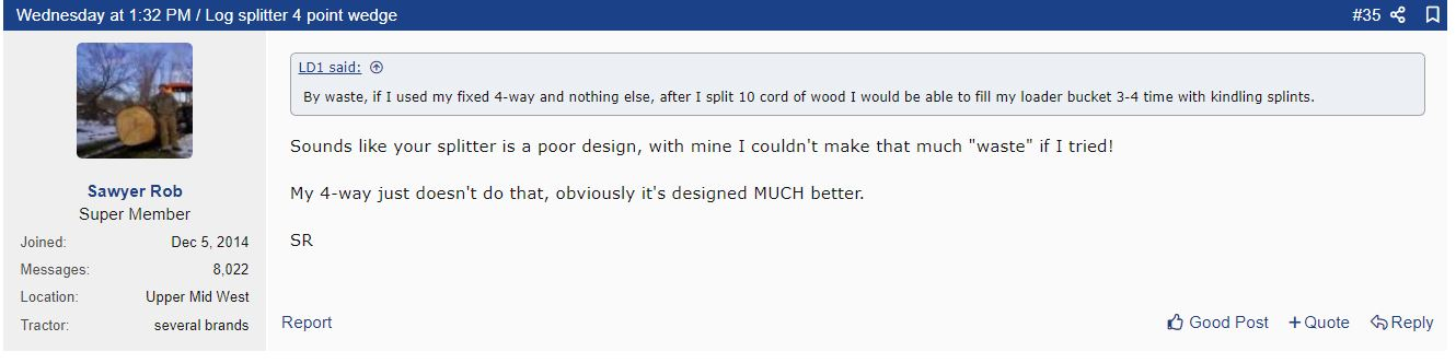

YOU are the one that said my splitter was of poor design. So when I paraphrase what you said, you deem that condescending?? And you are the ONLY one on this thread that doesnt seem to generate undesirable splits with you 4-way that you run everything through. And thats fine, it works for you and thats all that matters.
I didn't think I said your splitter is a poor design, I said your 4-way is a poor design and it is! lol IF, it works like YOU say it does!
Also, I told how MY 4-way works, but you can't accept that. So, yours don't work, and mine does, so all I'm left with is, design issues with the one that doesn't work.
I guess it could be that you want pretty splits, so they sell better?? I don't care how mine look, as long as they fit my stove and burn...
That's it in a nutshell, time to move on...
SR
Just to set the record straight.
But agree, time to move on. We all have our own methods that we have modified, improved upon, and taylored to suite our needs.
Yes I sell wood, and yes customers want "pretty" wood that stacks nice and not a bunch of trash and uneven splits and kindling left behind.
My operation has me handling wood ONE and ONLY one time with my bare hands. Thats when I pick a round to put on the splitting table. Its efficient for me. All other times it is handle in mass by equipment
