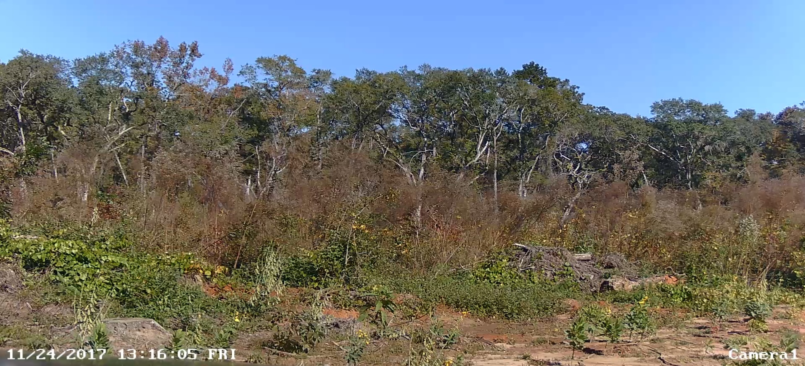

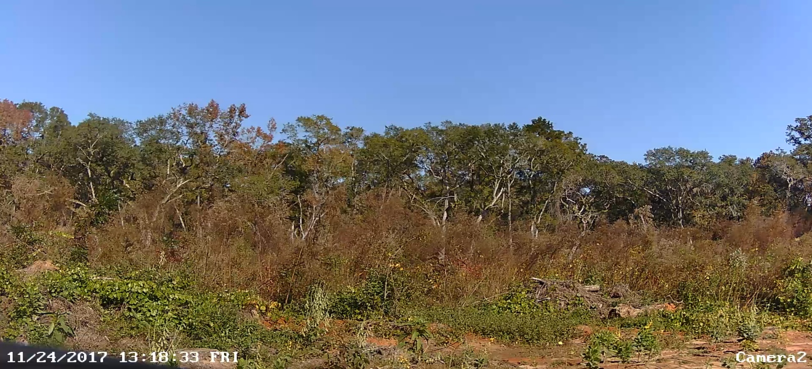

I have spent a good part of today fine tuning to get a decent image. I found the default settings to be blurry and not the quality I was wanting. Setting video encoding to 1080P @ 30 fps has resulted in an acceptable quality. It is NOT 1080P quality but the best I've come up with so far.

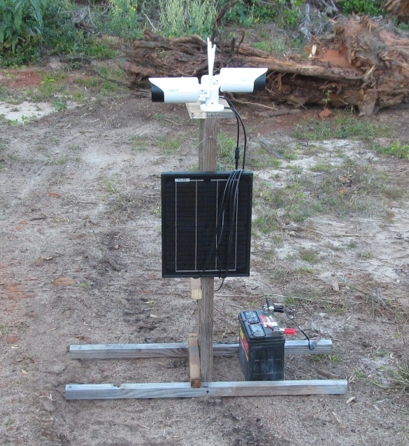

Here are a couple of screen shots from the browser interface. I have the cameras powered by and inverter and sitting on the dash of my truck approximately 360 ft from my AR-GL300 EXT router in a pretty much direct line of site. I have connected to this router with other devices from 450 ft and not a direct line of site. My next move is to make a stand and connect them to a 12v battery with a solar panel to keep it charged. This way I can move it around on the property as long as it stays in range.

Here is what I threw together to place them for now.
