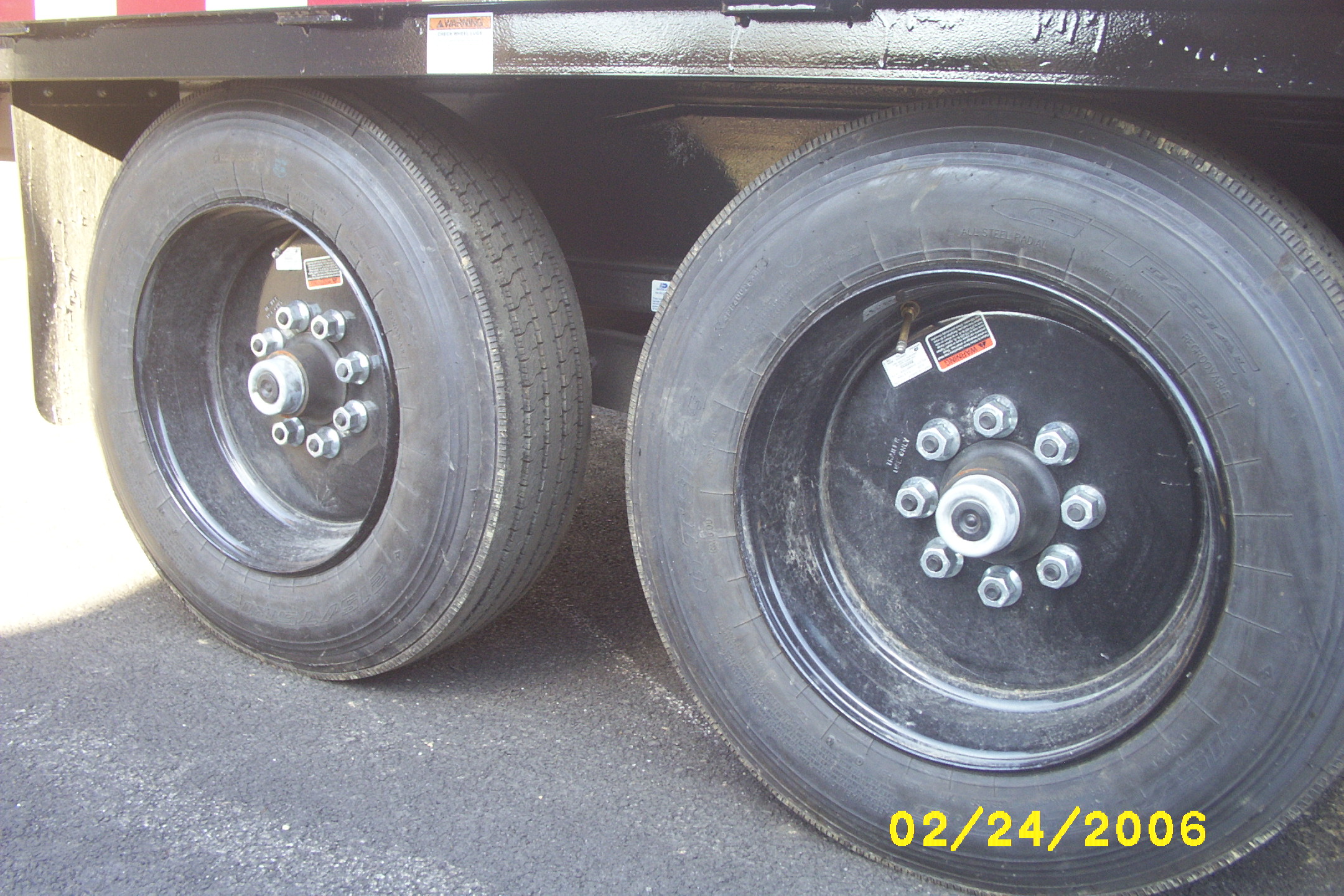

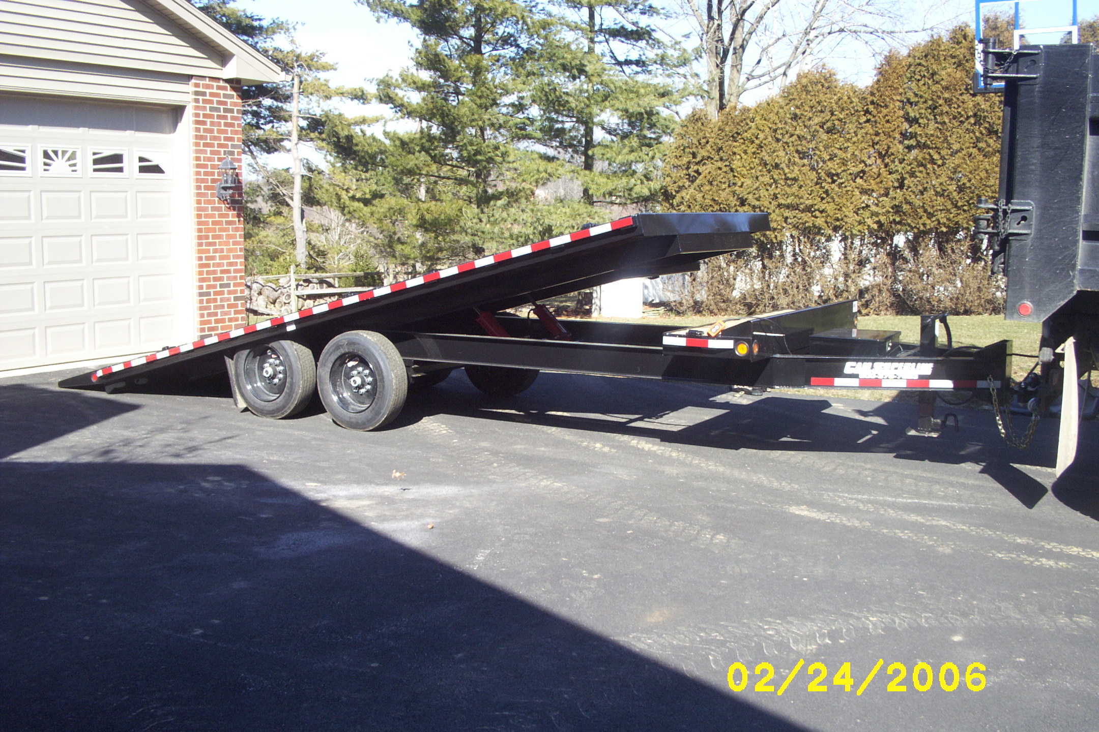

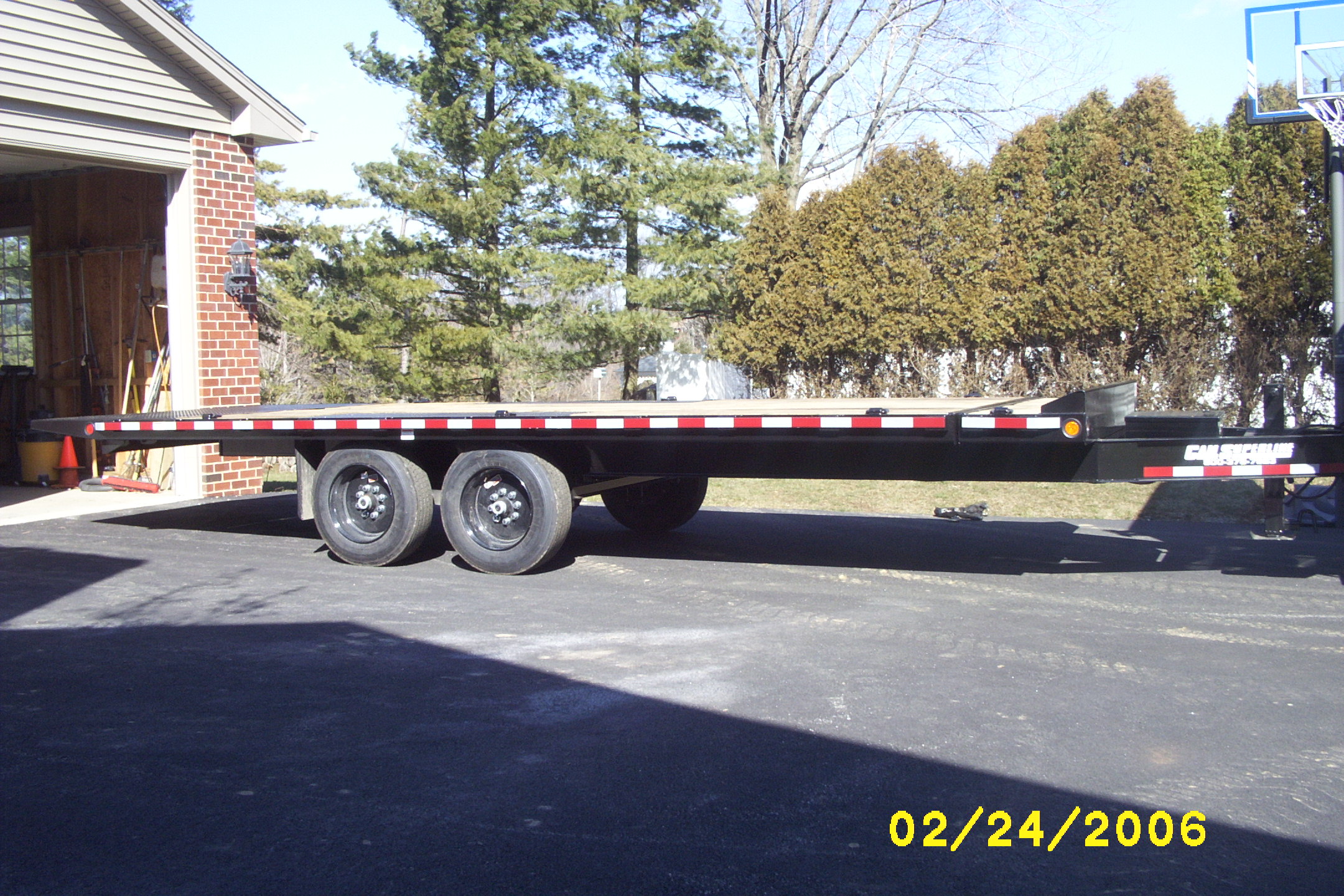

My Cam Superliner tilt was a nice trailer. Good thick paint, good wiring, heavy built, Dexter axles, wheels & brakes. No poster sized decals on the sides. :rolleyes: Company builds trailers in PA.
Look into them. Here's my 18,900 GVWR trailer.

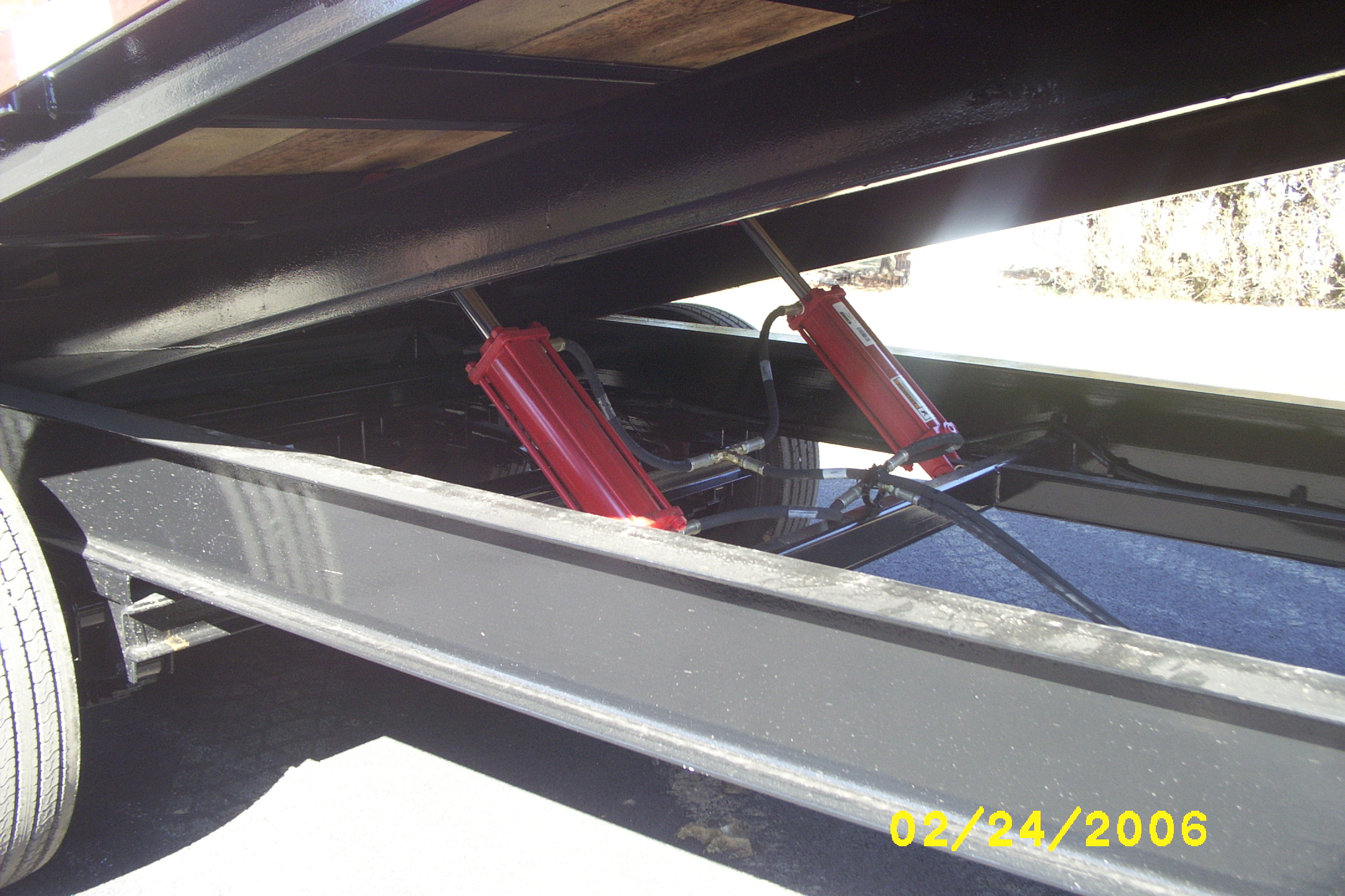

thats a great looking trailer how do you loke the twin hydrolics ? do you like that better than the air cylinder you see in most?
/ looking for a good tilt #6
I thought that's the only way they came? You mean someone uses a single cylinder?
Over here you see a lot of trailers with a single pump/cylinder unit mounted to the towbar, a pimp/cylinder unit as used in Chinese engine shoplifts.
I made my brother one with two cylinders right in front of the tandem, with the hinge right behind the tandem. This way they allways put an even load to the bed frame, not to the towbar.

More pics of CAM Superline for O/P

Builder, are those 8K axles with 17.5 rims/tires on your Superline? If so they must be figuring 2,900 lbs of the total GVW is allocated to the hitch.
I would like to get a trailer set up like that with 8K axles but rated at 16K total. Did you purchase the CAM Superline new from a dealer in PA? If so, can you recommend a dealer in eastern or central PA?

The paint looks like it has a lot of runs in it, especailly in the last picture. How has the paint held up?
