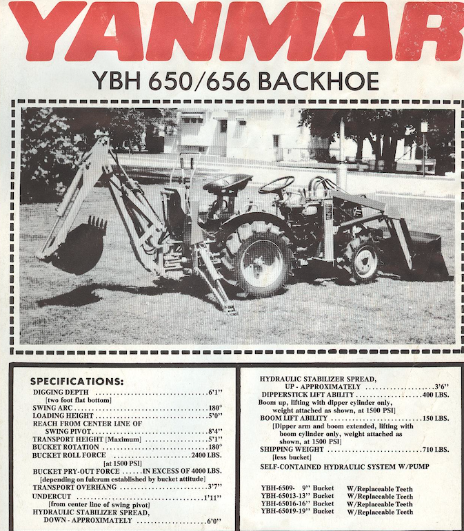

We didn't always have a nice Kubota M59. For 40 years we used this old 3pt hoe for all our digging. I think I bought it used for about $1000 and sold it 40 years later for $800. It never needed anything.
