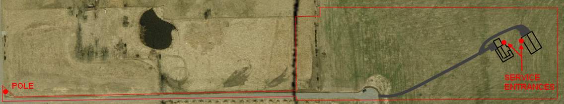

I'll be doing this same project in a few weeks, going 2000' from the road to a pad mount transformer for a new house and barn. I dig the 48" deep trench and the rural electric company takes care of everything else (conduit, junctions boxes, etc.). Luckily, I'll mostly be going through top soil (northeast OK).
It'll run from the pole at the county road, along the north side of the driveway easement, but then what? I'll also be running water along the same length, with 1' horizontal and vertical separation requirements. I'll put the electric trench closest to the driveway and the water line trench just north of that.
My question is, I've got the choice where the transformer will be, just a minimum of 15' and maximum of 200' from the structures. Where should I put it? Should I stick it between the house and barn to minimize the secondary run or put it 100' or so away from everything?

If it were I, I'd put it in your 100' away location or similar. Transformers sometimes explode or catch on fire. It doesn't happen every day, but it does happen and I've seen transformer fires on pole units and in underground vaults happen enough that I would never want a pad-mount unit too close to anything I truly care about. If you want to see what this looks like, go to YouTube and search for transformer fires -- you'll likely see and learn more than you really wanted to know. Yes, Virginia, there are some scary things out there...

The transformers used around here to step down underground primary voltage aren't big enough to hold 50 gallons of oil even if the housings were filled with nothing else. That said, I'd be looking for 50'-75' of separation from the transformer to any structure.
