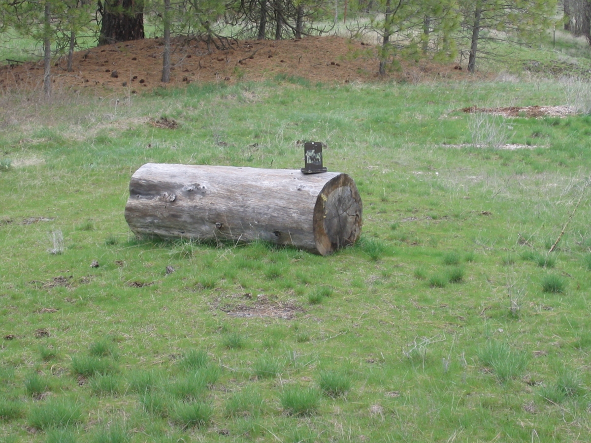

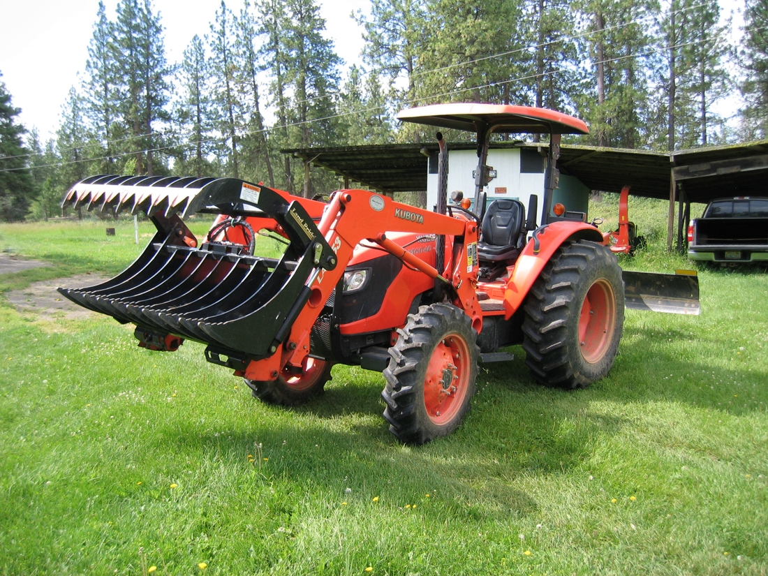

Sound like something is not set correctly. I guess all of this is one of the reason I have stayed with a geared tractor. My Kubota M6040 will easily lift a 2400# pine log with my 820# Land Pride grapple. With this load low( knuckle dragging) I can very easily, quickly move up a VERY steep slope - in 4WD.
This pine log is - 32" by 8'. I moved it to the front yard while still green - eight years ago. My log weight chart says this log weighed right at 2320# when I moved it.
View attachment 735836View attachment 735837
Oh yeah that log is tiny. No wonder she had issues with it lol. As said that isn’t a surprise it was too heavy.
