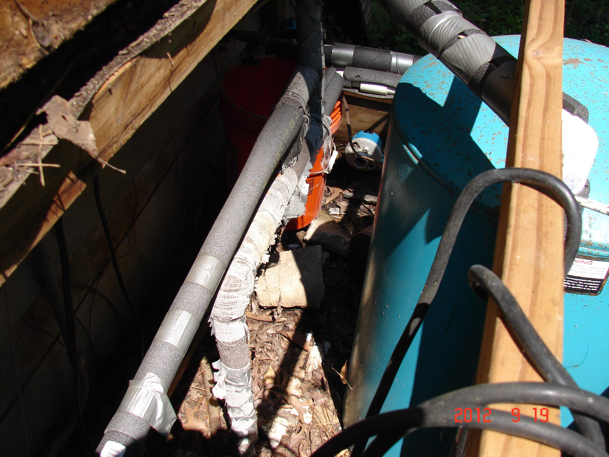

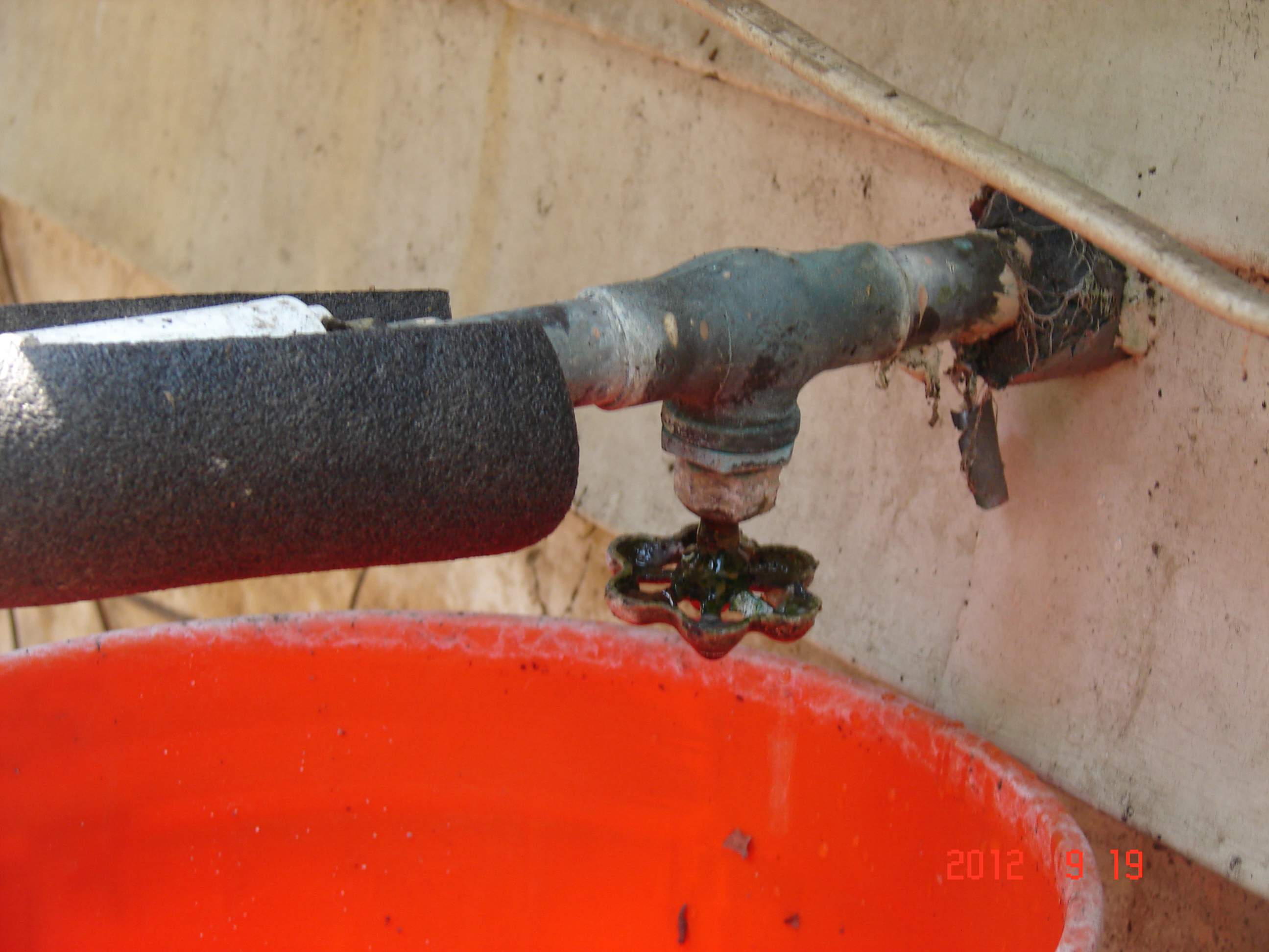

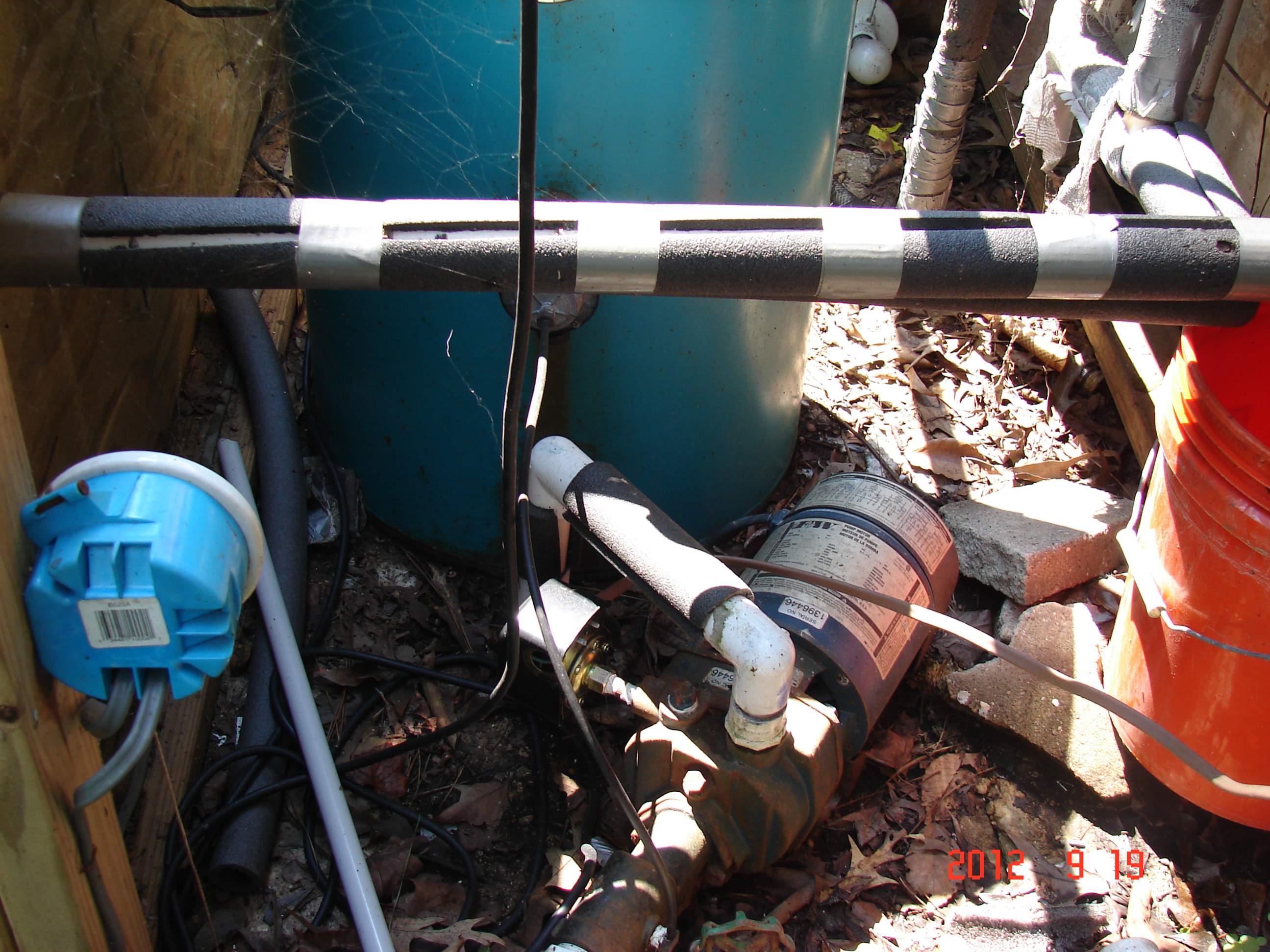

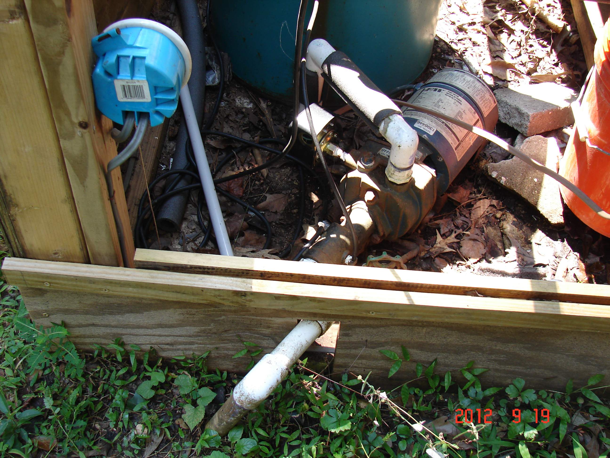

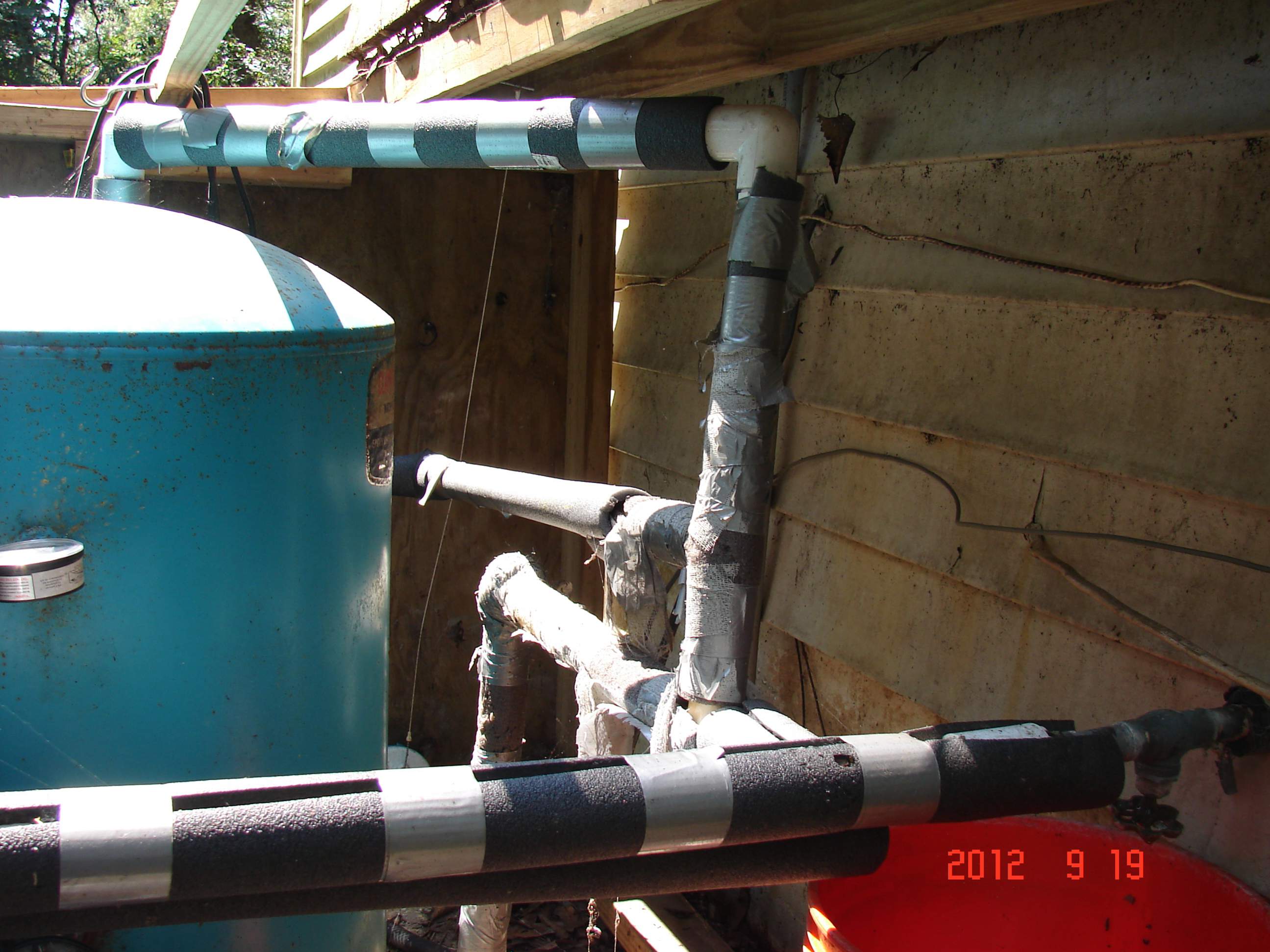

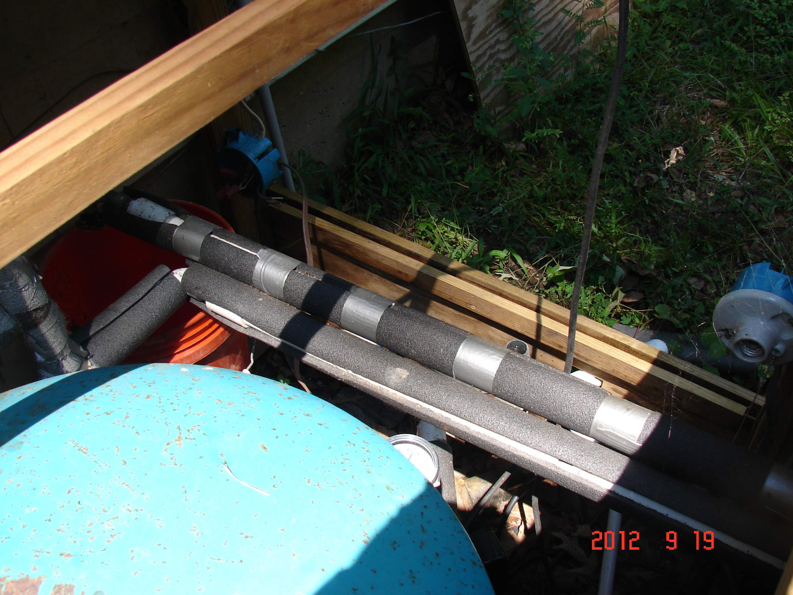

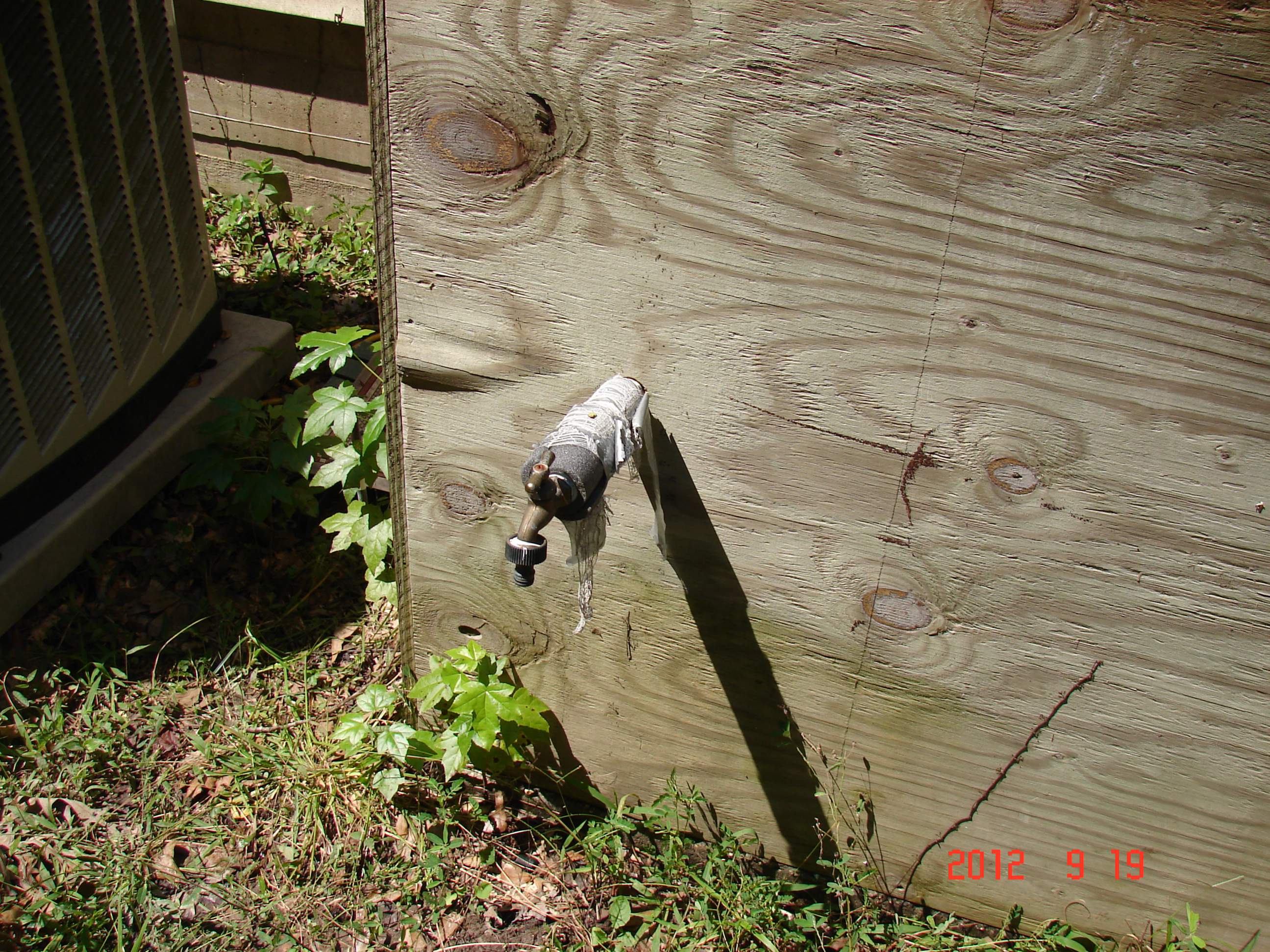

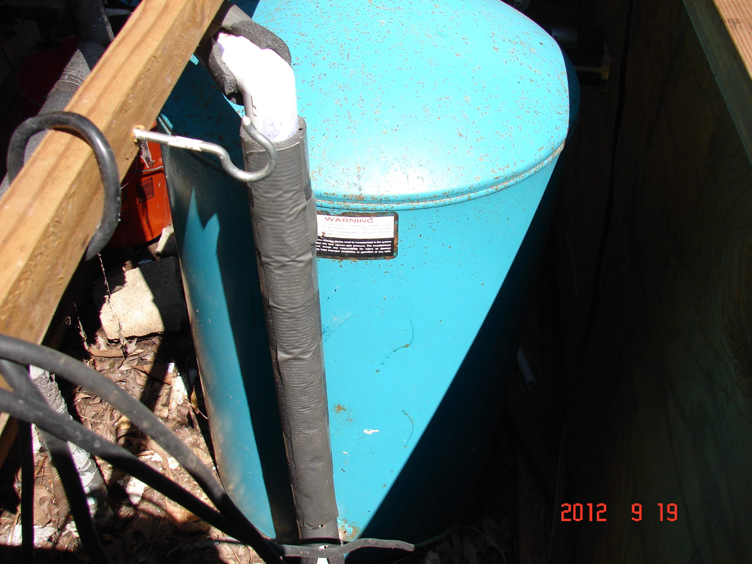

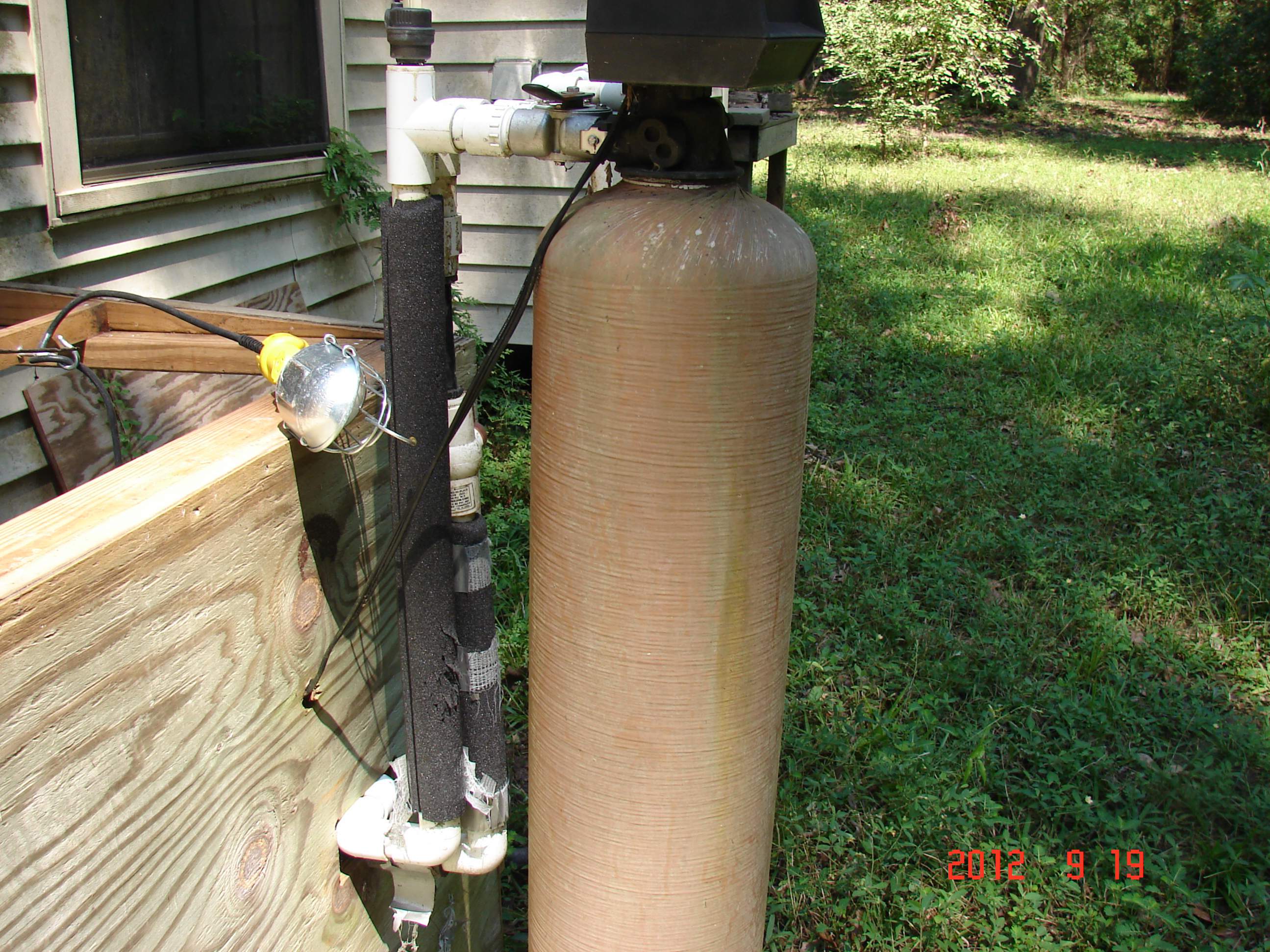

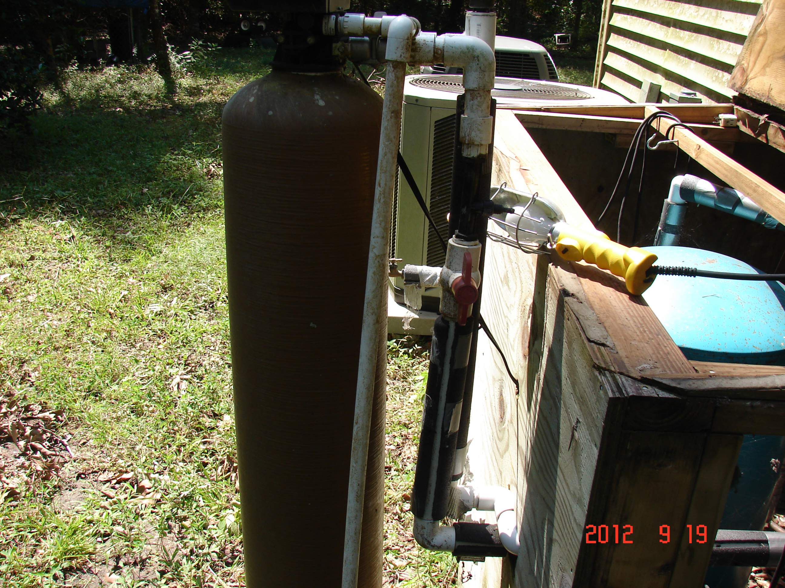

Here comes the rest . Plastic pipe is 1" . short copper with the valve is 3/4" . Note slow leak at cut off valve around shaft knob . Been there for years .DSC00010.jpgDSC00011.jpgDSC00012.jpgDSC00013.jpgDSC00014.jpgDSC00015.jpgDSC00016.jpgDSC00017.jpgDSC00018.jpg

I think EarPlug has a good suggestion in getting a pressure gauge. If you can locate a couple of different points in the line where you could attach it, you might be able to see a pressure difference occurring between two points and being at least part of the issue.
For example - the leak in that shut-off valve could indicate that there's something built up inside of there keeping it from seating properly and not leaking. And, if the pressure inside the house doesn't match the outside, it might be a good place to look.
