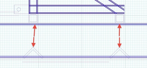

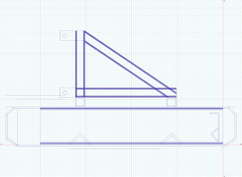

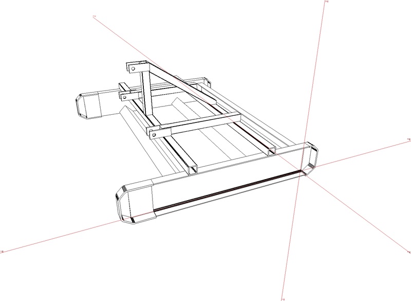

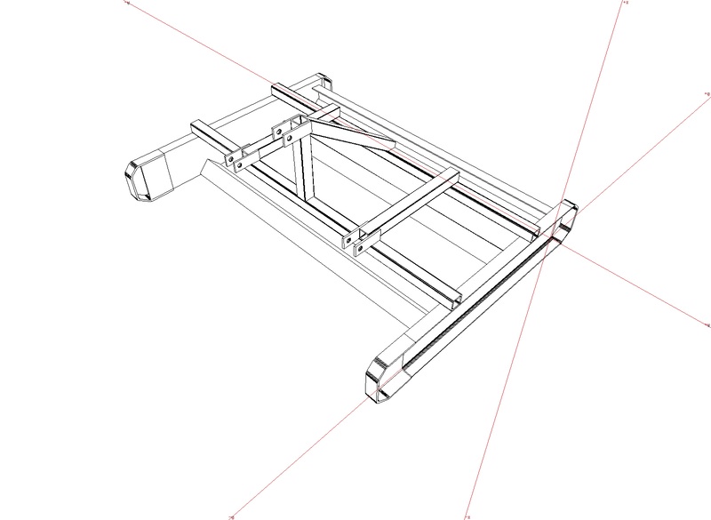

Figured I better come up with a definite plan before I get too carried away so I modeled it in formZ.
Side view in transparent wireframe:

Couple of hidden-line perspective renderings:
Some dimension info:
Overall width: 77"
Overall Length: 60 1/2"
Width inside the side plates: 72"
Length of side plate runners on ground: 54"
Setback of 3PH pins from front of frame: 15 1/2"
Setback of 3PH pins from front of side plates: 12 1/2"
Setback of first cutting edge from front of side plates: 13 1/2"
Distance of 2nd cutting behind first cutting edge: 24"
Can already see one thing I'm going to change, to shift some the weight towards the front ... :rolleyes:
   / LPGS For Kubota B2910 #45
Looks good, but is there any way you can increase this tight space everything has to pass through? Thinking of grass and other clumps, but if you use it in bare dirt or gravel it may not matter.
Bruce
Yup, sure can ... good thinking on your part ... :thumbsup:
I was trying to tie it together at common/shared points for rigidity, but offsetting it a little shouldn't matter all that much.

   / LPGS For Kubota B2910 #47
I would move both blades forward to allow clearance for trash and to allow the front blade to dig in when needed. Everything else looks okay.
That will be a hard pull for your tractor.
Say 3" mebbe ? (the little squares in the side view are 1/2")
