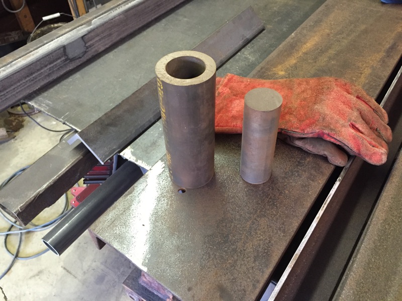

I have some 1 1/2 or 2" cold roll solid round and corresponding D.O.M. heavy wall tube/pipe that I could use for the pivots.

#64
Yup ... it's 2" ... :D
Looks like 6" of the solid and about 8" of pipe/tube:

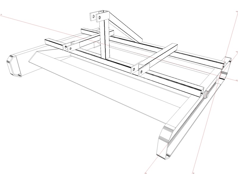

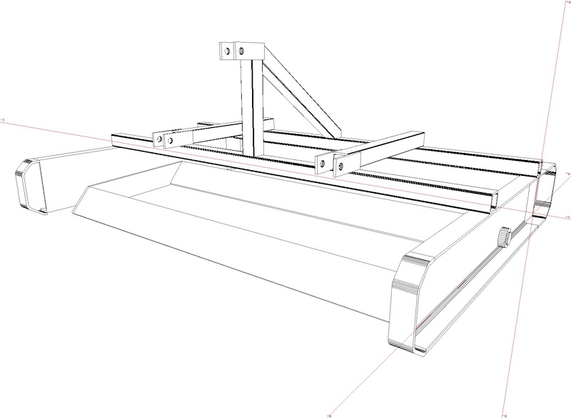

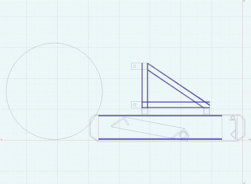

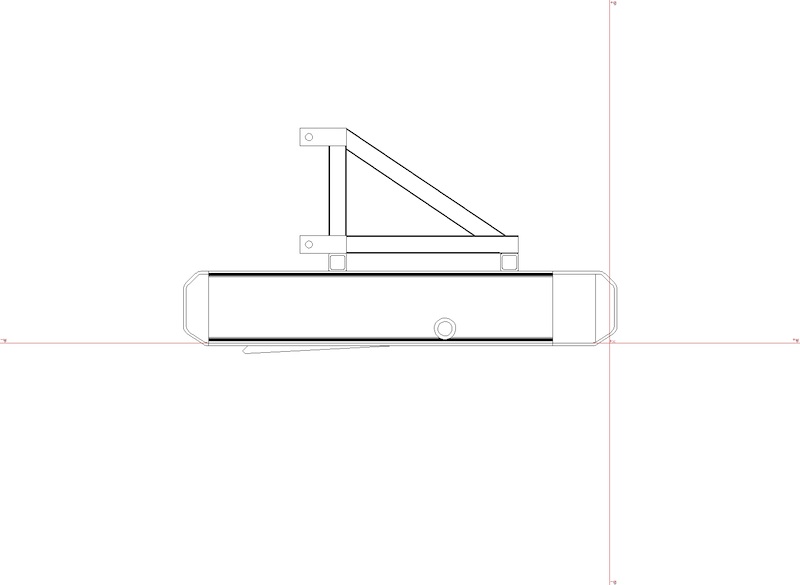

#67
Remodeled the blade carriers/cutting edge mounts to reflect the new angle iron (6" x 3 1/2" x 1/2") and modeled the connecting arms and pivot mechanism.
Wireframe image shows correct placement/distance of the 3PH frame on the LPGS to the 3PH on the tractor, circle indicates size/location of rear tire to 3PH.
Blade carrier is probably pretty close to where it ought to be, as far as tire clearance goes. Side rails could be moved forward some probably, to shift more of the weight forward:
Some hidden-line renders of the blade carrier raised and lowered. Shows a possible range of motion, although what that ultimately ends up being will depend on what I can come up with in the way of cylinders, mounting points, etc. and how it can be shoehorned in there:
