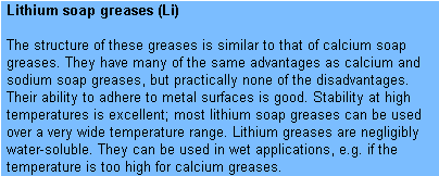

What you normally want in a grease is a lubricant that will not absorb water & has a high temperature rating so it will not break down under stress. Attached is some info I found on the net.

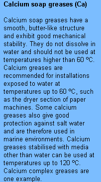

I tried putting the info all in one document but did not work. Here is some more info.

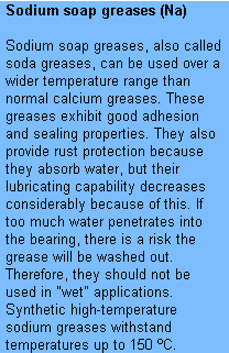

More Grease....more g.r.e.a.s.e. !!!!!

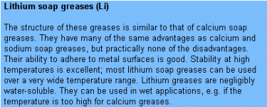

Last One.
