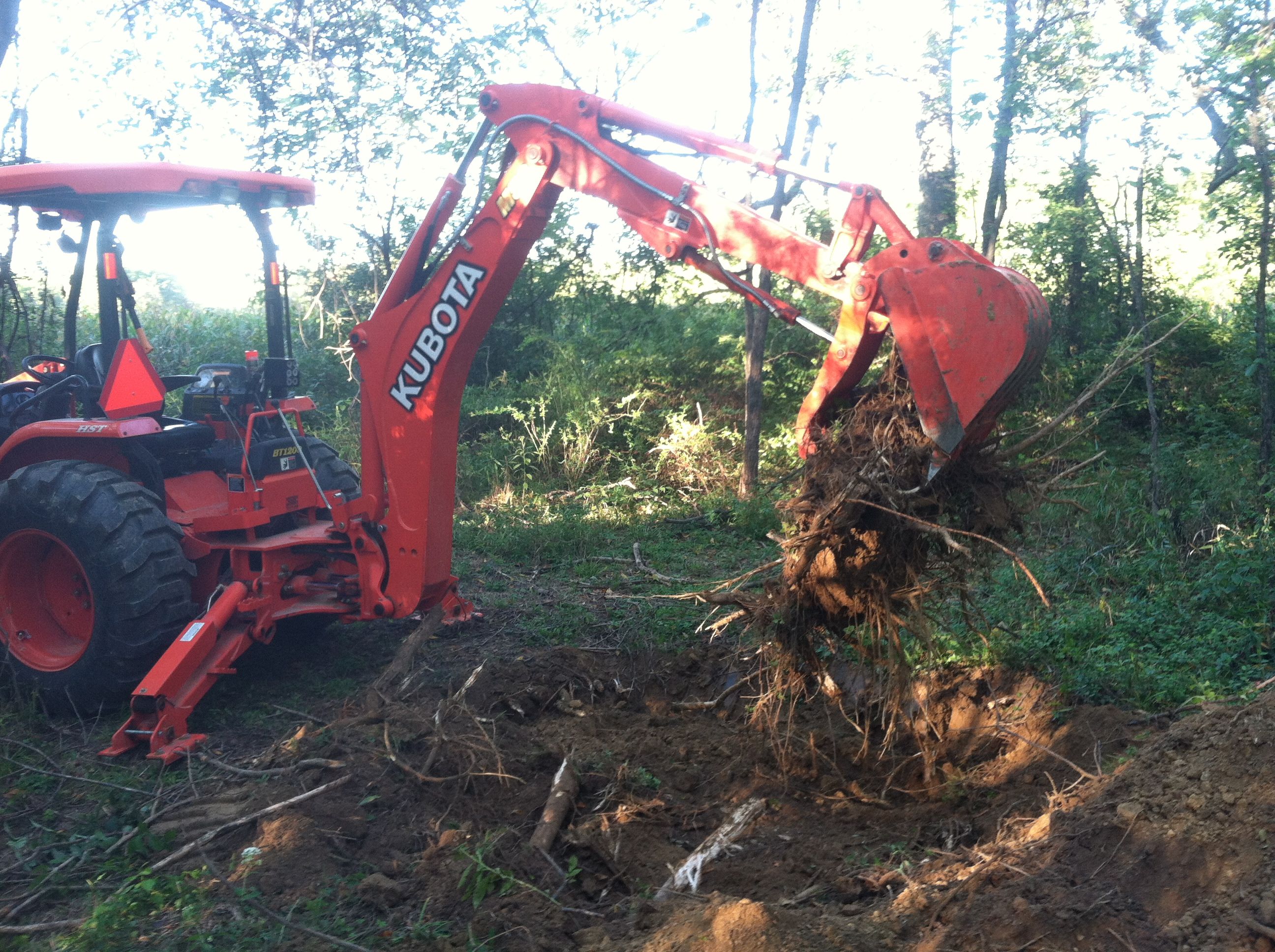

I was operting the back hoe yesterday pulling out stumps. This is fairly demanding work on the BH with a lot of stalling of the BH and going to pressure relief. IT was a cool day about 60F. I measure the sump hyd fluid temperature after running at 2000rpm for about an hour. It was 120f. I measure it at 2700rpm. After an hour it was 123F. Cooling system is working well
