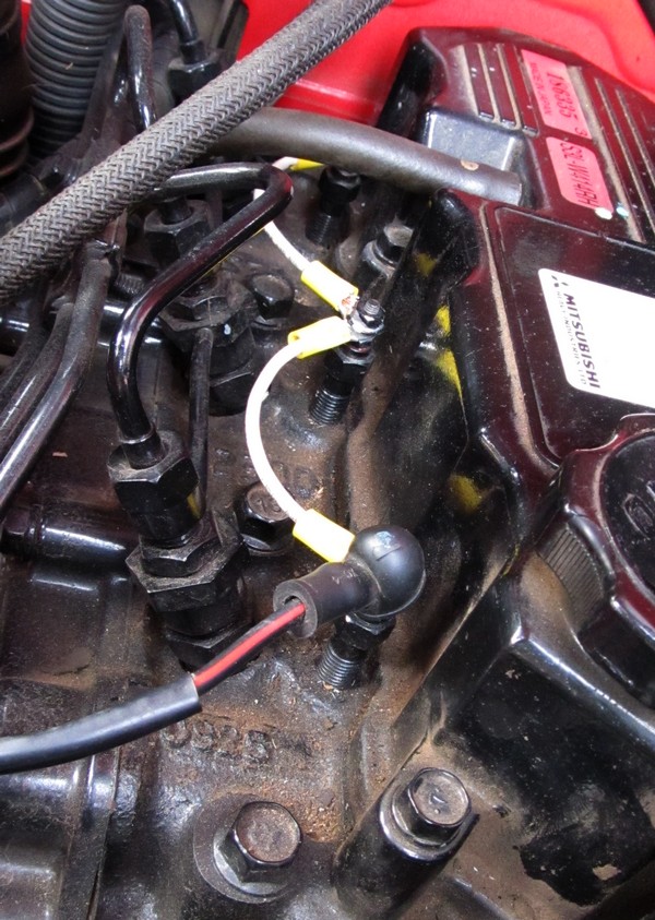

It seems like the glow plug function does not match the description in the owners manual, this is what I've found as well but I only did the test once. I may pull mine out of the garage this weekend and do the same test after letting it sit outside overnight.
I don't suppose you have tried calling Mahindra tech support to see if they have seen similar behavior?
So Like once before i let it sit 2 minutes with the ignition to run position, without GP light.
Then I turn the key to crank and it starts right up?
I did a bit of plowing cleanup with BB to charge up battery and warm motor and called it quits for tonight.
This is very weird.
So Friday, I'll try just one GP cycle and let it sit with ignition on for 2 minutes, then crank over engine to see what happens.

I was just too windy and got back late last night so I tried it tonight. 19 F and no wind.
I cycled the glow plugs 3-4 times, then crank for 5 seconds then repeated the 3 X cycle GP's two more more times. No Start.
This is very weird.
Can you confirm glow plugs on with a test light or meter,key on, no GP light?

You need to clean the ground connection were it meets the frame from the battery. Clean the connector and the frame itself with sand cloth
