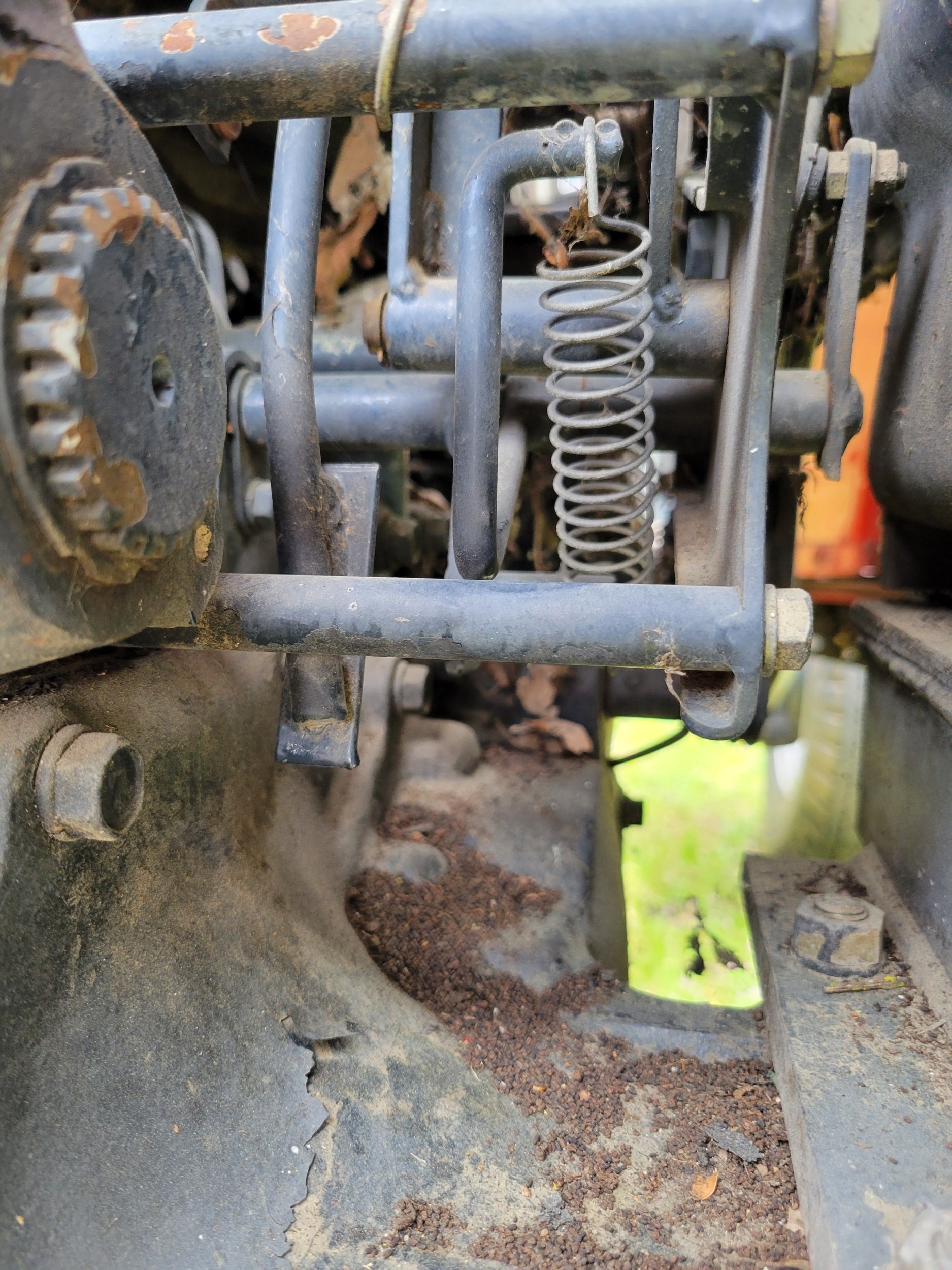

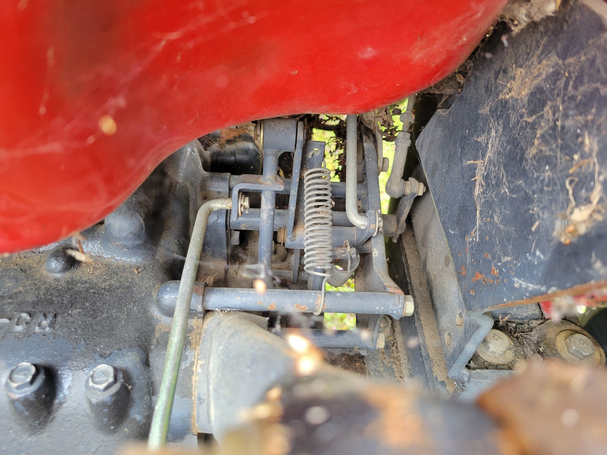

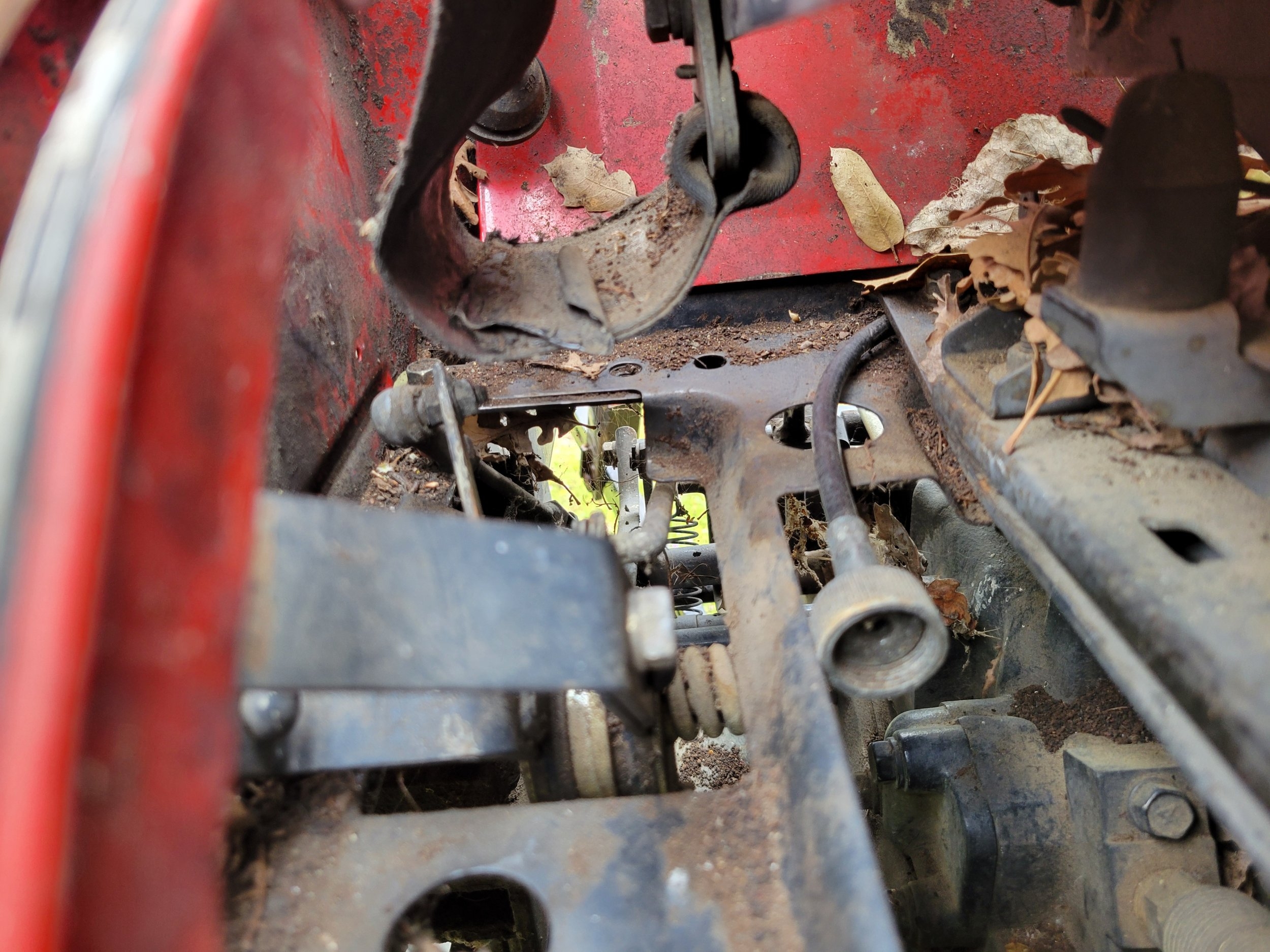

Ran it, and tried the draft and 3pt lever. It did nothing. Changed the hydro filter. Fluid was red like tranny fluid. I checked all the levers under the seat fender, nothing seems missing. There is a , like speedo/vac cable hanging there but it doesn't seem like it has anything do do with the hydraulics. It runs and drives.
Does the hydraulic pump also run through hydrostatic transmission?
Where do I check the pressure on the hydraulic pump?

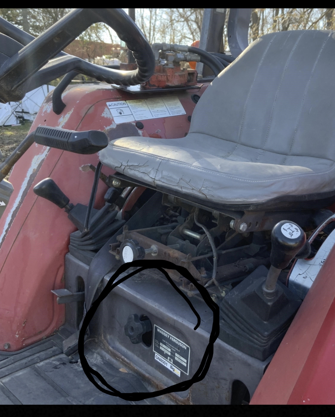

   / Mf 1260 3 point #16
It's usually right under seat sticking out unless it does not have one rod connected to a knob of some
Kind usually can see it on
   / Mf 1260 3 point
#17
AWESOME! I have that knob, lol. I'll check it out tomorrow if it quits raining. I may just have a running tractor. My poor spine will be very happy.

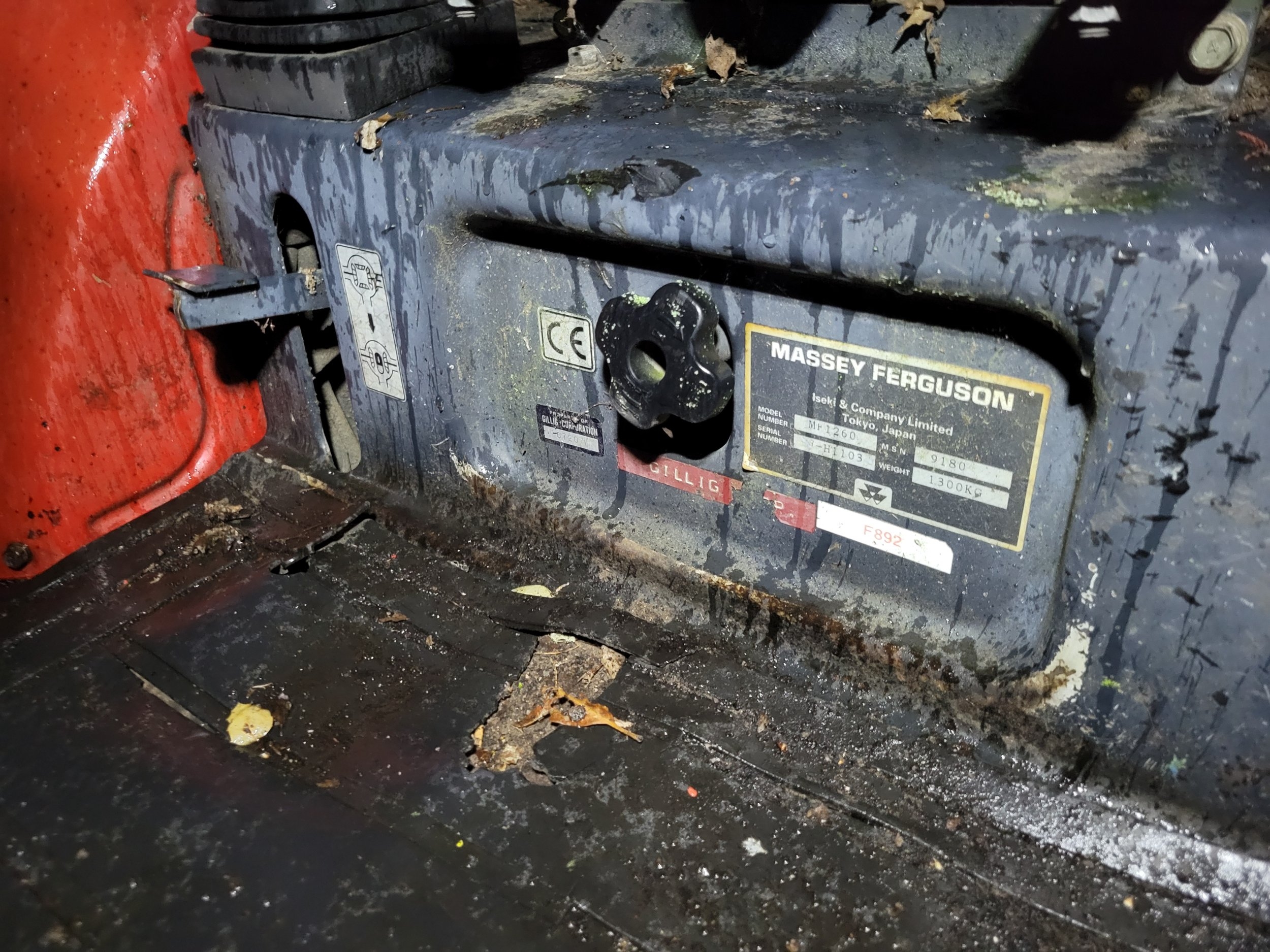

#18
My knob
   / Mf 1260 3 point #20
There is a know between your feet that adjusts the rate of drop on the 3 point. If turned all the way in I believe it will actually prevent the 3 point from lowering. The more you turn it out the faster it will lower.
