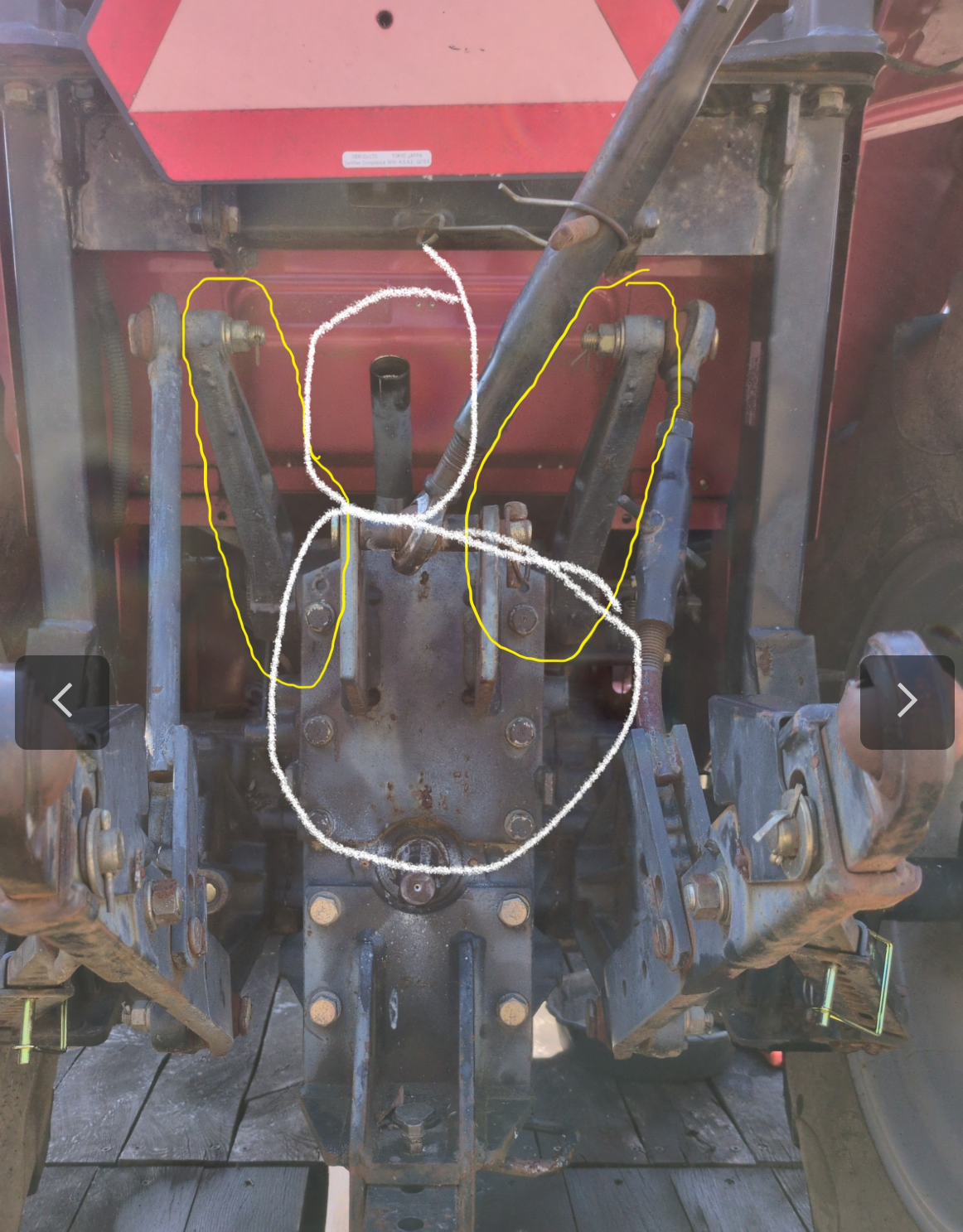

You’re missing your PTO shroud, and hydraulic fill plug, unless you just removed the plug temporarily, that could explain your milky oil.
From the photos and your issues, it looks like it’s had a pretty hard life for only 599 hours.

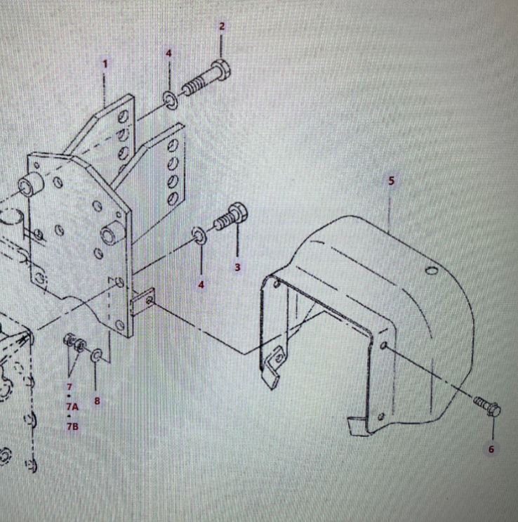

Yes, I have the plug; 'fluid change ops' were happening in that pic.
I do not have whatever would be in the lower circle. Searching AGCO online parts book, the only thing called 'shroud' is at the radiator. Any other information?
