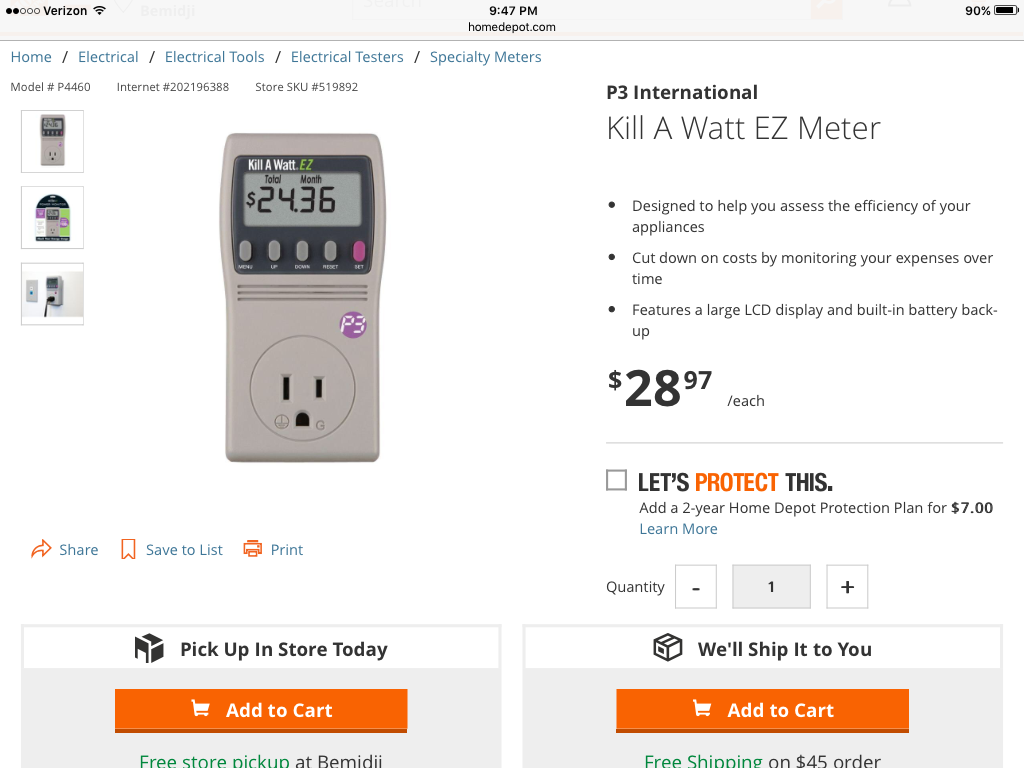

I use a Kill A Watt meter from Home Depot. About $30

I've got a killawatt & it's handy for determining power draw & pretty cheap. Will be using it as a backup frequency meter for setting the throttle on my tractor when running my PTO generator.

I wonder if that meter is important for testing home generators, or generators on a building construction site so a coffee maker will work right?
I used it on my Miller bobcat 225nt and found the idle was a little low so the Hertz was low - this incorrect output caused a small mig plugged in to behave very strange.
Miller tech support is who told me to check the Hertz when I described the problem.
