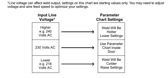

My Miller jumpers check out like that diagram, set for 200 volts. But why does it have a 200 volt setting when my house and garage has 220 incoming volts? Is 200 and 230 volts for another country maybe?
I'll try to find that online manual for JH... siries later on, be a good rainy day search. You've been great help thanks :thumbsup:
No problem, just put the jumpers on for 230 volts instead.
The service at my place is 247 volts, but further down the line at other houses it would be less.
I put my jumpers at 230 volts and just know that the settings list on my door for my millermatic 210 will actually be a little hotter than listed.
Miller even makes a note of that on my door chart.

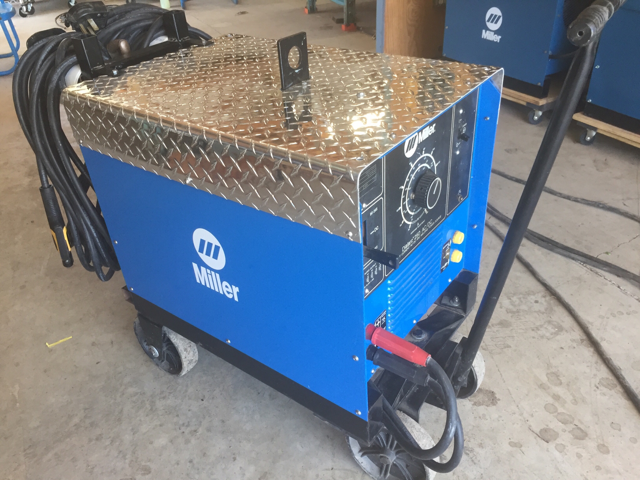

They are very simple welders. We have never found one that we couldn't fix. Basically we clean then, check and clean all connections and powder coat the sheet metal. We even have some custom diamond tread hoods we put on some. Like this:IMG_5985.JPG
   / Miller Dialarc #45
Wow, that is a nice rebuild job, it sure does looks new, what's the selling price on something like that?

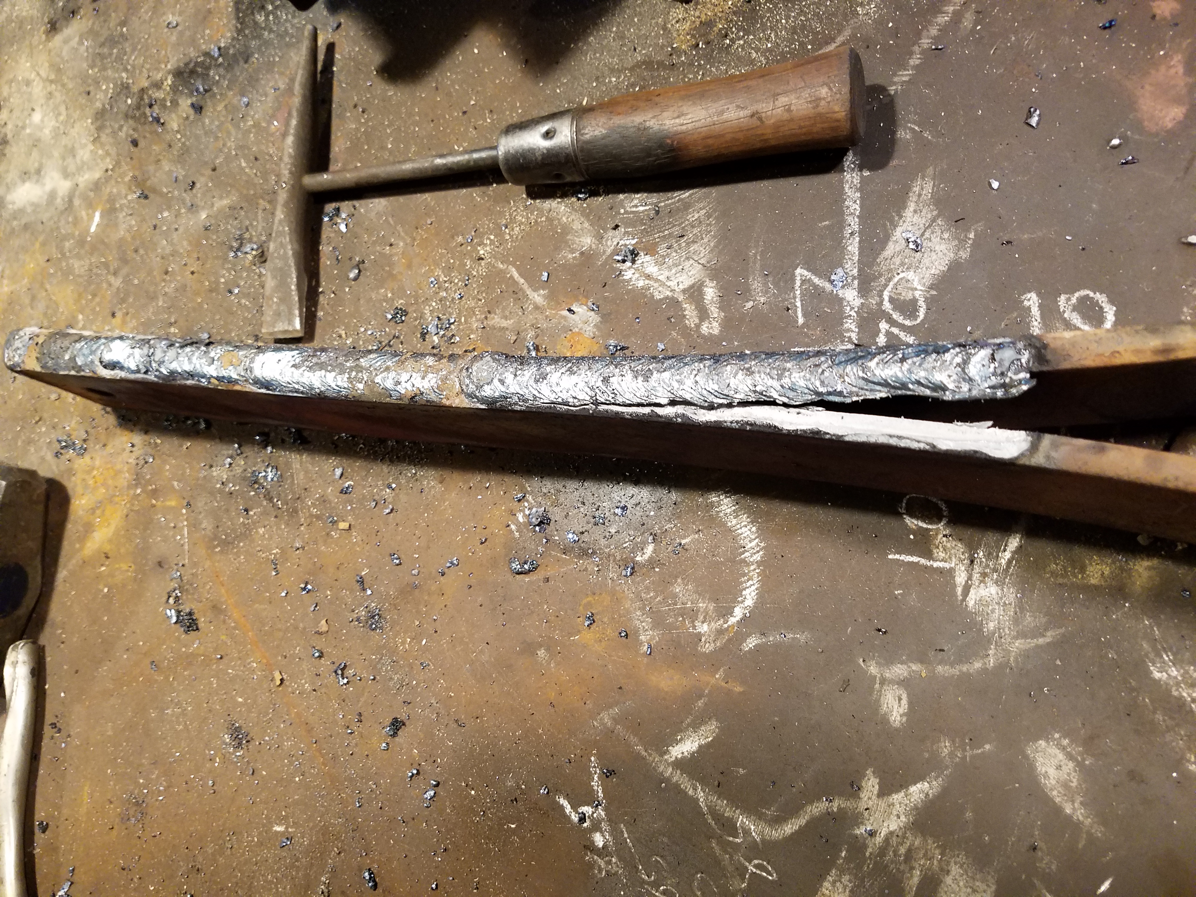

This is the first test run of the Miller Dialarc, truck springs makes pretty good scrap steel to test on. The last couple passes was in the 140/310 AC setting, dial at 60 with 3/16 6011. I took the springs out of the vise and the following night, some separation started, probably if done with 70 rod it would of stayed together.
