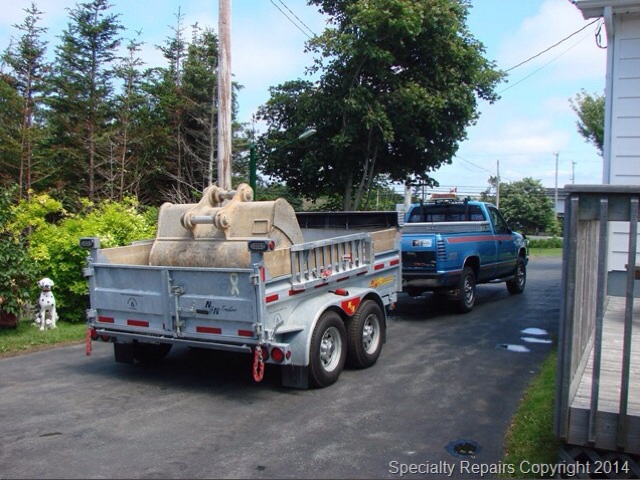

Wow. I started this thread four years ago! Where did the time go? Anyway I'm still using our 350P and it's worked flawlessly in the four years we've had it. Just last week I did a pile of welding on a bucket for a Cat 320 excavator and the 350P saved me a pile of time doing it.
Really pleased we bought it.
