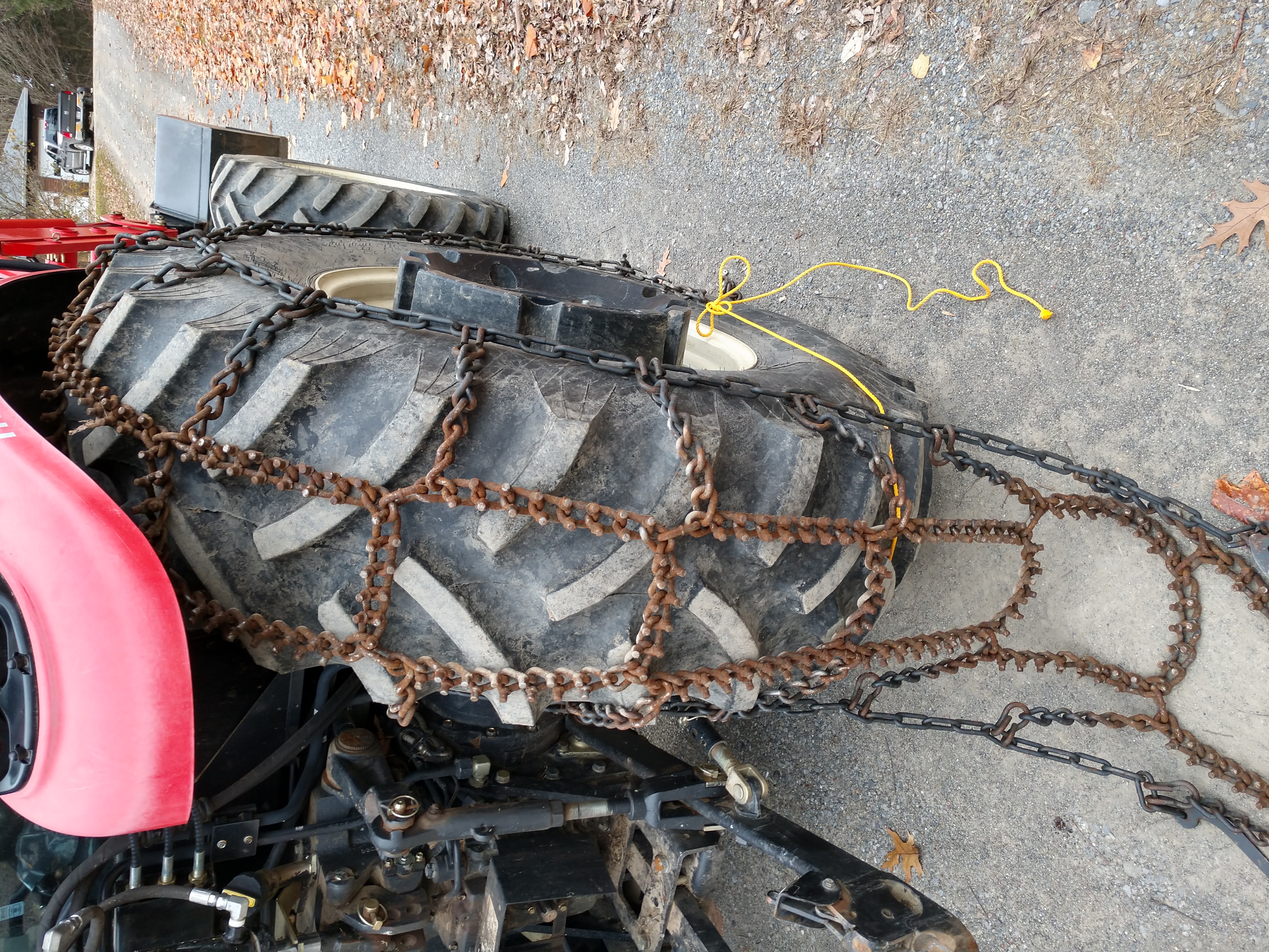

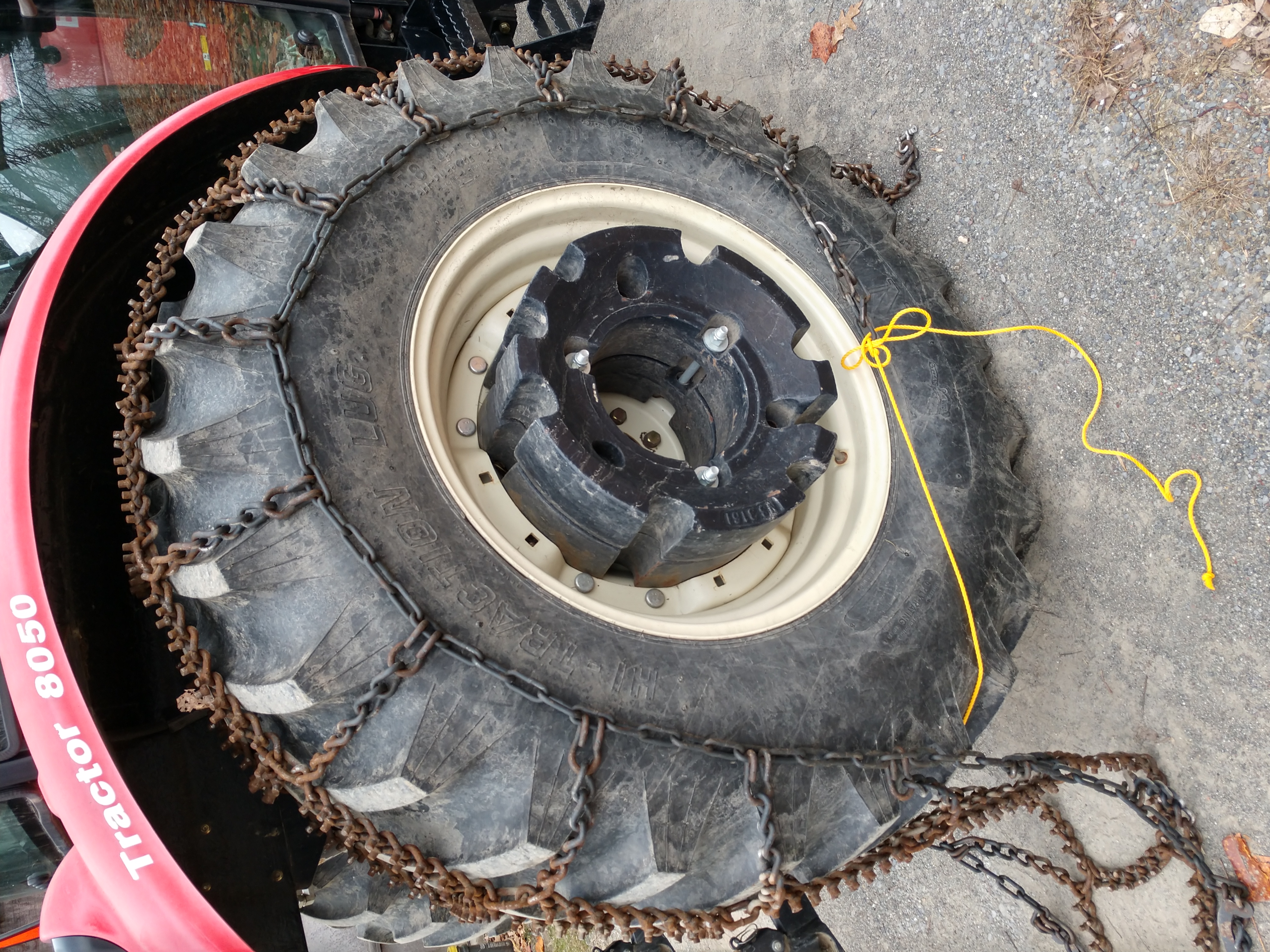

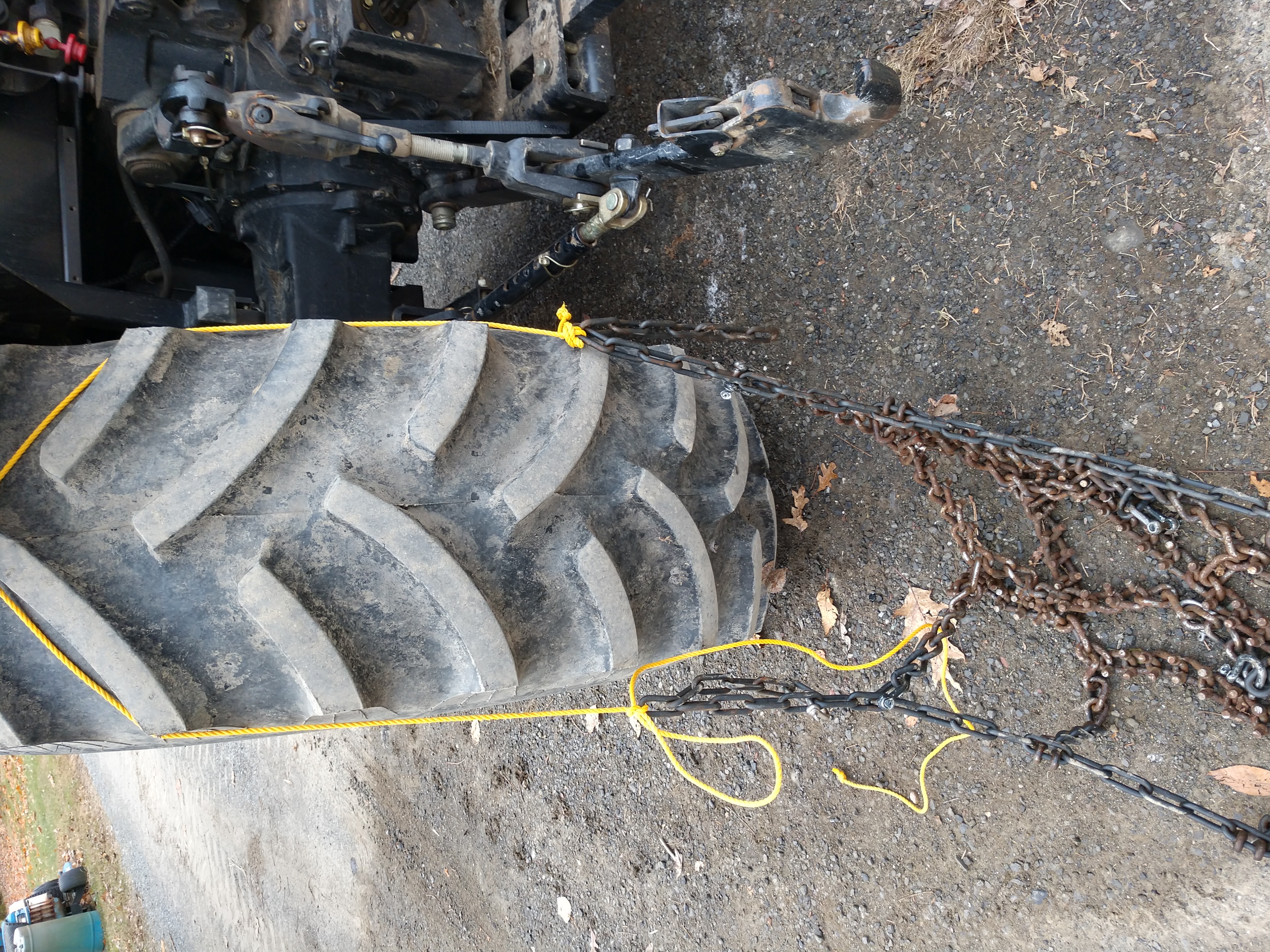

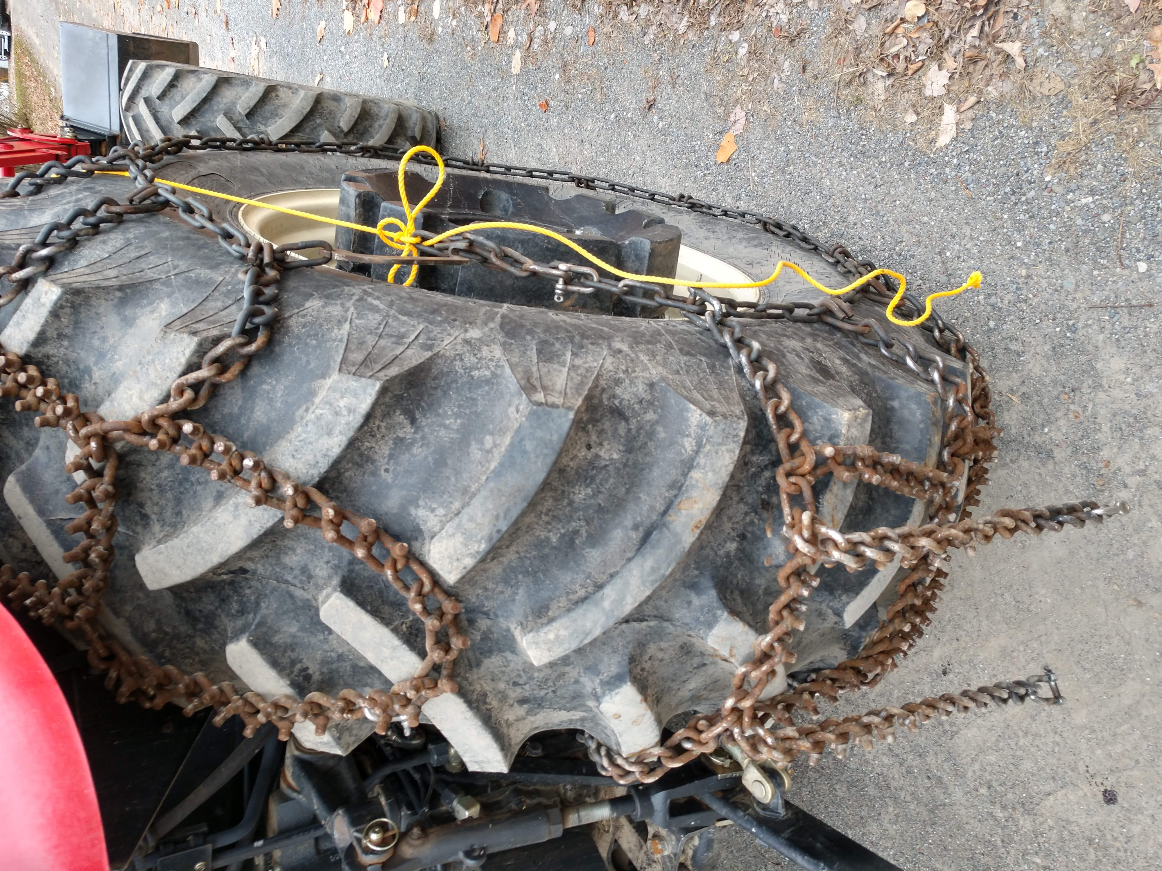

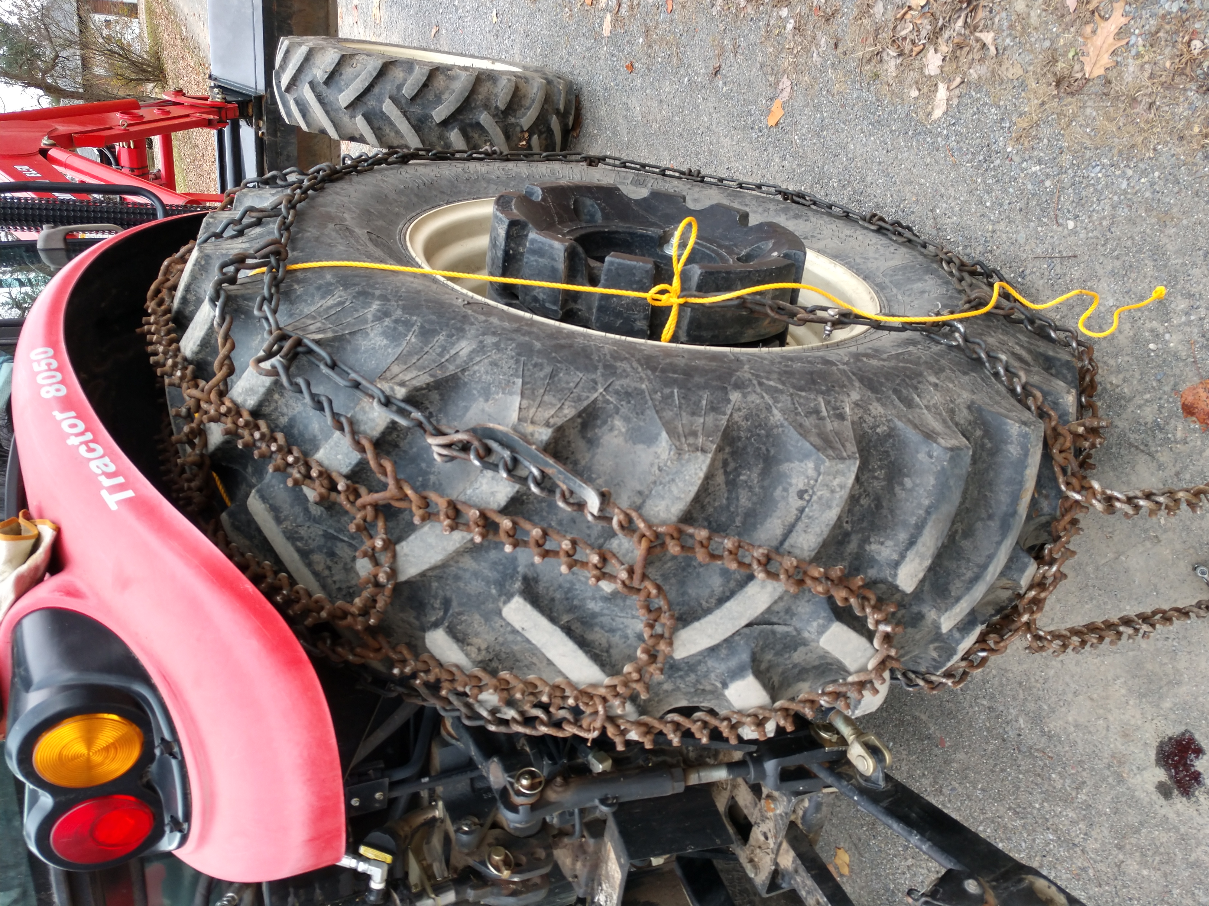

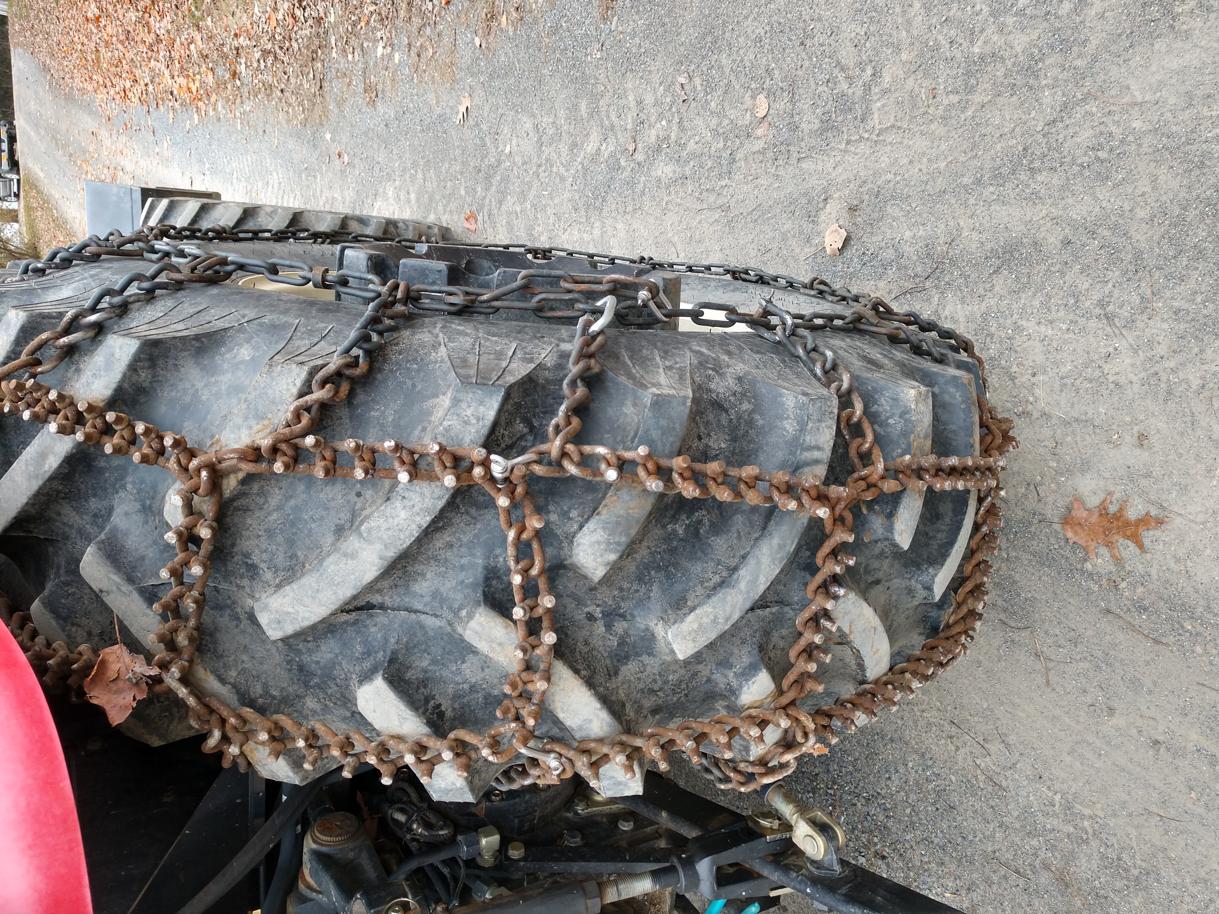

I put chains on one tractor yesterday, there are lots of ways to mount chains I thought I would share the easiest way I have found to do so.
1) lay the chains out with the outside, the ground contact side facing up
2) tie a short cord to the side chains, the length will depend on your tire size, on mine I end up with a V shape about 3 feet.
3) back up to your chain, take the cord and hang it on the tire treads.
4) drive forward slowly, stopping to spread the chain out on your tire.
5) continue doing this till you have rolled the chain up on the tire and have working room at the rear of the tire
6) your chain should be well centered on your tire and have very little slack.
7) fasten your chains.
8) step back and check out your work
View attachment 579186 View attachment 579187 View attachment 579188 View attachment 579189
View attachment 579190 View attachment 579191 View attachment 579192 View attachment 579193
View attachment 579193 View attachment 579194
This is the easiest way I have found to do chains, if you are doing this in a shop and can jack up a wheel it works good than also.
On the smaller tires I have jacked them up and chocked the other side to do this, then simply kneel down to do the fastening.
If you find that your rope V is to long when the chain is started up simply stop and leaving your other cord on run a new V and snug it up remove the old and continue. Using this method one person can install heavy chains on large tires. Without straining and hurting themselves. If you take your time after using this method a few times you will find that after your chains are laid out and untangled you can mount them in well under a half hour each with help spreading the chains accross your tire and telling you when to stop it's even easier and you are not fighting with the weight of the chains when fastening the side links.
The shorter the V that works for you the easier to line up and fasten the side links with all the slack taken up by the chains, no fuss no muss.
This is most certainly not the only way, but it is the easiest way I have found.
Lou

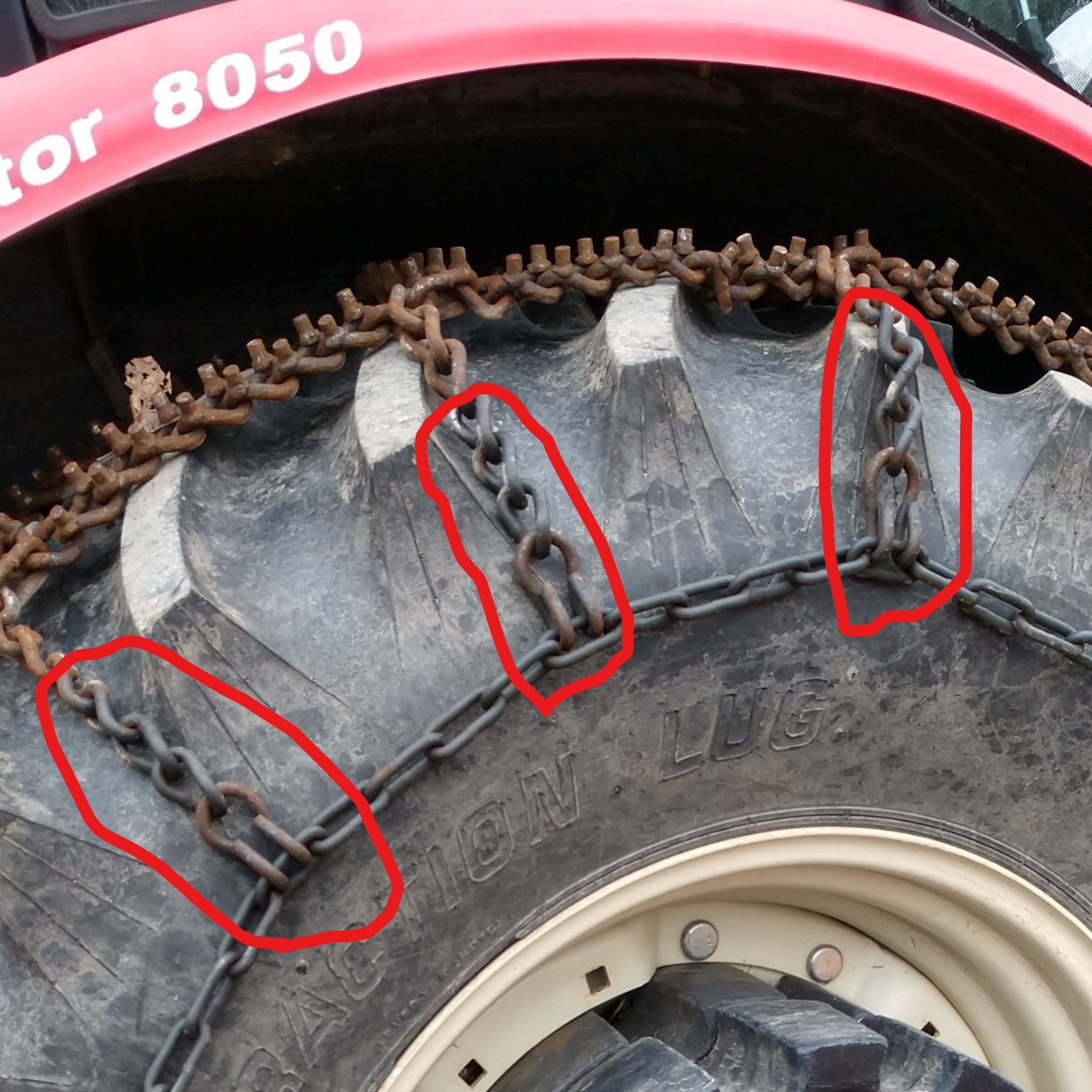

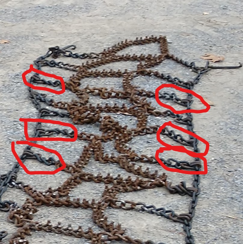

I got to thinking no need to get more pictures, just do some editing and marking up a couple of existing pictures;
If you enlarge these pictures you will see the links and hooks I am referring to circled in red, I only circled a few of course they all have to be done.
Over the years I have modified several chain sets for different tires,
when I needed to narrow a chain I will open up the hooks that hold the cross chain to the side chain,
then remove how ever many links I needed to equally on both sides inside and out and reinstall the hooks.
To widen a set of chains again I'd remove the hooks and add the required links to both sides and reinstall the hooks onto the side chains.
I do have a set of tire chain pliers which makes undo and reclosing the hooks much easier.
This would have had the effect of moving the side chains up and away from your steering knuckles.

I understand exactly: you're suggesting shorting the chain length/diameter that drapes on the sidewalls and I'm telling you that wouldn't do or help anything.
Think it through:
I showed a photo of the chains in the video. These chains place the forest links at the edge or nearly at the shoulder of the tire tread. Being too wide for the tire's tread alone requires narrowing the chains, let alone the excess drape where the inboard chain saws into the steering knuckle that at least twice in the video I showed the damage from my first attempted use.
Why won't your idea work? Draw a circle. Now draw a straight line between any two points on the diameter of that circle. Now ask yourself, if that line is closer to the center of the circle or further from the center of the circle than the original diameter of that circle? That's right, the line is closer. Now consider that if I have a chain that cannot clear the steering knuckle, do I want a smaller diameter or a bigger diameter circle? That's right, I want a bigger diameter circle so the chain can clear the steering knuckle.
So I have too wide of spacing for the studded links on the tire, and I need a bigger diameter circle on the drape in order to clear the steering knuckles, so what should I do? Seemed clear to me that I should narrow the chain. The directions for the chain came with directions explaining that narrowing or widening the chain may be required since the same part number chain "fits" multiple wheel sizes.
Notice how much better the center chain studs set on the tire tread once that chain is narrowed. Also, note the hardened hooks are not intended for opening up and closing but the clasps with the roll pins are intended for adjusting the chain.

Eric I have narrowed many chains that way shortening the cross chains raises the OD of the outer chains which would help to clear your knuckes,
you are correct in that it would not have narrowed the spacing of the traction chains on the tread.
Have a good day.
Lou
Lou,
I now see what you were suggesting. Fair enough. The provision on my style of Tallon chains is poping the roll pins on the clevis, not the way you're suggesting. My side hooks are closed and opening them would require grunting, hammering, and likely my acetylene torch to heat the hook links up so I could open them enough to move up the sides.
At any rate, your suggestion, if followed, would have solved the clearance issue that I detailed in my video, but not the poor fitment of my studded, traction chains that I admittedly glossed in my video, but was a concern to me. While it is obvious we missed each other's suggestions, it is all good because now somebody searching the internet down the road will see two different ways to try in order to narrow his or her tire chains if needs be.
