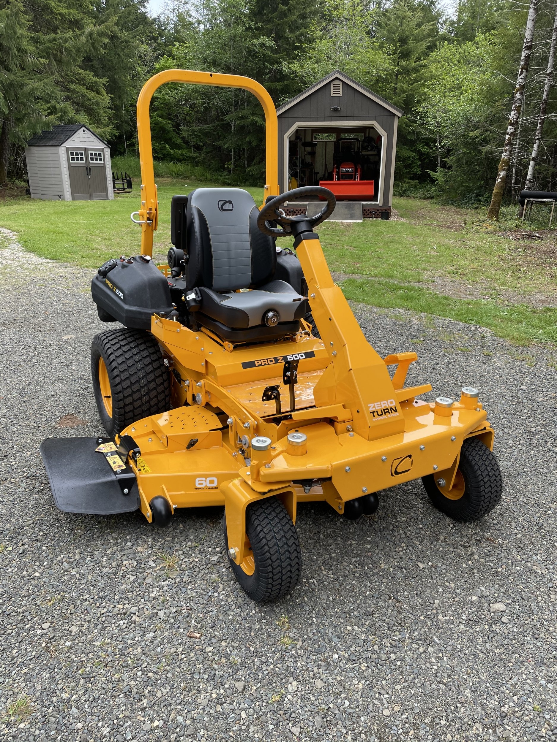

As an alternative to the more expensive commercial mowers on the market, I highly recommend the Cub Cadet Pro Z with 4 wheel steering.
I can safely and confidently mow 20-30 degrees hills and do so on a regular basis on my property.
Mike
Is that mowing up and down or across?
/ Mowing on slopes maximum angle before tip #42
Side mow, across.
My smaller back hill is over 30 degrees and I sometimes get a little slip from the rear tires but the mower never gets off direction.
This is with my commercial Pro Z model. They’re heavy. I don’t have any experience with the lighter residential units but, I’ve read good reviews about those too.
Mike

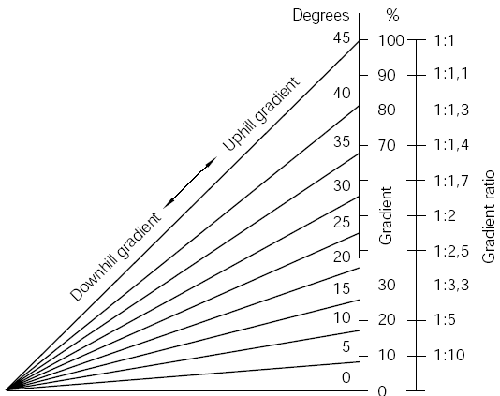

Sometimes 45 degrees doesn't compute in my brain. So I often refer to this method. It works for just about everyone, so try it if you haven't. Kinda fun. Just substitute your height for mine.
I'm 6' tall.
I face a wall and put my toes 6' from the wall.
I look straight ahead.
The point on the wall where my vision hits is about 45 degrees from the tip of my toes.
Think you can drive up that?
How about across that?
Heck, most folks can't even walk up that without using their hands in front of them.
That's steep. 🙃

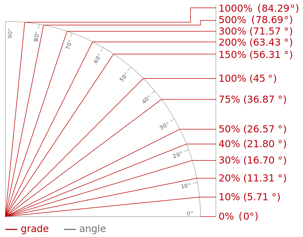

Ha! I think we were all able to make sense of what you meant though. This might be easier…

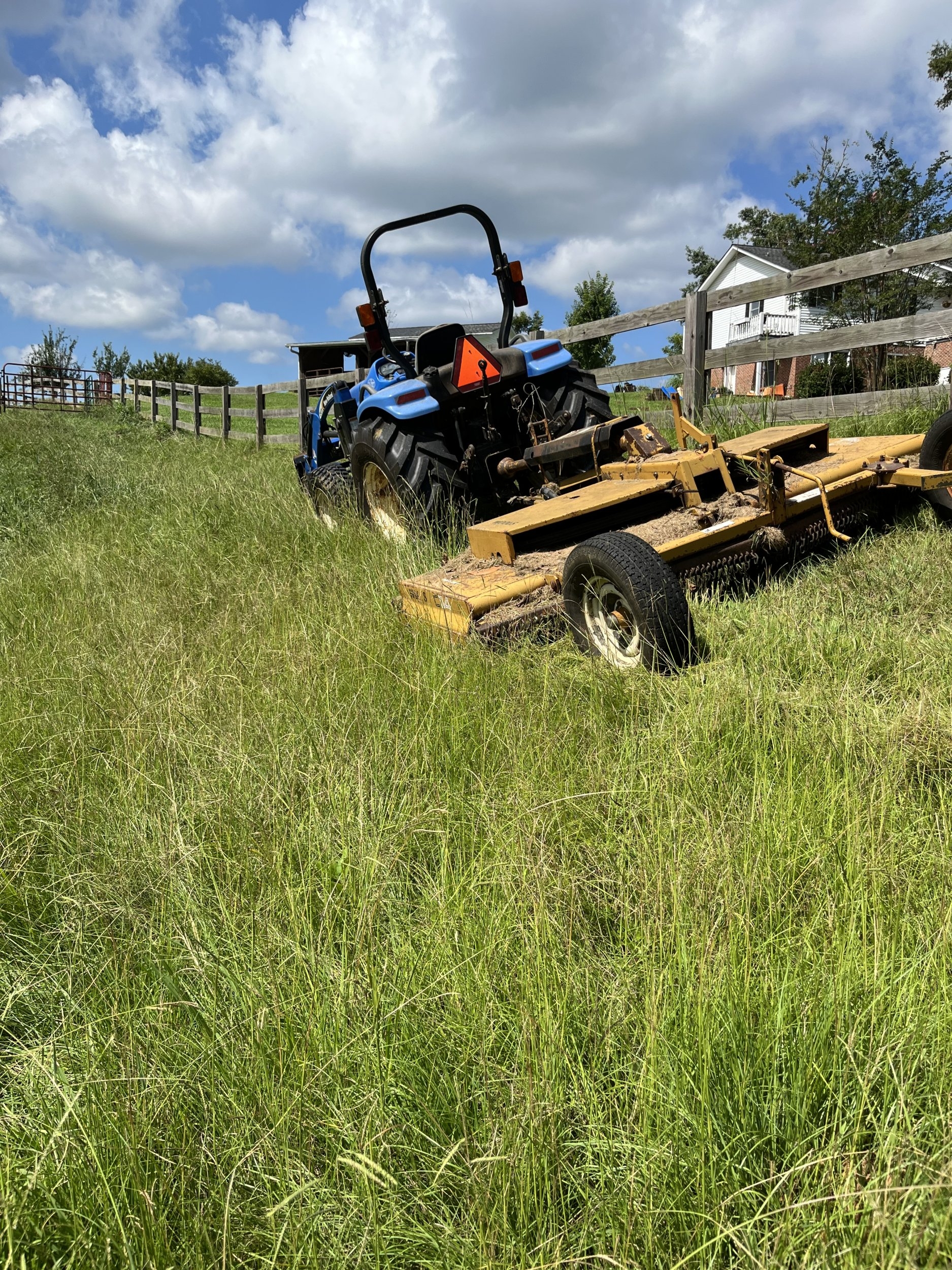

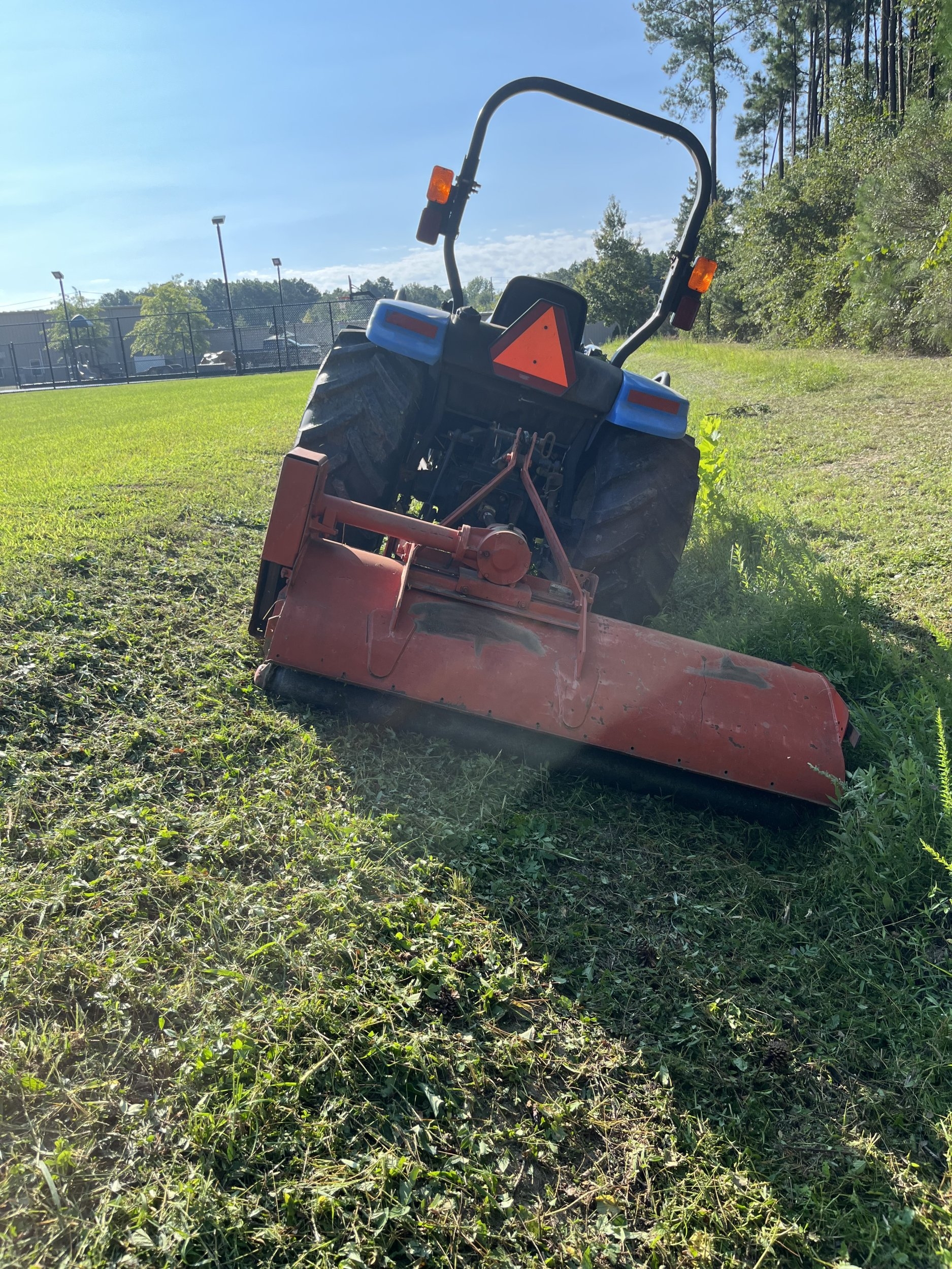

Here is a picture of my TC45DA pulling a Woods C114 on the back side of our pond dam a 20 to 24 degree slope and it feels steep.
I have mowed this since 2009 with no real issues using a IH 424 and this TC45DA with Ford 917 flail and this Woods C114.
I also mow the same slope around the pond in places.
Piles of fresh cut loose grass can make it slippery.
