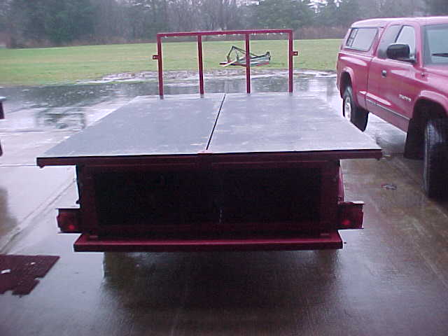

If you notice the last pic there is hinges near the top of the right side. This allows a person to slip that side from the lower hinge and put it back with those creating a table to the right of the trailer with it locked into the rails of the trailer with a stiffleg holding up the outside. Not noticable from the pics is there are tie downs on each of the cros members of both the lower sides and the top. I used chain link welded to the square tubing.
