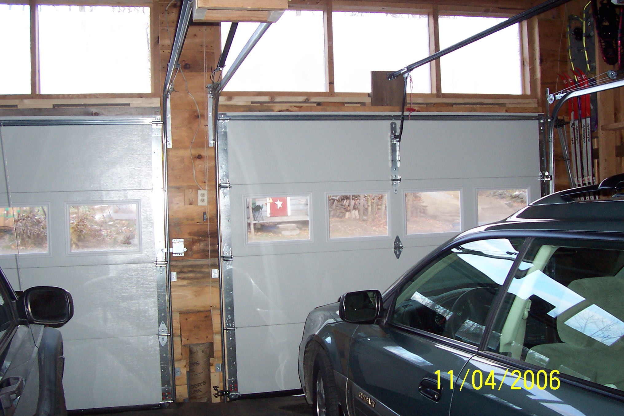

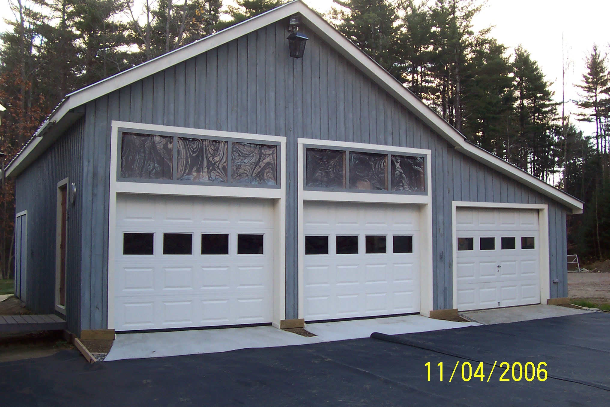

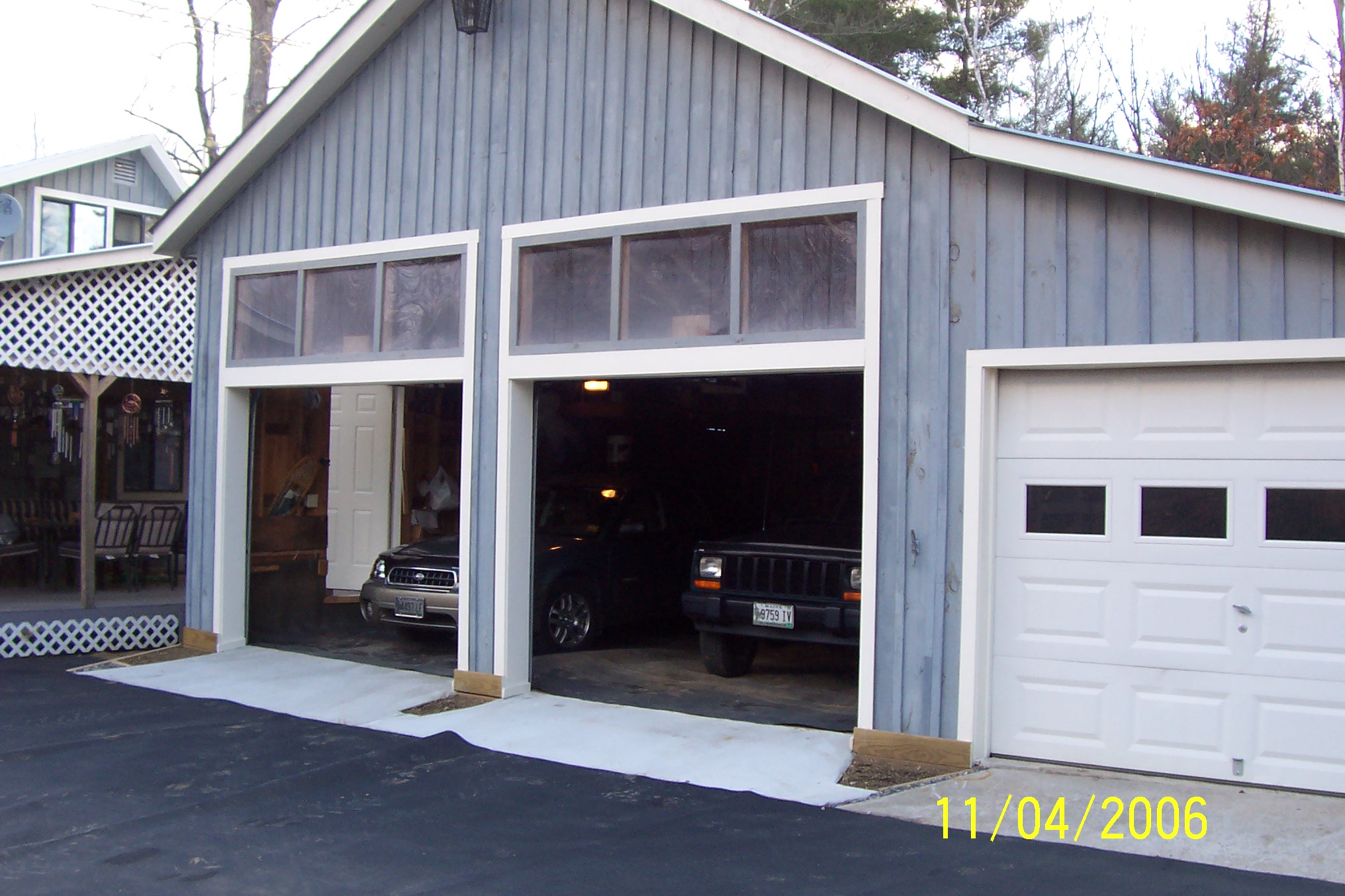

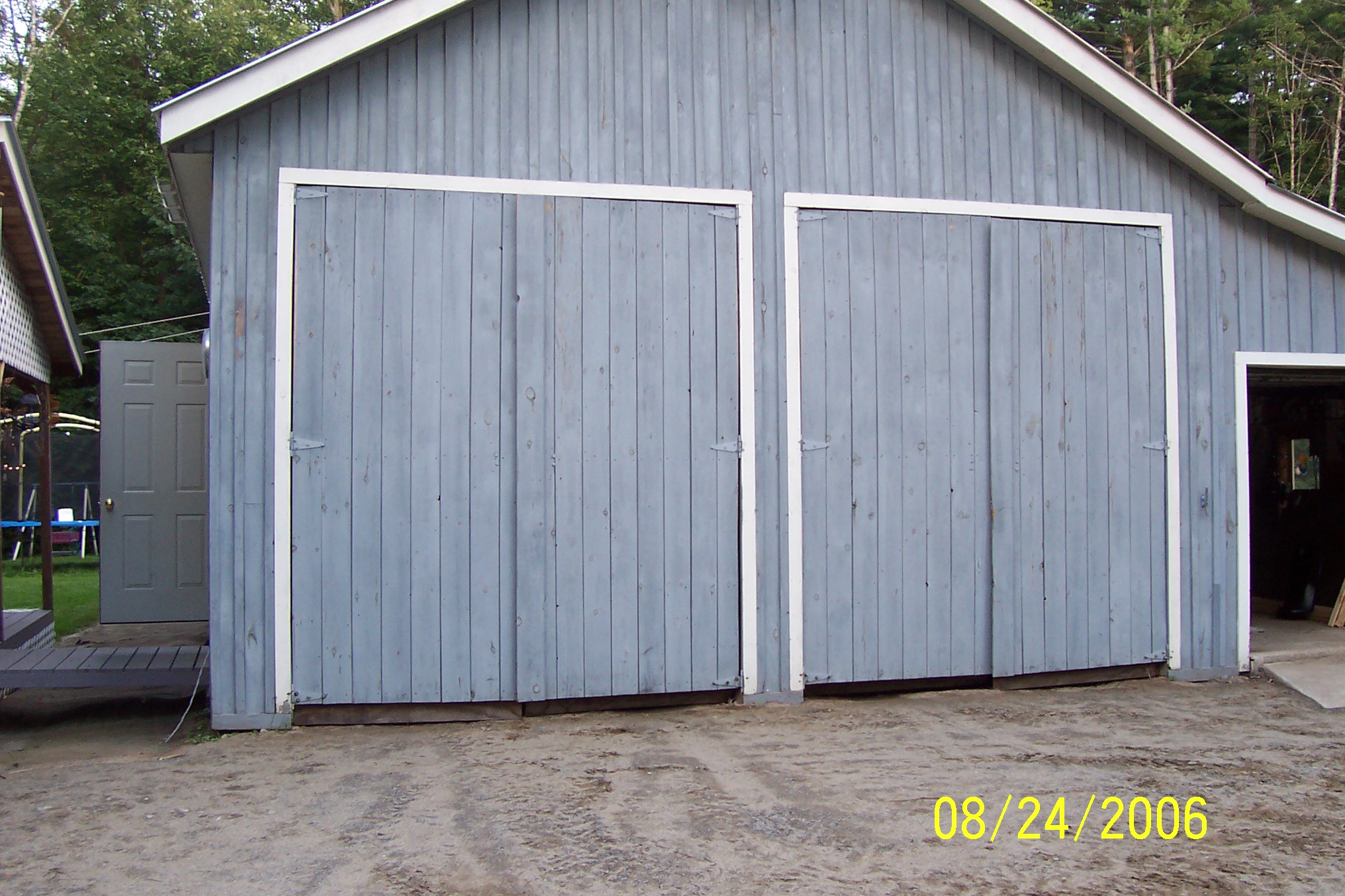

Ok, can't help kibitzing. A couple of things to consider:
1. Penetration points for power, drains (a sink is a god send), outdoor power, water faucet. I made one entry point in the floor (just a wood frame to block the concrete and backfilled with gravel when I got the water run). I wished I had done that around the pre-placed electrical conduit. Underground kept the metal from being penetrated.
2. Presuming this will be metal sided, there are preformed foam 'rubber' pieces for the ends of the panels (and the wll to roof joints). Make it a LOT tighter.
3. Cut floor crack joints. Same thing they do to concrete freeways. Is amazing in how much easier it is to use your shop floor when moving or setting up equipment. Or a creeper. You can pour the flat work later, allowing you to finish the penetration points and to set aside a bit more money.
4. Don't know what kind of doors you are using. Mine has side sliders (conventional barn doors). Other than the issue that the full height has to open, they are simple, and they are cheaper (a place money can be diverted from). No auto door openers though. And no overhead space issues (space the door opens to). I also agree on the door opening -- 9' is too small.
5. The easy directions to add space are to either just extend the roof out (in your case only the side without the doors) or to extend off of the end. Just a thought if you have any pretensions for the future.
6. For you wood shop, if you can think this in advance, it can be a real plus to have a small door that allows long timbers to stick out of your shop along the path your chop/radial saw and bench would be. Just a 2' x 2' or less door with the bottom at the same level as the work surface (even if it does not extend to the wall/opening). Amplifies your space with little impact to your work area by being able to leave the part not being used outside, but accessible from the inside.
7. No one will ever build the perfect shop -- just get closer to the mythical Nirvana. There's nothing like a Man's new shop -- Manland! Congrats!

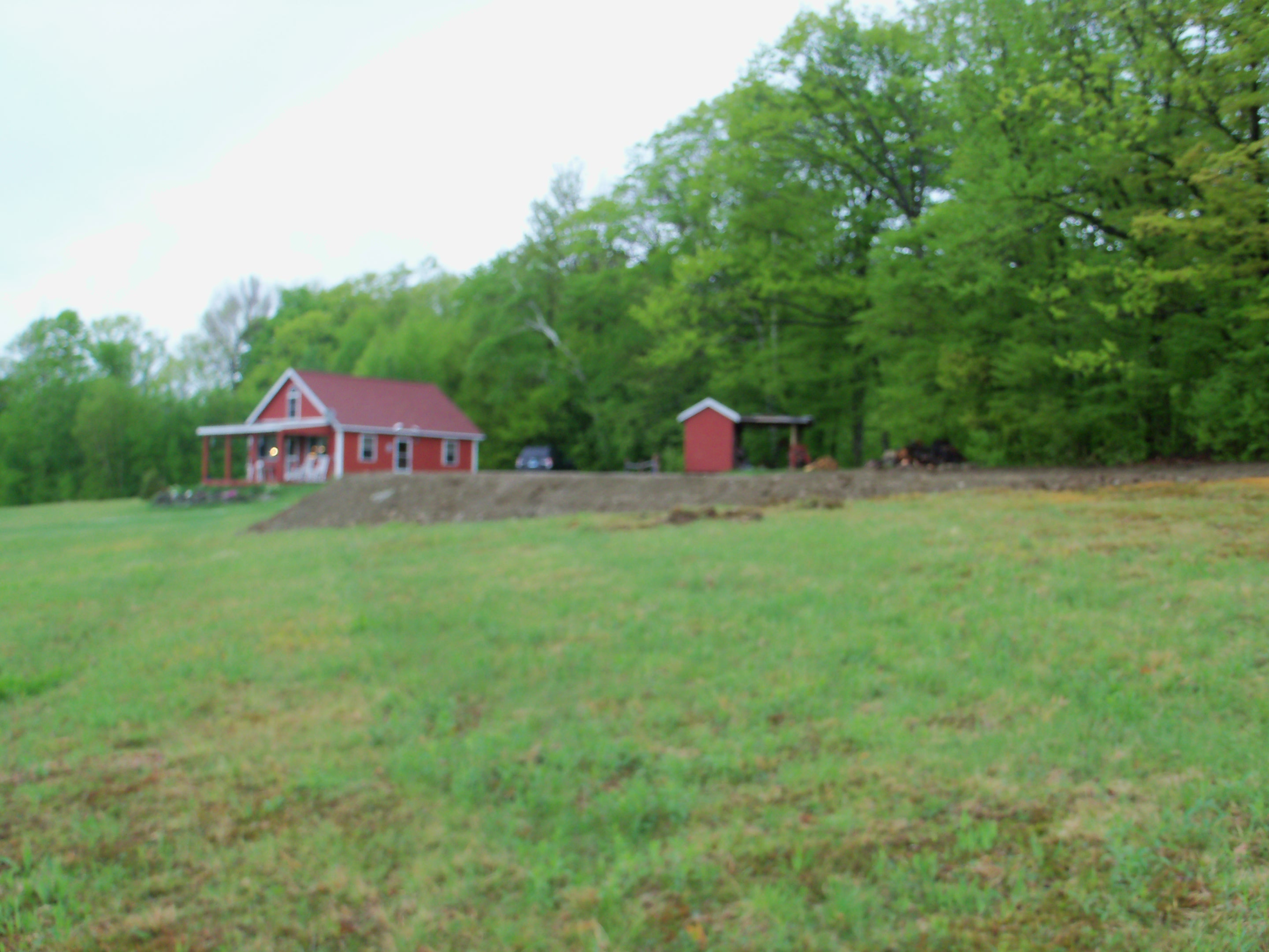

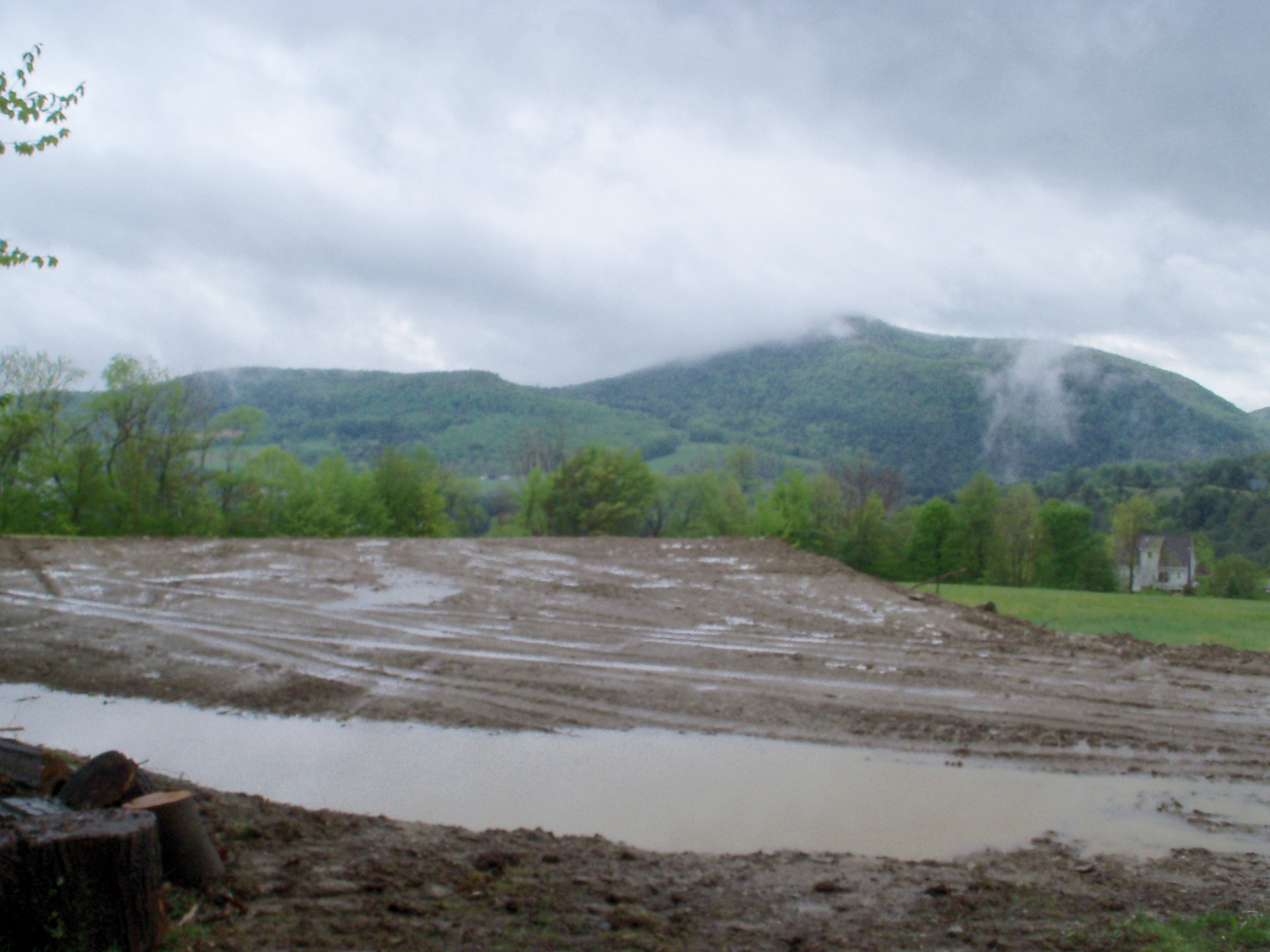

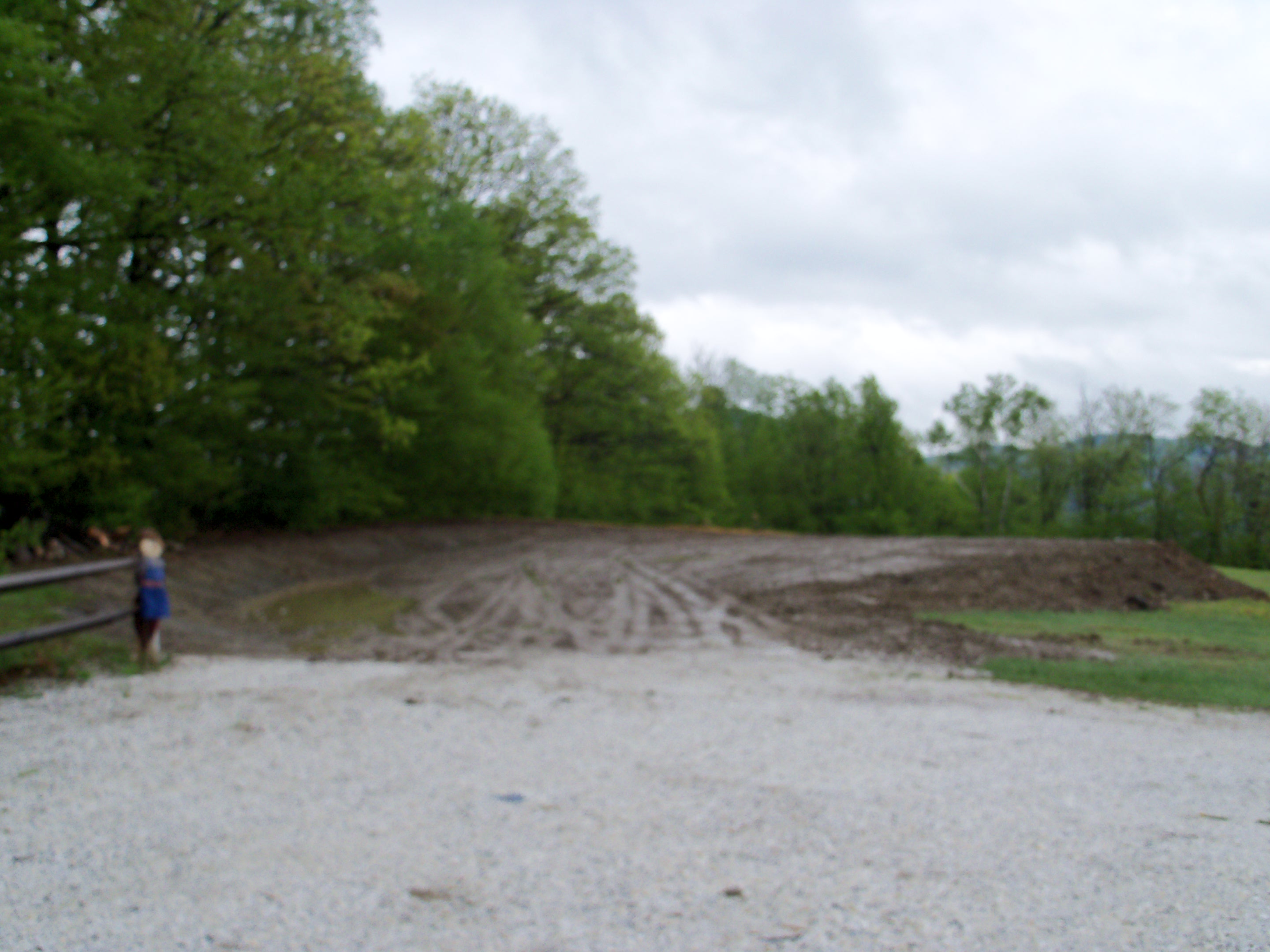

The tough dozer work is done, here are a couple of shots, sorry not so great ! :(
I will have two large truck loads of gravel brought in for the base and two loads of crushed shale for the bank that sticks out and for the ramp into the garage section...
We did make a small change, the drive through bay will be the second door over and thats where my floor drain will be...
I will have some dozer shots tommorrow... :)
The base will be vibratory compacted, hopefully things wont move too much after that ! :)
Also the bottom sill plate that contavts the concrete will be PT and J bolted to the concrete...
Gotta go and take Mom out will be back later...;)

Nice building pad Scotty. Is that dozed dirt settled/compacted enough to pour a slab on? I know you will compact the stone on top, but the dirt below needs to be solid too. Are you putting sill seal between the PT sill and slab?

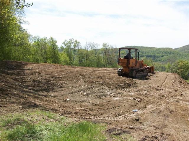

Nice location for your barn. Did you order up this great weather for building? :D
Dave.
Good Evenin Dave,
Yep the sill seal is supposed to be used, I will check with my contractor, since it gets a tad windy up there at times ! ;)
I don't know if Scott was spared but a little further north we had an inch of snow today.
Good Evenin Al,
We got some snow flakes but nothin that amounted to anything... But Sunday mornin the deck on my porch was mostly ice ! :D

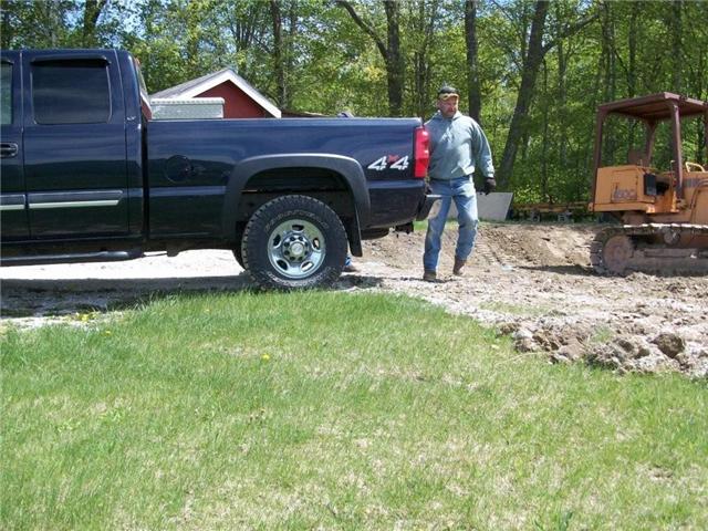

As promised a couple of dozer shots...
The dozer was driven over all of that dirt that was moved but it was only a JD 450 so not a great amount of weight,,,

Not sure if the dozer's weight is enough. Maybe someone has a better idea on it. You could run your vibratory plate compactor on the new pad soil before putting stone down, and compare what happens to running it on undisturbed dirt as a sort of test. You don't want to have settlement under your slab. Might depend on the soil type too, like if it is clay.

I'm about to start a garage also using an Alaska slab. I'm going to put down a layer of washed stone down first to promote drainage.
http://www.todaysplans.com/drawing-floating-slab2.pdf
My plan is to disturb as little of the ground as possible then put the stone on top of it. I have to dig down where it looks like you had to build up.

Scotty,
I did my own foundation for my barn.
I used 3 to 4" lifts of DG (decomposed granite) to build the foundation. After every lift, I wetted it down and drove the Kama tractor over every square inch. I did this until I got the desired height and width for the building pad. Then I used my boxblade to cut and level the pad. It came out so compacted that my contractor was laughing at me when I asked him if it was good enough. He had to use a hammer to pound in his layout feathers. So if that dozer did something similar, I'd think it should be plenty good.
