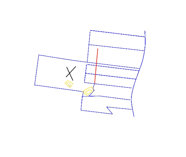

mojoinco- Thanks for the idea. This was a large chunk of land that was split up and sold. Mine was the largest tract. I am back behind everyone with my 1100' entrance. All of the other tracts are up on the road where they can just connect to electric easily. What I am trying to say is, there is no one close enough for me to benefit by doing this. I am at least hoping, that someone else may need to use my connection and I will get a little pay in the future.
markrahn- I got excited for a minute when I seen Wilson County. Then I saw TX :( I am in Wilson County, TN. I thought maybe I had some close numbers to work with. I like playing in the dirt too, I am not sure how much the county will let me do here with my septic tank, but I plan to find out. Thanks!
I have attached a rough idea of my plat. The black X is about where the house and garage will go. The red line is roughly how the creek runs.
   / My Property, Looking for info and comments. #16
I'd vote for the under ground.
Run high voltage back to the site and a pad mounted transformer back there.
Well and septic if possible.
Get a couple of quotes for the trench and include the septic tank / drain field contractor (he is allready on site and should be cheaper).
