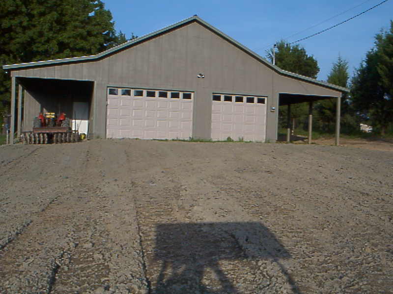

I will throw this idea to you also, I built my shop with a 30x30 main slab with 12 feet sheds on each side except on one side I put a 12 x 8 wide bathroom which I originally intended to put a shower,commode, sink and waterheater but later decided I only needed the sink and commode so it has plenty of room for additional storage areas. This shop I put in 100 amp service so it has plenty of power available that I could have set up a basic housing by adding a kitchen area in the 30 x 30. It is wired, fully insulated and sealed on the inside with 9'10" ceiling and water supply. It cost me $25,500 turnkey by my house contractor that later built my house. I thought that was a good price for the size building. Photo shows completed structure.
