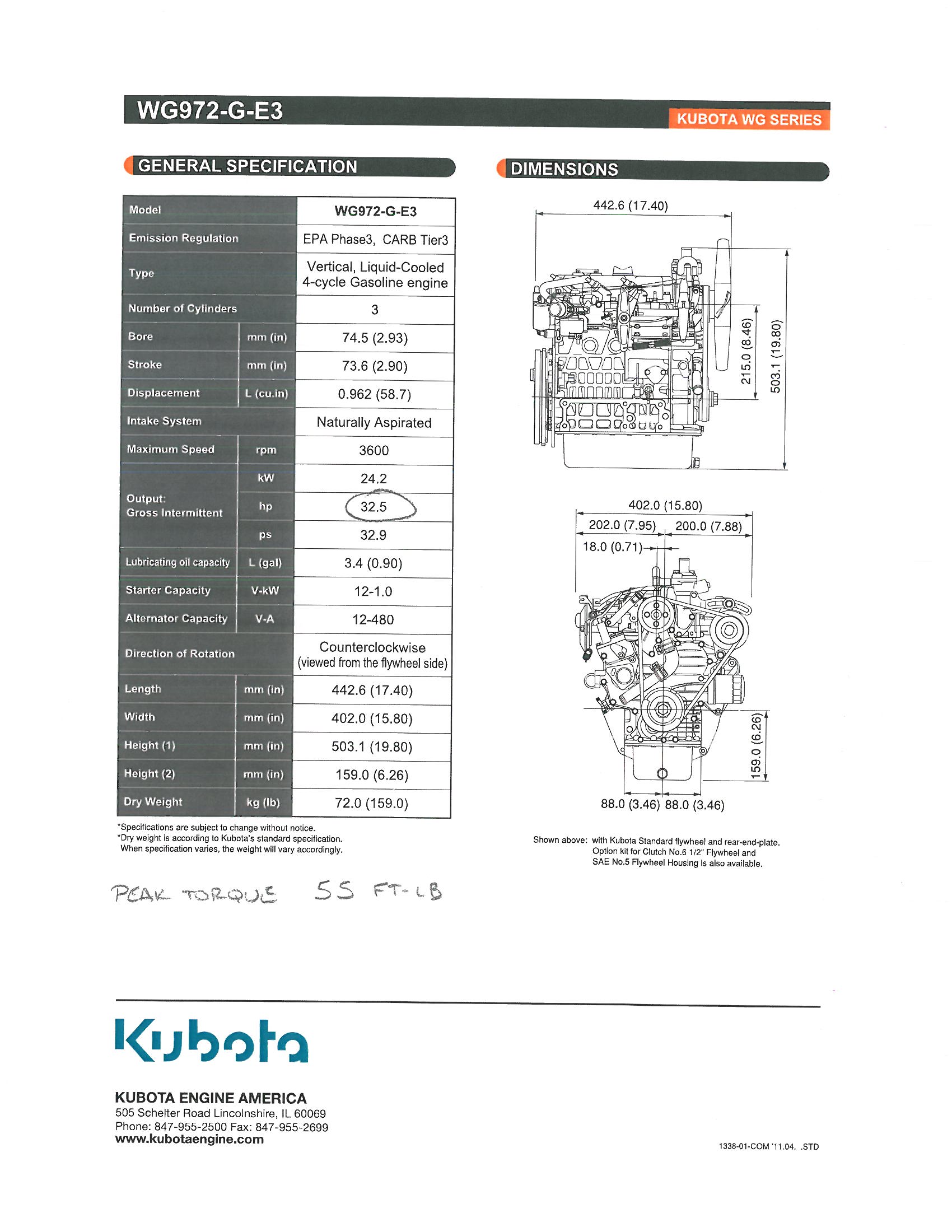

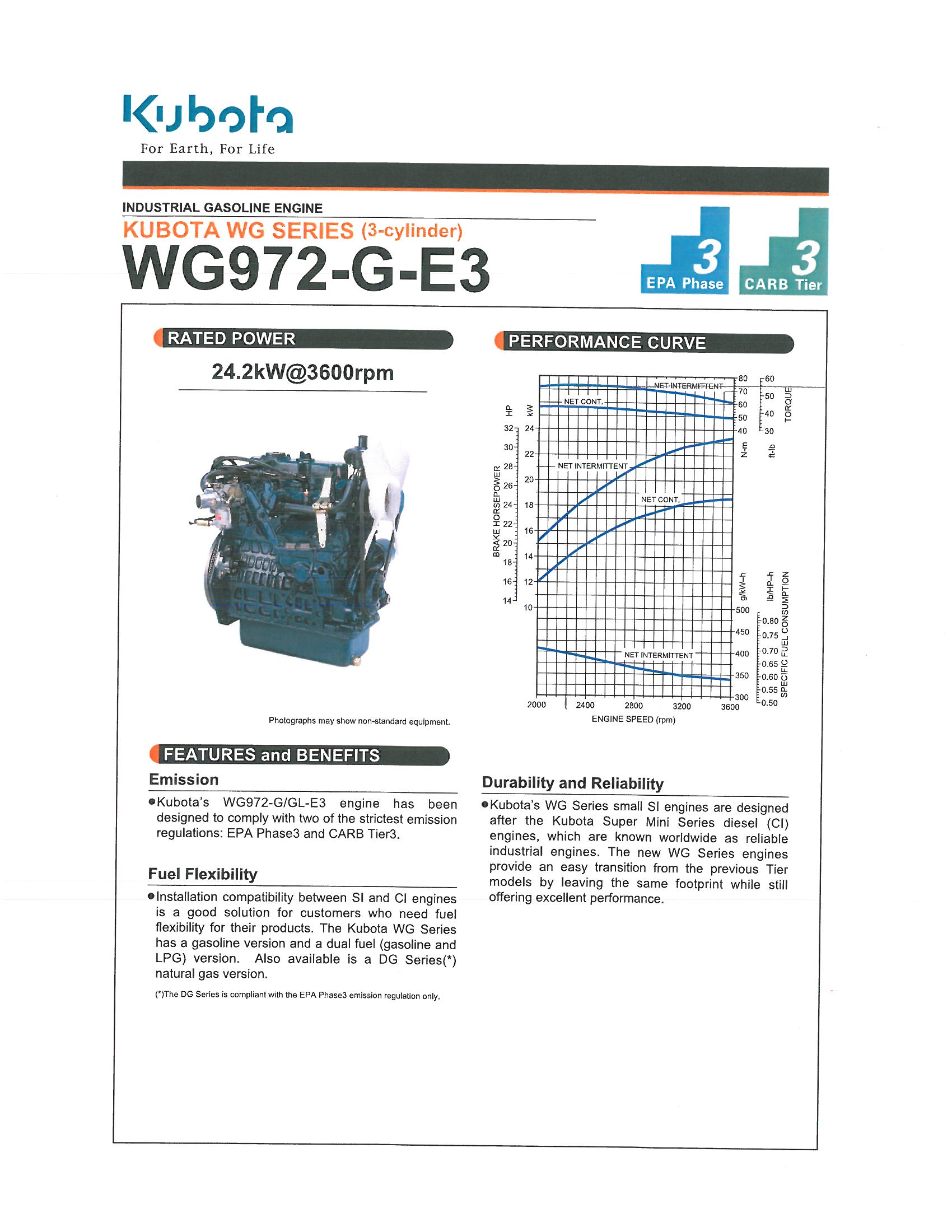

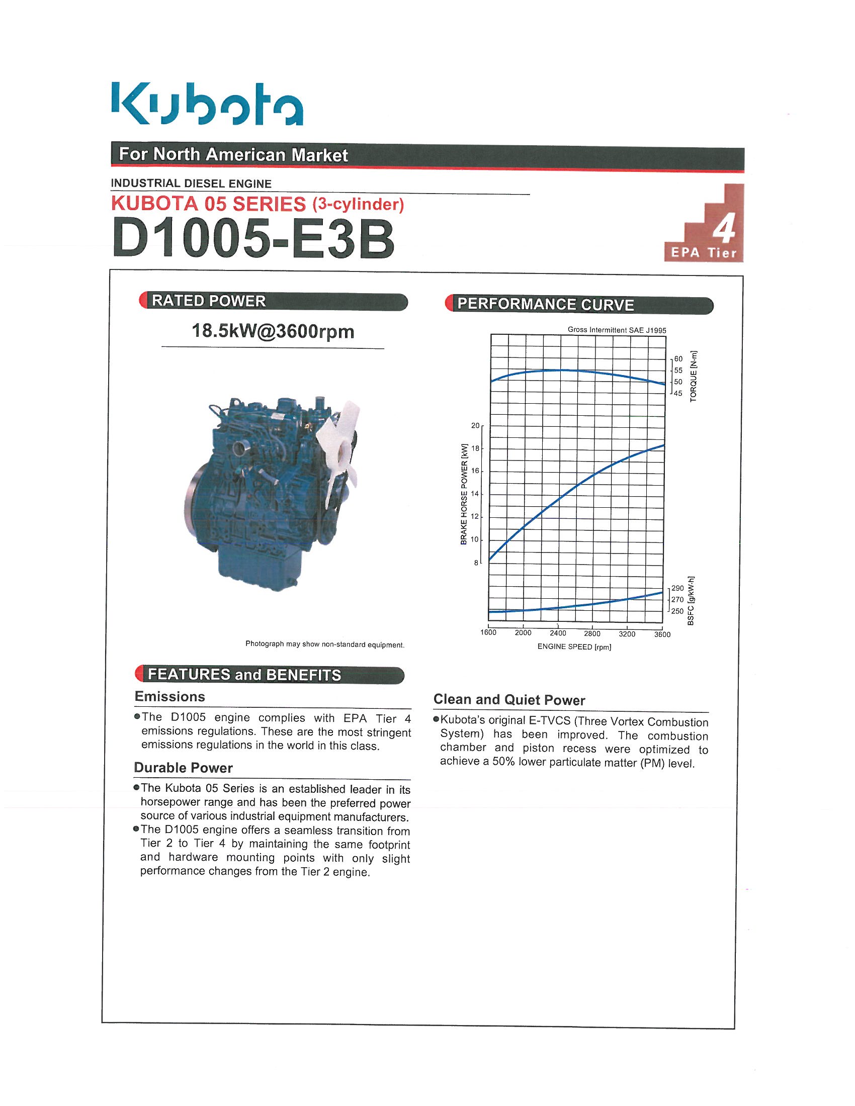

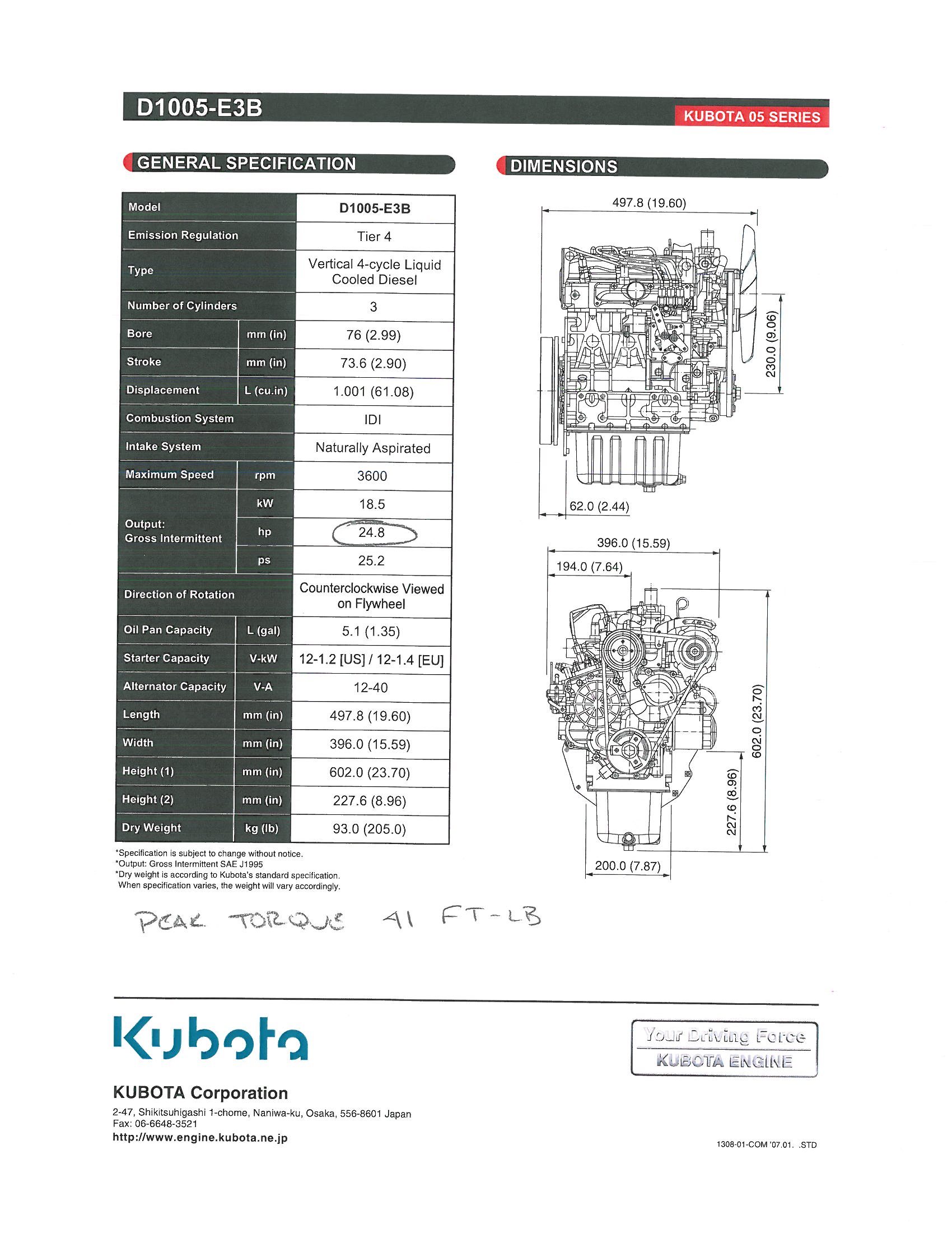

I only have some of the info you need, so you may not be able to explain the huge difference I see.
The gas mower is 21 hp B&S, I run it at full throttle (but no tach so I don't know the RPM). The mower deck is three blades, 42" cut.
The diesel is 23 hp (17 hp at the mid PTO which drives the mower, but I assume the engine hp is what's important.) I run it at about 3000 rpm. The mower deck is three blades, 54" cut.
The gas is 2hp smaller, but also cutting a full foot less grass each pass. The difference between the "power" of the two is night and day, from the day they've been new. I'm not exaggerating - there really is a huge difference. I'd always attributed that to diesel torque everyone talks about, but after reading your posts, that doesn't seem to be the case. Can the extra 2hp be making that much difference??
How big of a role does engine displacement play? I don't know the displacement of the two, but the B&S gas is only two cylinders, the Kubota diesel is three cylinders.
The 21hp B&S will have less hp at the pto, just like your other tractor. But as stated above, gasoline engine manufacturers really 'stretch' the ratings of their engines, so I doubt if it is a true 21hp. May just be the smell of diesel, it is intoxicating! Philip.
