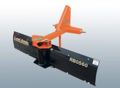

   / Need snow removal help #33
I just got a Kubota B3350 with
Front loader 60" bucket
72 Hydraulic snow blade with a 3rd function valve
72 rear blade.
The dealer was excellent and spent many hours teaching me in how to drive the tractor (I have zero experience/knoledge of tractors)
I need to clear the snow in a little less than a mile dirt road, in the mountains, with some areas of steep grade so I can get the suv to the road.
Q1 how should I orient the rear blade? with the convex part forward of backward
Q2 how should angle the rear and the front blade?
Q3 the front blade has a pin that allow the blade to be fix like dozer blade or to be floating, I set it up floating for snow correct?
Please any tips very appreciated, even the more obvious to all of you are new to me.

Again, once the ground is frozen, you will have no problem pulling snow with the back blade as you drive forward. You may loose some loose materials from the top, but nothing significant. I start with one run down the middle with front blade and back blade square, then down the right on either side with the blades angled to the right taking about 1/2 - 3/4 a blade on each

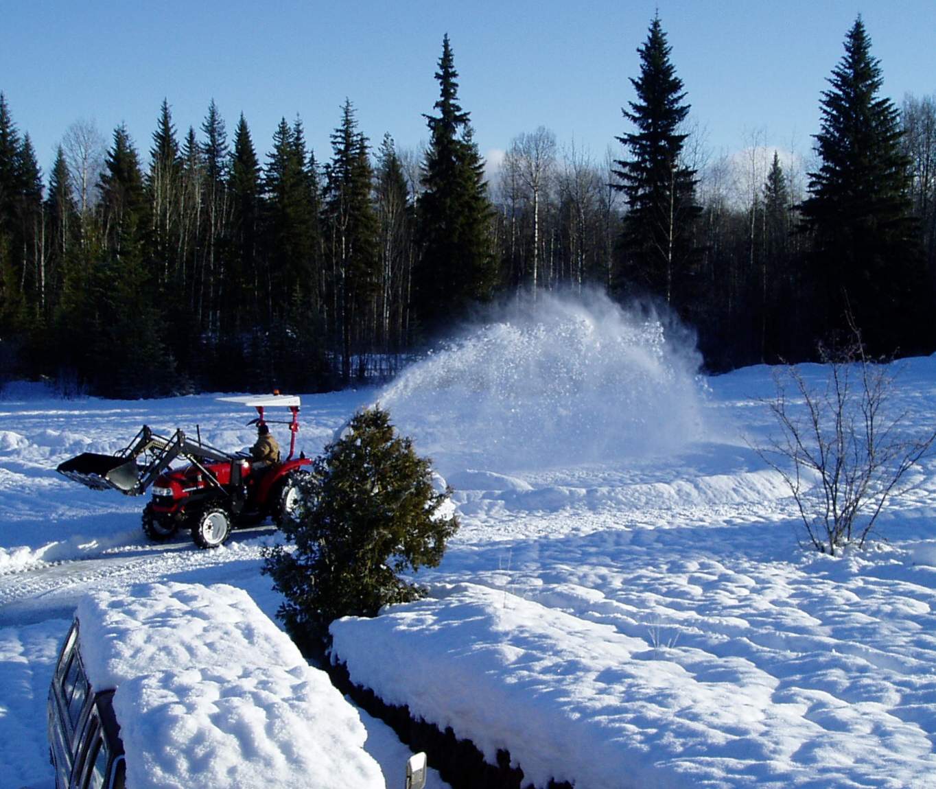

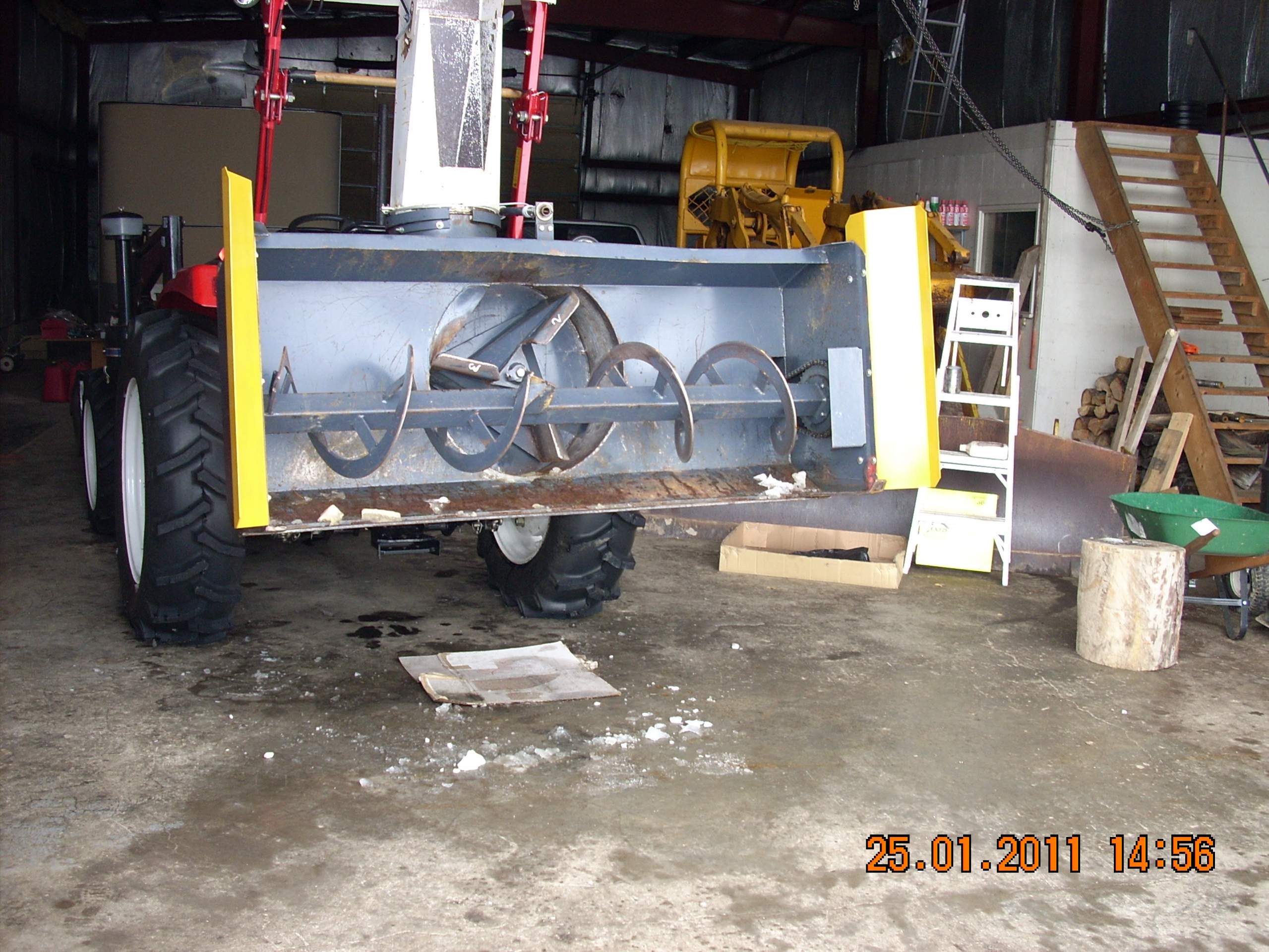

A little on my blower setup.
As others have said, the rear push blower is the most economical to buy and works well. That is what I use on my 1200 ft. plus 600 ft. driveway (two I clear) and I thought I would have problems going backwards. You soon get used to it and I find sitting sideways on the seat pretty much allows for reasonable operation. I don't find it a problem other than the fact that I have an open station tractor and end up covered in snow after each clearing and very cold.
For me my setup works just fine but I have a larger tractor at 55hp - anything smaller will find clearing a mile of driveway, very challenging.
I think it is worth mentioning that the pull type rear mounted blowers may not be that good if you have to go through snow drifts of 24" more. The tractor has to get through the drifts first before the blower can do it's job ! For me that would not be very practical and would test the tractor build/construction severely IMO.
A solution that might work for you would be the front mount blower (most expensive of the types) if you have the mid PTO to drive it. The rear blade would help as well of course.
The real beauty of the snow blower is the snow is blown off of the driveway into the bush and does not become a problem later on as the snow builds up. I also have a JD450 and find that the blower out performs the JD450. The blower is slower but does a better job. My equipment is old but it gets the job done. Have attached photo's of what I have to show you how it works. The blower works best with a minimum of 12" of snow or more - picture shows less than that hence the puny discharge plume which can reach 40' or more.
Hope this helps you with your situation.
Cheers

BTW my rear blade is very simple and it does not have a floating position like the front one.
When you drop your 3-pt hitch all the way, any implement on there will "float", since the hitch provides no actual downforce. It's just the weight of the implement that holds it down, so it will be able to ride/float over terrain just like a front bucket would if you push the loader lever forward past the detent into float position. Almost all ground-engaging implements get used in a float position, allowing gravity to keep them in contact with the ground. Same for a rear blade being used to plow snow.
I don't expect your front plow has a float mechanism other than what would be provided by the front loader arms if you push the lever forward into float. Most likely it's actually a "trip" mechanism to prevent damage if the plow hits something immovable. And it can probably be locked for cases where you want the plow to be rigid, like when plowing loose soil, etc.
