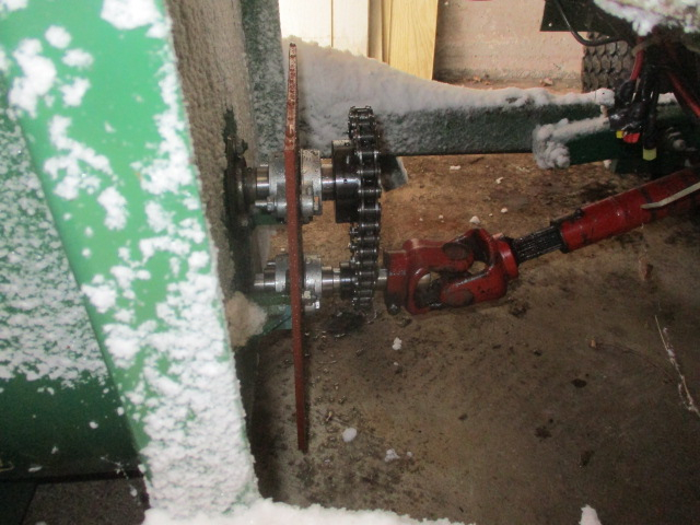

I run a blower commercially that was originally a 3pth unit which is now mounted to the front of the tractor. We use a #50 double chain as that was the only thing that would stand up - tried #60 and even #80 but until we went smaller with the double wide it wasn't reliable. My blower runs about 6-7hrs every time out and I usually get around 3yrs out of a chain

I mounted a rear mount 3ph blower onto the front of my tractor and in doing so I too had to reverse the pto direction. For 3 winters I tried the 3 sprocket and chain solution with a tensioner. The slack in the horizontal run of the chain could not be removed without bending something in the sprocket mounts or tensioning system. The slack also caused lash in the system and when the fan bounced back on forth within its lash it was at times quite violent (84" Farm King). I finally gave up a bought a PTO reverser gearbox and mounted it on my snow blower with the chain between the reverser and the input gear vertical. When I did this all my snow blowing troubles went away.

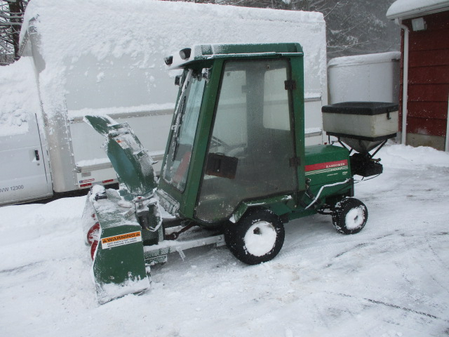

I'm the original poster here....I needed to reverse my input to get the blower fan to spin in the right direction....

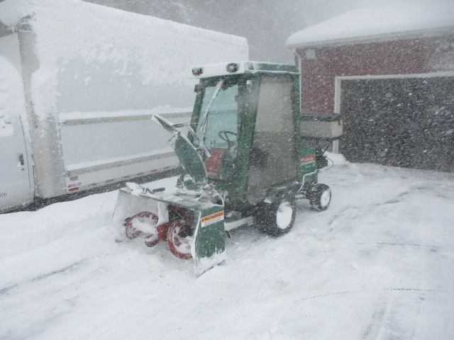

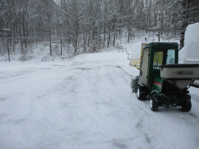

Well we got our first real snow last night a quick 12" Nor'easter......Everything held up well....chain stayed on the sprockets and no one was injured or killed....
At the end of the hour or so I oiled up the chain and I touched the bearings....everything nice and cool....was a good day !!
I want to thank everybody for their input !!
