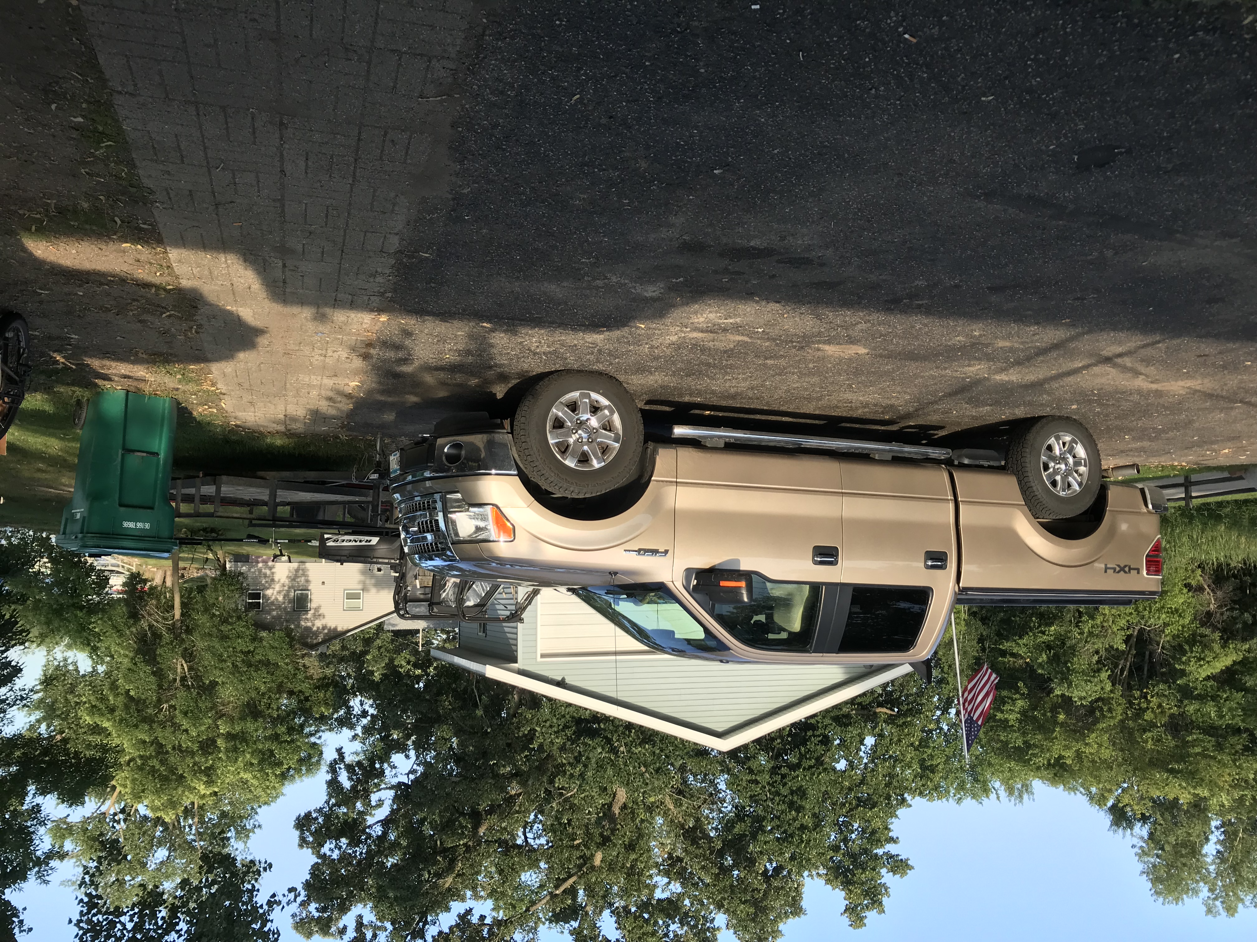

Seems to be the common response, but I also have a F150 5.0 and have had zero engine issues. Mine's a 2013 4x4 super crew with "longish" bed (6 1/2') and HD payload package (2100lbs) which includes the brake controller. This truck's been perfect for me. It's our go-to vehicle for everything... long trips, camping/hunting/fishing, general errands. It's hauled umpteen loads of firewood, crushed stone, mulch, lumber, etc.
